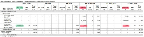

SM-2 BLK IIIAZ: The DDG 1000 Standard Missile Program of record plan is to procure SM-2 Blk IIIAZ modifications to support deployment of DDG 1000 Class Ships. This line item provides funds to procureSM-2 modification kits to support DDG 1000 Program. Funding includes modification kit installation in SM-2 Blk IIIA rounds. SM-2 Blk IIIA AEGIS missiles require hardware and software changes to becompatible with the new (non-AEGIS) DDG 1000 radar, combat system, X-band link and interrupted continuous wave illumination. The July 2013 R3B (Resources, Requirements Review Board) set the requirement at 40. The addition of 14 kits in FY21 and 25 kits in FY22 is required due to insufficient SM-2 rounds for ZUMWALT Class ships load-out to support full operational capability. SM-2 BLKIIIAZ funding includes rounds and support costs.
The FY2021 budget provides funding for an additional 14 kits and support in FY21 ($17.3M). This is required due to insufficient SM-2 rounds for ZUMWALT Class ships load-out to support fulloperational capability. SM-2 BLKIIIAZ funding includes rounds and support costs. Cost Element 2.1.1/2.1.8: FK830 Production Engineering/Support: Provides field activity and contract production support for missile modification and delivery to include production engineering, design andanalysis, quality and safety assurance, documentation, and production test support for SM-2 BLKIIIAZ and SM-2 BLKIIIC. SM-2 BLKIIIAZ funds support for unit production that initially ended in FY18 but restarted in FY21.
https://www.secnav.navy.mil/fmc/fmb/Documents/21pres/WPN_Book.pdf
so slowly...
what did they (PEO Ships) do for three years, it was not clear that only 40 missiles it is not enough?
FY17 cost 407,875 $ for 1 mod
FY21 cost 1,200,000 $ for 1 mod
:mad:

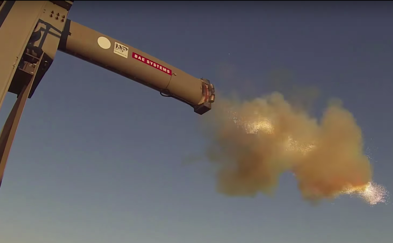

If you take the railgun currently at White Sands and simply bolted it onto a ship for demonstration and test, that would rate level 7.
The railgun development budget to date is likely to be a $billion or less (to get to TRL 6 in the desert). To get to a fully operational weapon deployed on ships could definitely take $billions but would be applicable to all future ships with the required electrical capacity.

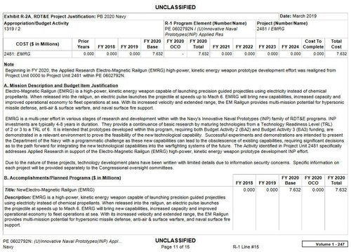

@fredymac "If you take the railgun currently at White Sands and simply bolted it onto a ship for demonstration and test, that would rate level 7"
That's contrary to what USN saying in their Justification Book for $7.6 billion EMRG per the RDT&E Navy March 2019, PE 0602792N Innovative Naval Prototypes (Navy definition of INP, do not develop hardware for service use, TRL 2/3 to TRL 6, typically take 4 to 8 years).

Attached Navy document and checkout my infoView attachment 630522
No mention of $7.6Billion cost to date for R&D. On the other hand, in searching around I have seen mention of total R&D expenditures to date of around 1$Billion or less which would be as expected given the amounts expended in any one year. Also, the wording says "INP investments are tpyically......" It goes on to describe "typical" INP program goals. The railgun is clearly TRL 6 just based on the definitions and INP does nothing to override that.
EDIT: Found your $7.6Billion. It is the bottom line of the chart. That number is $7.6Million for FY2020. Not billion.

@fredymac Thx for correction on railgun cost.
Quotes from CRS R44175 April 2, 2020, Navy Lasers, Railgun, and Gun-Launched Guided Projectile: Background and Issues for Congress - gives the impression that at moment railgun not a priority for the Navy and future problematical.
The Navy is continuing development work on ERGM, but it is unclear when production-model ERGMs will be installed on Navy ships. The Navy’s FY2021 budget submission requests $9.5 million in FY2021 for continued development of ERGM, but does not appear to program any additional development funding for ERGM in FY2022-FY2025.
Following tests with early Navy-built EMRG prototypes, the Navy funded the development of two industry-built EMRG prototype demonstrators, one by BAE Systems and the other by General Atomics (see Figure 12 and Figure 13). The two industry-built prototypes are designed to fire projectiles at energy levels of 20 to 32 megajoules, which is enough to propel a projectile 50 to 100 nautical miles. (Such ranges might refer to using the EMRG for NSFS missions. Intercepts of missiles and UAVs might take place at much shorter ranges.) The Navy began evaluating the two industry-built prototypes in 2012.
Classic USN. Spend a lot of money developing something ground-breaking then do nothing with it. (See Fasthawk, RATTLRS, VLS LRASM, etc. etc. etc.)
Throw in the FEL too. Got it working and had technical momentum but then just let it die. I suspect it has more to do with personal agendas among the DOD GS staff working in the various research branches than with actual technical merit and military utility.
