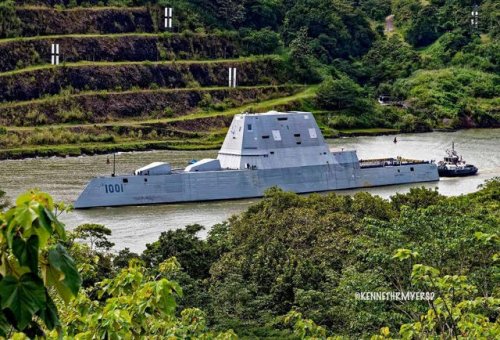

A great picture of MICHAEL MONSOOR transiting the Panama Canal enroute the Pacific Ocean and San Diego.
Courtesy of Tom Welch - http://www.monsoorcommissioning.org/monsoor-transits-panama-canal/

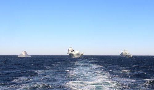

Zumwalt-class guided-missile destroyer Pre-Commissioning Unit (PCU) Michael Monsoor (DDG 1001), British aircraft carrier HMS Queen Elizabeth (R08), and Tide-class replenishment tanker Royal Fleet Auxiliary (RFA) Tidespring (A136) conduct a photo exercise, Nov. 11.
