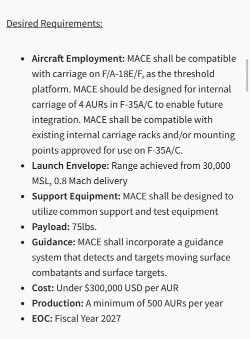

By procurement do they mean that HACM will enter Low rate initial production?
(Sry for going off on a tangent)...I'm still puzzled how guidance works on a hypersonic missile? Not only the nose shape on scramjet missiles, but the problem of plasma. USN wants anti ship scramjet missile. Which means targeting moving ships. Don't they have to slow down to below mach 5 in terminal phase of the attack?
Yes, that is scheduled for 27
2027 or Fy2727 what?
