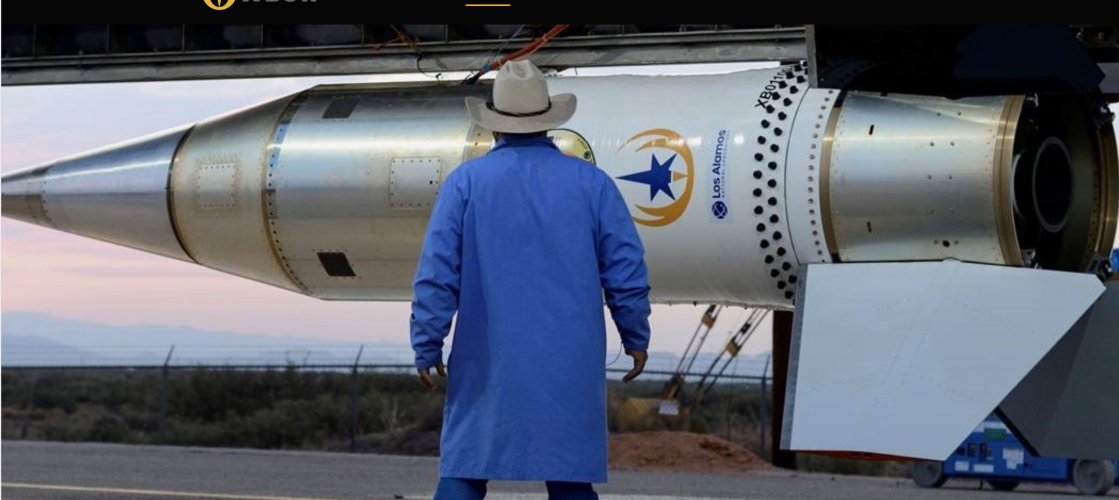

Eagerly anticipating X-Bow Systems next test. If they are specifically talking about larger diameter they’re only 12” away from Midgetman’s 46” diameter.
Could make a nice IRBM for hypersonic strike.
They are already at CPS/Dark Eagle size with this motor. I don't think an even larger (Polaris-sized, probably) IRBM makes much sense for the Pacific given the lack of land area for dispersal. Ranges from southwest Alaska to northern China will be in ICBM class at 5,500 - 6,500 km, and those flight paths will overfly Russia without aggressive doglegs. Northern Australia could be a good dispersal area, with ranges of roughly 4,500 km to southern China, but then you are gambling the utility of an entire weapon system (one that could easily be used for nuclear weapons) on Australian politics. CPS already gets you from Guam to Nanchang.

No idea. It looks like they just slapped on the minimum amount of structure required to fly the motor but I don't know why they'd do that. South Korea did it with a big solid booster but I've not heard of other companies in the US doing that.
