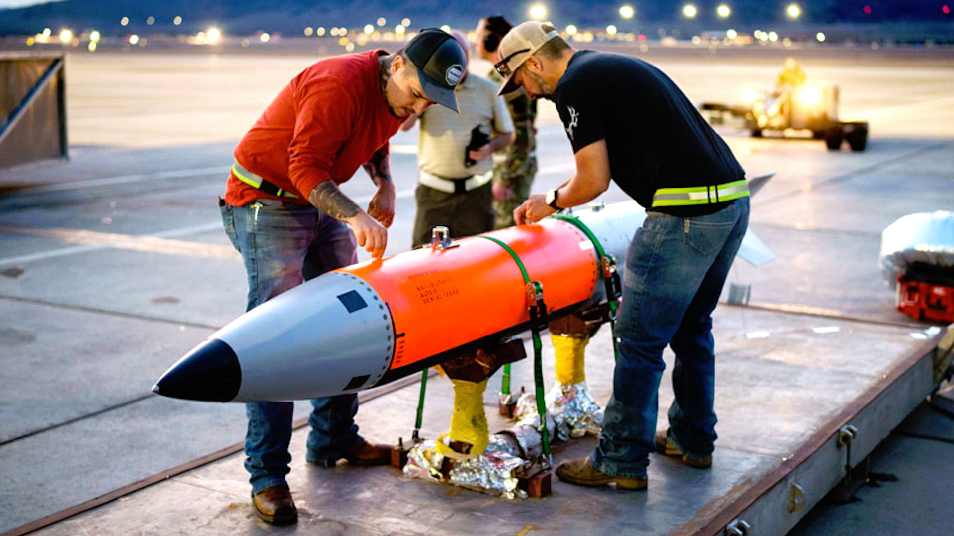

I wonder how much of the conversion work creating the B61-12 involved rebuilding its' physics package?
Given the cost of the materials in the physics package, probably quite a bit. Tritium is only marginally less expensive than diamond per gram and the fission fuel, while an order of magnitude less, is still more expensive than gold by two orders of magnitude.
https://brightside.me/articles/the-17-most-expensive-materials-in-the-world-188955/
My understanding of the B61-12 was that they were taking old physics packages and installing them into new airframes/shapes that had attachment points for the JDAM tail kit (or an equivalent to the JDAM tailkit built in, the descriptions are not clear on that point).
This doesn't mean that the old physics packages didn't need any refurbishment, however.
The issue is upgrading from 50kt (in the -12) to 360kt in the -13.
That is the difference between using a mod 4 tactical warhead vs a mod 7 strategic warhead as your starting point. Both will be heavily refurbished as part of the process, but the yields are related to the parent physics package.
...which depends on very expensive materials.
