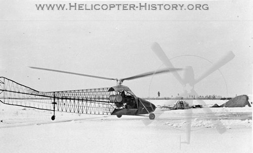

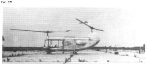

Hi Wurger,

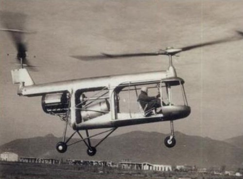

The PD-2, PD-3 and PD-4 helicopters were built by (for) Piaggio. The PD-2 was tested during the closing stages of WW2. The PD-3 was an improved PD-2 of 1949/1950 (still try to figure our what the improvements were) and the PD-4 tandem rotor heli flew in 1952.
The single rotor type is, according to the caption, the PD-3 although I have my doubts. The other one is the PD-4 for sure
Rgards, Walter

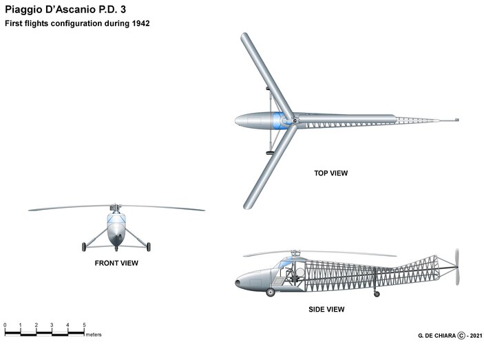

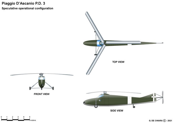

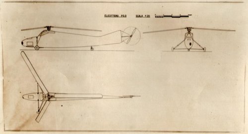

Hi guys, only my third post here at your wonderful Forum.

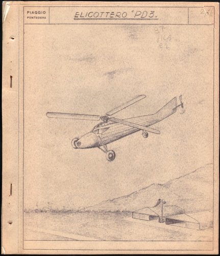

User boxkite, whom I know from the German Flugzeugforum has convinced me, to show you a document about the Piaggio PD.3 that I found recently.
Though it is in Italian, I thought it would be interesting to this board.
I have edited the pictures a bit for a better reading.
Enjoy.
Source of the document is this site

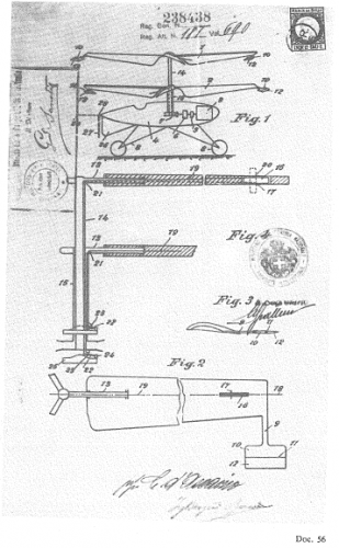

here is a patent for D'Ascanio in 1930.
L'invenzione-dell'elicottero

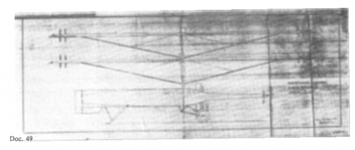

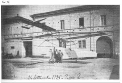

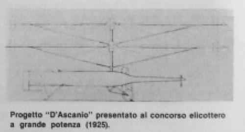

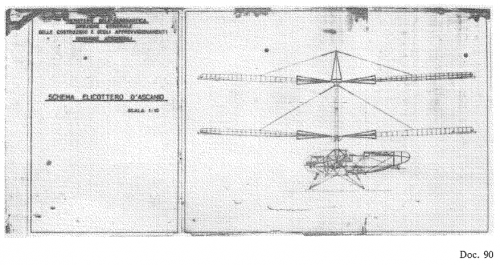

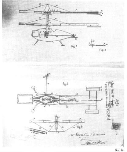

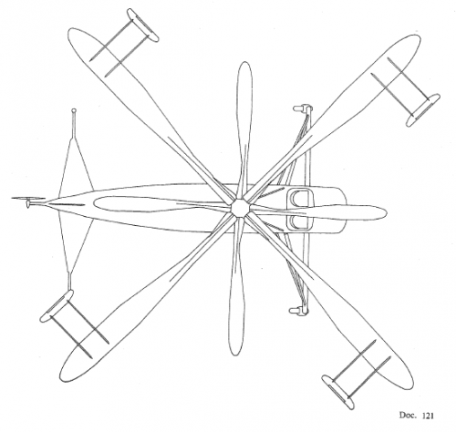

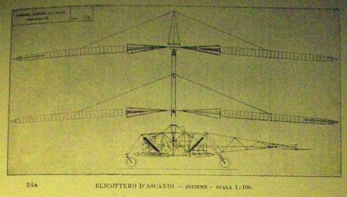

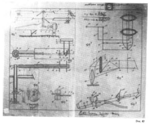

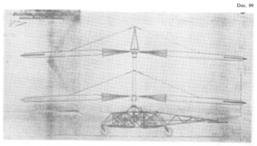

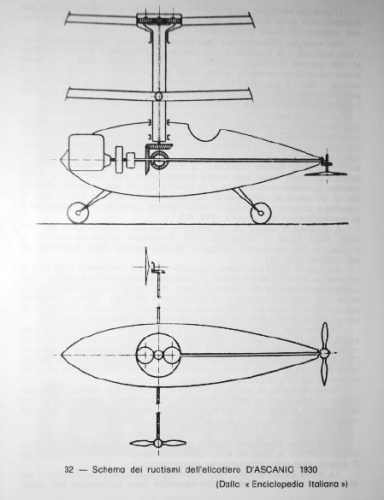

here is some of D'Ascanio helicopters and patents,some of them were a Projects only.
49- great powered helicopter of 1925
56- patent for a helicopter with two coaxial rotors of 1925
63- patent for a helicopter of 1926
66- D'Ascanio A.T.2 helicopter of 1926
86- patent for a helicopter of 1929
90- D'Ascanio A.T.3 helicopter of 1928
99- D'Ascanio development of A.T.3 helicopter of 1930
121- D'Ascanio helicopter Type of 1931

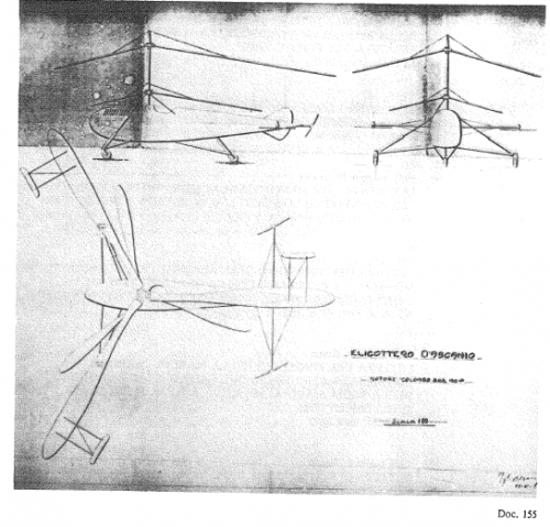

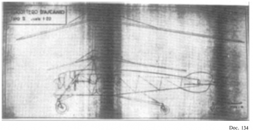

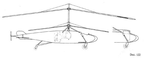

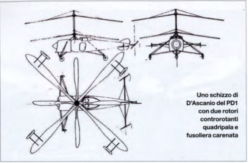

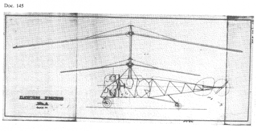

122- D'Ascanio Type-1931 in side view with addition enclosed cabin version
134- D'Ascanio Type-II of 1932 helicopter
145 D'Ascanio Type-III of 1934 helicopter

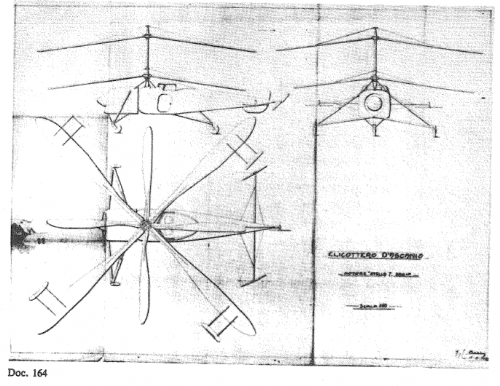

155- D'Ascanio 1934 helicopter,powered by one 130 hp Colombo engine
164- D'Ascanio 1934 helicopter (anther one),powered by one 390 hp Stella engine

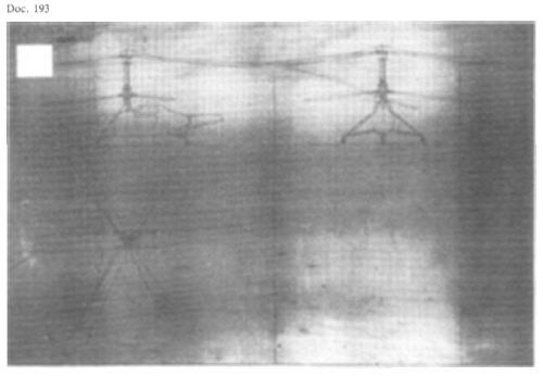

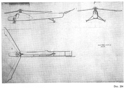

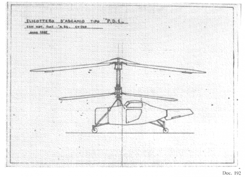

192- PD.1
193- PD.2
204- PD.3

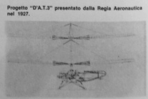

here is again a drawings to 1925 Project,and D'A.T.3,and that make us asking if there
was D'A.T.1 ?.
http://www.avia-it.com/act/biblioteca/libri/PDF_Libri_By_AVIA/Marinai-in-volo.pdf

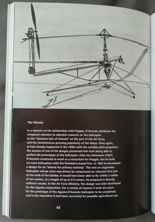

Hello All,
The attached image might help to cast some light onto the matter. It's from the book "Flying Machines of Corradino D'Ascanio" by Alberto Bassi (ISBN 978-8843573042).
As per the text, this particular helicopter design was a post-retirement project for Corradino D'Ascanio. It's referred to as an "eliante for primary training", though I'm not sure what "eliante" actually means. (Google Translate failed me.) The design - at least at the point at which the photograph was taken - has that it's a small, tethered, helicopter, powered by compressed air which presumably would have been fed to it via the tether. D'Ascanio retired in 1961, and the last sentence of the text mentions that it "took ten years for the prototype ... to be completed" and during that time "it had been converted for possible agricultural use."
It's quite possible that the eliante, as seen in the photo, was a predecessor to the machine that flew in D'Ascanio's garden in 1970.
Cheers,
Paul
They either misspelled a word or its a fantasy name.
But yes that should be it! Thank you very much
Amazing,thank you Aerohydro,
and if in the book any helicopter or Project was never mentioned here ?.
Hallo. "Eliante" is for sure a mispelled "Aliante", italian word for "glider"...
LG
I don't think that this is a misspelled word rather than an actual joint between "Elicottero" (Helicopter in Italian) and "Aliante" (Glider in Italian), so "Elicottero+Aliante" = "Eliante".
