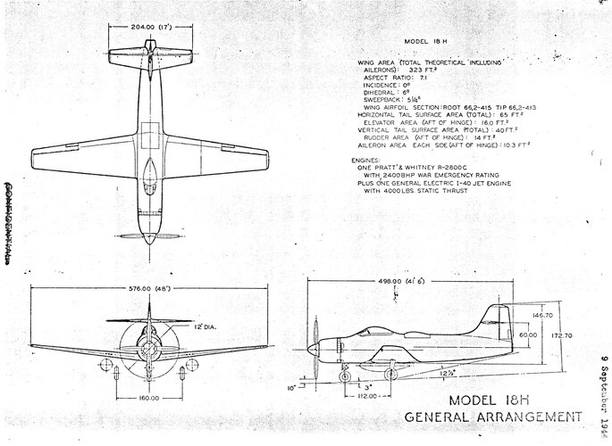

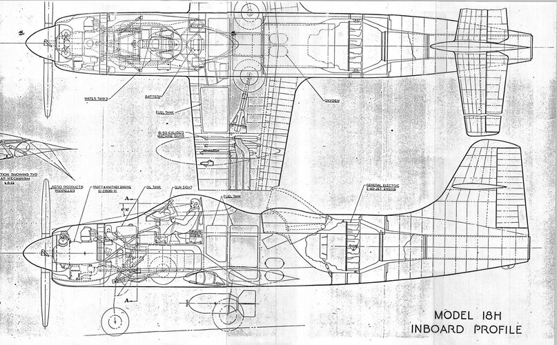

and I suggest that,McDonnell Model-18J and Bell D-22 may be submitted to
this competition.

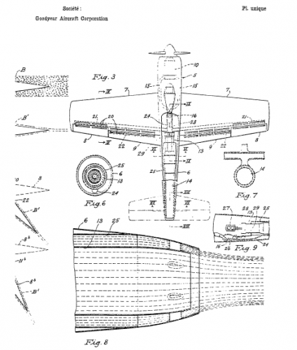

My dear Tophe discovered this patent,
for Goodyear,and I suspect if it was GA-5,but we can't confirm it was submitted to this contest.

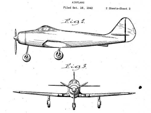

I saw on Net,a patent for mixed powered fighter,with inverted gull-wing shape,and it was never mentioned in this thread,unfortunately I was searched in anther subject,so I didn't care,can anyone help or remember me,what was it ?,and it was from early 1940s !.
Of course the Douglas D-592 was wrong,but I think it was many patent
to a mixed powered aircraft during this period.
