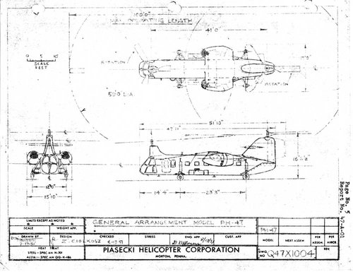

From Piasecki Helicopter Report 47-A-01 PH-47 Performance Data Report Anti-Submarine Helicopter dated 10 August 1951
Type: ASW Helicopter
Total Rotor Disc Area: 5468 feet squared
Number of Blades: 6 (3 per rotor)
Blade Chord: 22.25"
Rotor Diameter: 59'
Normal Gross Weight: 18046 lbs.
Empty Weight: 13666 lbs.
Fuel Capacity: 500 gallons
Power Plant: 2 Wright R-1820-C9H15 engines
Transmission Ratio: 14:1
