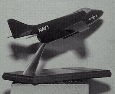

In Jay Miller's X-planes book the X-13 story begins by a 1946 meeting between Claude Ryan and R-ADM Stevens in which are evoked three options : an evolution of the XF5U (that I see well...especially as I never understood why the XF5U could not over when the V-173 could...), a pure-jet VTOL (this led to the X-13...) and a convertiplane with stowable rotor... and that's the one I wonder if someone had any conception of what the R-ADM had in mind ????
Any more info on the submarine-launched XF5U ?
Ryan Model 38 VTOL - 1947 https://www.secretprojects.co.uk/threads/ryan-x-13-vtol.5067/post-157495
Ryan Model 38, 84, 112, 115: VATOL Fighters for the USAF and USN https://www.secretprojects.co.uk/th...15-vatol-fighters-for-the-usaf-and-usn.11601/
