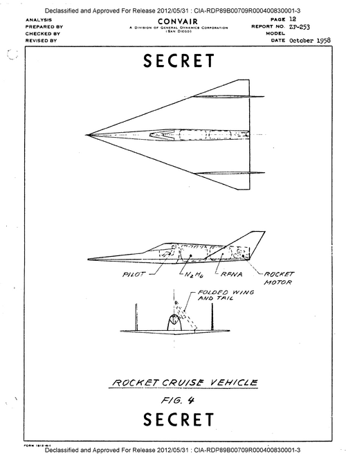

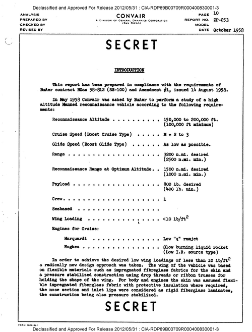

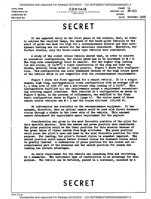

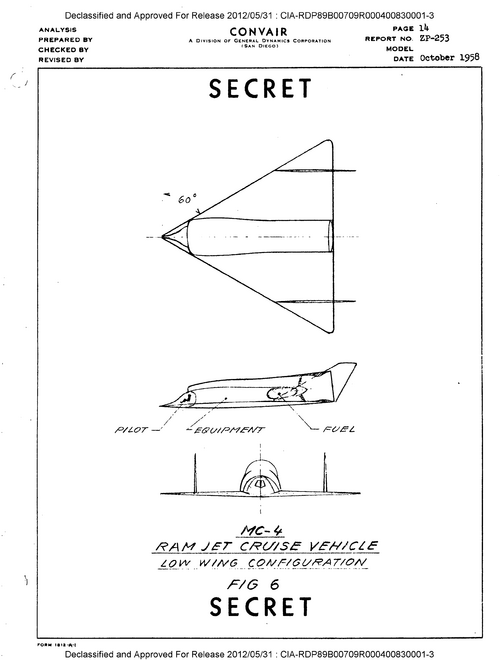

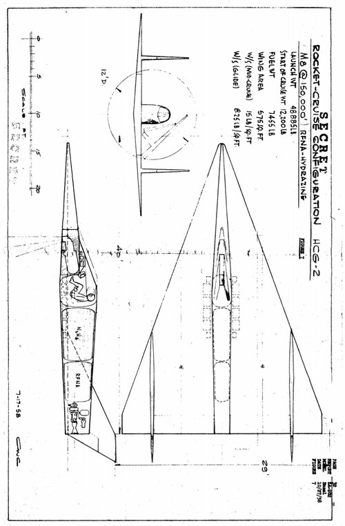

I doubt though that HASEL was related to DIPPER
