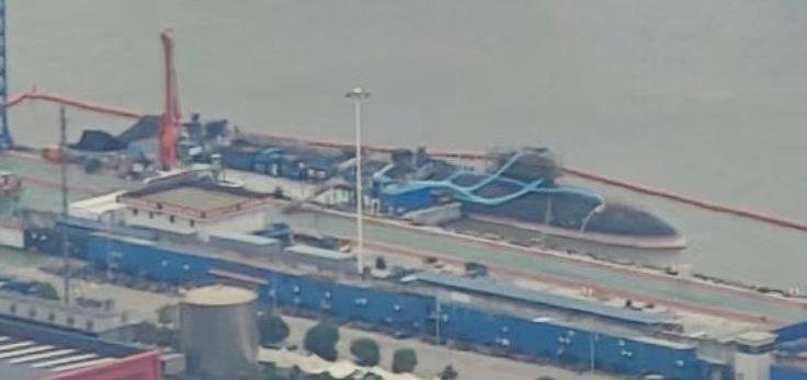

Can someone else also do a measurement? Because I am getting some quite peculiar figures. The length is hard to estimate as the gantry is covering sub's rear. But given how wide it is still at the leftmost side of the gantry - I am assuming length goes more or less all the way to the rightmost side of the gantry line.
But even with said length - which is substantial at 120-125 m - i am getting some very big figures for the width. Between 17 and 19 meters. Image is quite blurry so I am not sure where to measure the sub from, width wise - but even 17 meters would make it extremely wide.
Oscar-class are 18.2m wide.
So my assumption would be something like an Oscar, a double-hulled SSGN with missile tubes outside the pressure hull.

Sheer size. 130m long by 12m diameter is 10,000tons or so, Seawolf size. 120m long by 18m is more like 15,000tons, bordering on Oscar size.

Latest on the new submarines from SDF:
- It is much wider than what HI Sutton initially reported, a more realistic measurement would be 12.5m in beam and ~120m long.
- Likely hybrid hulled, interestingly instead of having a central portion of the pressure hull that is single hulled and tapered endings which is what'd you expect normally, it instead has one side ending in the full diameter (12.5m) of the hull and one side at a slightly smaller 10.5-11m diameter. We have direct evidence of this from the two pressure hull caps spotted in imagery from May 2025, one of a larger size at 12.5m diameter and one smaller at 10.5-11m.
- It has alteast 4 large multipack VLS tubes right behind the "sail" structure with a possible fifth, if these are the same ones on the 09V, then this submarine can carry up 12-15 UVLS cells.
- Very large X rudders, likely a bit lower in profile but wider than the ones on 09V which are already pretty large.
- Contrary to what HI Sutton and TWZ claims, the submarine launched in Bohai is likely to be of a different type but without proper imagery to confirm, it is difficult to confirm.
Based on those updates, we can probably confidently rule out the SSGN theory as it likely has less VLS cells than what the 09IIIB and 09V has. It's large size and hybrid hull construction also probably rules out the cheaper SSN to complement the 09V guess. The remaining guess we have are:

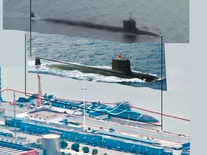

After not seeing them for a while, these submarines seemed to suddenly emerge from the ground. But I remember that in 2019, China already had an experimental submarine that was very similar to this submarine in some aspects.

Not small, just normal sized... I'm not really sure what's the obsession with trying to call it small sailed or sail-less at this point. I assume it's people trying to desperately linger on to the previous theory that this was a next generation prototype but at this point with new info this is the least likely theory.
Western sized sail.
Russian designs have significantly larger sails in both width and length.
Isn't that in part due to Soviet/Russian designs incorporating an escape-pod in the sail?
Yes, though I'm not sure why previous Chinese designs also have huge sails as none of them have a escape pod. This new submarine and 09V all have the thin western style sail designs.
