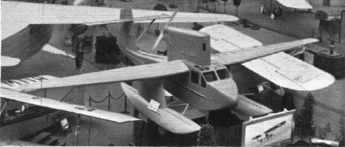

the Caudron P.V.200 high wing pusher amphibian twin
float monoplane,and powered by one engine.
http://www.secretprojects.co.uk/forum/index.php/topic,395.msg18899/highlight,caudron+200.html#msg18899

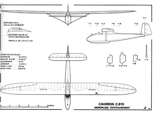

C.810 & C.811 gliders developed from C.800

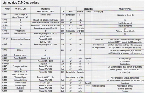

C.440 - 1935 Goéland 6-seat twin-engine utility a/c, ~1702 built
- C.440: March 1935 prototype light passenger transport, x 3
-- C.440: 2 x 180 hp Renault 6Pdi Bengali, span 17.60 m
-- C.440: Various engine installations tried, no wing diherdral
-- C.440: N° 1 prototype later converted into C.444 (qv)
- C.441: Pre-series, 3° dihedral on outer wing panels, x 4
-- C.441: To Armee de l'air as VIP transport/liaison a/c
-- C.441: 2 x Renault 6Q-01 6-cyl inlines,* span 17.60 m
-- * Same righthand propeller rotation for both C.441 engines
-- * hesham's source lists unhanded 220 hp 453-00
- C.442: [Project] 1935, 2 x 220 hp Renault 6Q-02/03 6-cyl.
-- C.442: Handed Renault 6Q-02/03 engines w/ superchargers
-- hesham's source lists 453-02 optimized for 2000 m
- C-443: [Project] 1935, 2 x 240 hp Renault 6Q-04 engines
-- C.443: 1st proposed Goéland vers. with handed propellers
-- hesham's source lists 453-02 optimized for 4000 m
- C.444: 1st built Goéland vers. with handed propellers
-- C.444: 2 x Renault 6Q-00/6Q-01 6-cyl.,** span 17.60 m
-- ** 220 hp usually quote despite lacking compressors
- C.445: As per C.444 but with 4° wing dihedral, 114 x built
-- C.445/1: Civil, 2 x 200 hp Renault 6Q-10/6Q-11s, x 2
-- At least 1 x C.445/1 converted to modular C.445M std.
-- C.445/2: (Project) 1937 Super Goéland postal vers.
-- C.445/2: (Project) For Air Bleu, 2 x 360 hp Renault 456
-- C.445/2: Built transp. vers., 2 x 220 hp Renault 6Q-10/11
-- C.445/2: 3 x built (c/n 8617, 8618, and 8619)
-- C.445/3: Postwar production version, x 510
-- C.445EF: 1942-43 Vichy prod. as Luftwaffe training a/c
-- Unclear as to meaning of 'EF' designation suffix (??)
-- C.445M : Modular-cabin militarized C.445/3,***, x 404
-- *** Unclear, 'M' for 'Modulaire' or 'Militaire'?
-- C.445R : Long-range version, fuel tanks in cabin, x 1
- C.446 : 1938 Super Goéland, higher-powered IV-12s, x 5
-- C.446 Grand Raid: 2 x 450 hp Renault 12R-00/-01s, x 1
-- C.446 (R): 2 x 600 hp (550 hp @ 4,000m) Renault 12R-02/03
-- C.446 (R): Listed as 'spéciaux' engines, reg. 420 hp
-- hesham's source lists 2 x 420 hp Renault 12R-00/01s
-- C.446 (R): Also feature 'spécial' reinforced u/c
-- C.446 (A): 2 x German 320 hp Argus As 410 IV-12 engines
-- hesham's source suggests As 410 have been sabotaged
- C.447: MedEvac vers., 4 x stretchers + 1 attendant, x 31
-- C.447 : 2 x 220 hp Renault 6Q-10/11 engines, (C.445 conv.??)
-- C.447/1: 2 x 240 hp Renault 6Q-20/21s, akin to C.449, x 10
-- C.447: aka Goéland C (suggesting 'Goéland A'/-B'
- C.448: Trans./Grande Tourisme, shortened span/no dihedral
-- C.448: Transport, 2 x 220 hp Renault 6Q-02 6-cyl., x 4
-- C.448-9: Poss. specific desig. for 'GT', out of sequence?
-- NB: C.448 'GT' developed in parallel with C.445R variant
- C.449: Final prod. vers., 2 x 240 hp Renault 6Qs, x 349
-- C.449/1: 1940 prod'n military transport, 295 x built
-- C.449/1: 2 x 240 hp Renault 6Q 20/21 6 cyl., span 17.60 m
-- C.449/2: (Project) Trainer, 2 x 410 hp Béarn 6D-03 6-cyl
-- C.449/2: To have reinforced u/c from C.446 Grand Raid
-- C.449/3: Lt transport vers., 2 x 240 hp Renault 6Q-20/-21
-- C.449/3: Lengthened fuselage, prototype never finished
-- C.449/4: Photo survey, 2 x 240 hp Renault 6Q-20/-21, x 8
-- C.449/4: Also 'police ccoloniale' + nav/bombing trainers
-- C.449/5: Postal variant (possibly for Air Bleu?), 7 x built
-- AA.1 : Postwar prod'n by AA (nationalized Caudron)****
-- **** Ateliers Aéronautiques d'Issy-les Molineaux

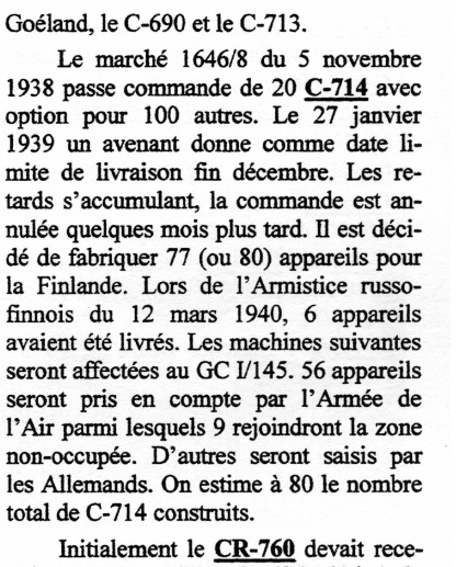

C.714 - 1938 single-seat monoplane light fighter, x 56
- C.714 : Cyclone, refined prod'n vers. of C.713 fighter
-- C.714.01: Prototype, 4 x 7.5 mm mgs in wing gondolas
- C.714R: 1 x 900 hp Renault 12R-03 inverted V-12, x 1
-- AdA desig. C.714 C1, sometimes seen as 'CR.714 C1'

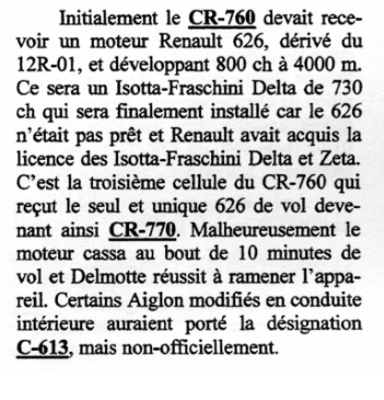

C.760 - 1940 single-seat light fighter, C.714 deriv., x 1
- C.760: 1 x 760 hp Isotta-Fraschini Delta RC.40 V-12
-- aka Caudron-Renault CR.760
-- 3v: http://www.airwar.ru/image/idop/fww2/cr760/cr760-1.gif
- JN 760: 1999 replica, Ranger V-12, 'JN for builder Jean Noan
C.770 - 1940 single-seat light fighter, C.760 deriv., x 1
- C.770: 1 x 800 hp Renault-626 V-16
-- aka C.770-01 (prototype), Caudron-Renault CR.770
-- C.770/CR.770 used fuselage and tail of CR.760-03

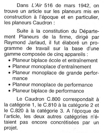

C.800 - (1st allocation) 1936 Ramier 2-seat tourer, x 2
- C.800 Ramier: 1 x 140 hp Renault 4 Pdi inverted 4-cyl

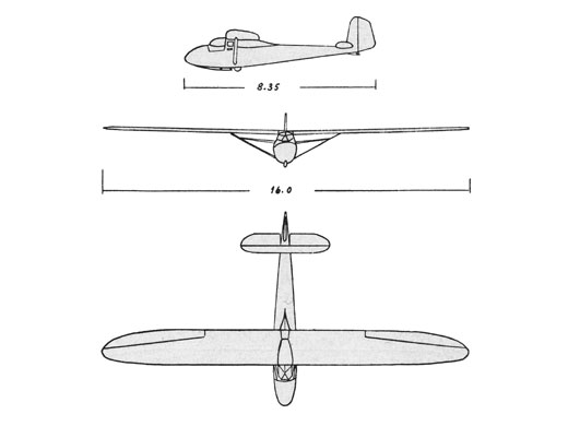

C.800 - 1942 Épervier 2-seat training glider, span 16.0 m

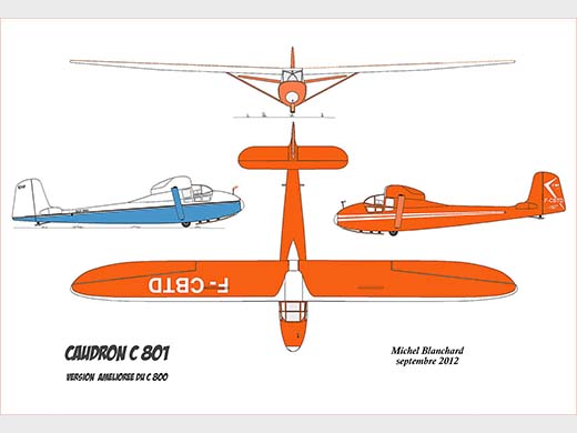

- C.801: 1951 improved prod'n version, Épervier Ramier x 10
-- https://www.j2mcl-planeurs.net/dbj2mcl/planeurs-machines/3vues/Caudron_C-801_3v.jpg
-- http://www.secretprojects.co.uk/forum/index.php/topic,9932.msg249934.html#msg249934

C.810 - (2nd allocation) 1942 Colibri basic training glider
- C.810: Colibri single-seat glider, span 14.00 m, x 1
-- https://www.j2mcl-planeurs.net/dbj2mcl/planeurs-machines/3vues/Caudron_C-810_Colibri_3v.jpg

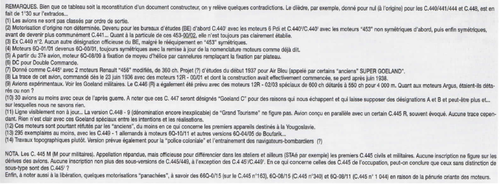

C.102 was a developed version of C.101,need confirm
and from the book; Les Avions Caudron Renault;
C.700 was a marine version of C.640,10/11-1935 Project
C.830/II was a single seat glider Project of early 1940,no more Info
May 26, 2006
28,348
5,983
Please my dear Apophenia add those aircraft,and also from Les Avions
Caudron Renault,you could find the missing designations here,and for
C.700,you can consider it a first use of this series.

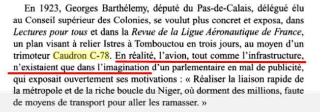

From TU 193,
Robert Espérou communicated to us an amusing article published in
"Lectures pour tous" of April 1923. This article recounts the imaginary
journey of Mr Georges Barthélémy, delegate of Sudan and from Haute-
Voita to the Conseil Supérieur des Colonies ... from Paris to Tombouctou
aboard a Caudron C-78 aircraft designed by engineer Deville. The aircraft
is a three-engined biplane (3X300 hp in line) of 156m2 of surface: 26m
of wingspan; 16.40m long and 6.30m high PV: 4100kg and PT 7300kg.
It carries 2600kg of gasoline and can fly 13 hours at 180 km/h average.
The crew was to include, in addition to Mr Barthélémy, Lieutenant Loste (pilot) and Engineer Biche.
Aubi
Aug 31, 2009
251
345
www.armedconflicts.com
Non-existent aircraft invented by the Deputy Barthelémy for his lecture as a means to show the advantages of fast aerial transport between France and its colonies.
May 26, 2006
28,348
5,983
We can't judge on that,and TU magazine knows more than us.

With the word "imaginary" in the quote you posted I think we can more than safely assume that.
An "amusing" article with an "imaginary" journey is not a technical report, its just a means to illustrate the point. He probably should have used a made up name to make his point clearer.

Maybe the journey was from his imagination,but the design was right.
Aubi
Aug 31, 2009
251
345
No. As the linked book says, "in reality, the airplane, as well as the infrastructure (mentioned in the article) existed only in the imagination of a parliamentarian in need of publicity (i.e. Barthélemy)".

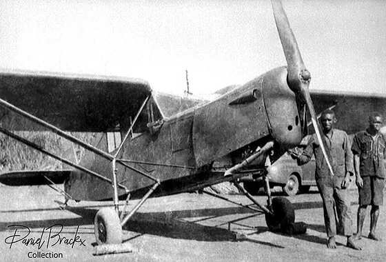

From TU 205,
Initially the CR-760 was to receive a Renault 626 engine, derived from the 12R-01,
and developing 800 hp at 4000 m.It will be an Isotta-Fraschini Delta of 730
ch which will eventually be installed as the 626 was not ready and Renault had
acquired the license of the Isotta-Fraschini Delta and Zeta.
This is the third cell in the CR-760 that received the one and only flight 626 thus
becoming CR-770. Unfortunately the engine broke after 10 minutes of
flight and Delmotte manages to bring the aircraft back. Some Eagle modified
in driving interior would have borne the designation C-613, but unofficially.
What was this ?,I think it was not misprint as C.713,because the 713 was
mentioned in the article before it by a few sentences ?!.
May 26, 2006
28,348
5,983
Here it's.
dan_inbox
Sep 3, 2006
964
543
I think the writer skipped from one topic to the other, only without proper paragraph spacing.
Topic 1 is the CR-760 re-engined and renamed CR-770.
Topic 2 is some C-600/601/etc Aiglons being converted to enclosed cockpit, and unofficially renamed C-613.

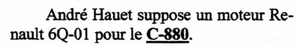

From TU 205,
a small Info about C.880 & C.850.
Apophenia
Jul 25, 2007
2,851
1,486
From TU 205,
There is a deal of confusion over the C.850 ... probably because that designation was re-used so many times.
The C.850 Mésange was, of course, a planned postwar French copy of the prewar German DFS Olympia Meise sailplane. Note that both Meise and Mésange translate as Tit or Titmouse.
In their Histoire du vol à voile français (Cépaduès, Toulouse, 1992), Reginald and Anne Jouhaud say that Caudron was originally tapped to provide French-built Olympia Meise (with orders for 210 later reduced to 100). Instead, it was later decided shift the contract to SNCAN - resulting in Nord 2000 Norplane production.
So, what is Trait d'Union talking about here? They seem to be proposing a motoplaneur development of the unbuilt C.850 Mésange sailplane. The designation C.850 was also applied to a built motoplaneur ... but that motor-glider was based on the C.800 Épervier airframe. Perhaps TU has simply muddled their Caudron designations?
