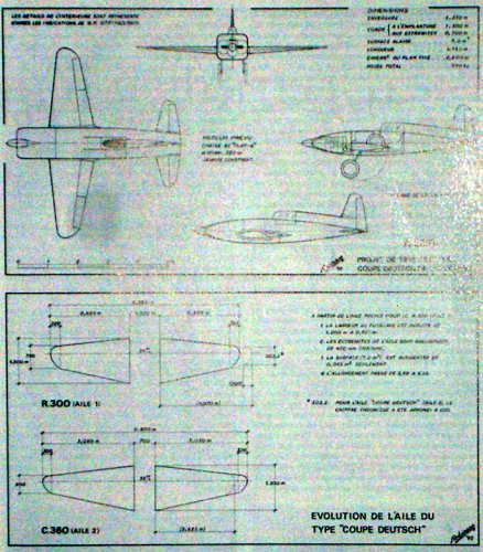

And here is the R.300 or CR.300 single seat mid-wing project,
but I don't know if it was a fighter or racer aircraft ?.

About the R.300, from "Les avions Caudron-Renault", by Harry Robinson, Docavia publisher :
It was a project of racer designed by Marcel Riffard and Otfinovsky, for the Deutsche-de-la-Meurthe competition of 1932. Only a scaled mock-up was made, and tested in a wind tunel.
Engine was to be a Flat-8 configuration, 8 liters, 320 HP at 3,000 rpm. It was never built too.
Projected datas : Span 6.25m x Lengh 5.75m - Wing aera 7m² - Total weight 770kg

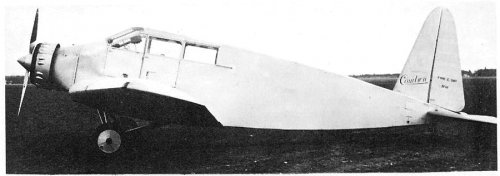

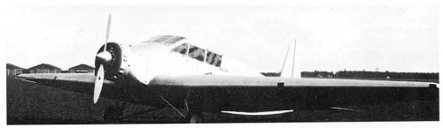

The little-known Caudron Deville C.240 four-seat prototype:

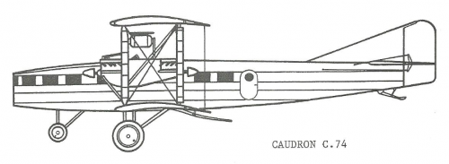

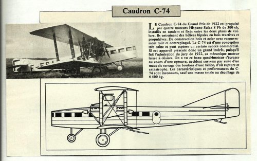

the Caudron C-74 was a four engined biplane medium transport aircraft project,
powered by four 300 hp Hispano-Suiza 8 Fb engines.

My dear Hesham
Not a project...but a proto and an accident !

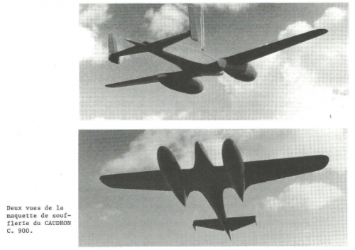

in 1937 C.2/C.3 for two/three seat fighter competition,the main tenders were;
Hanriot H.220-2 (or SNCAC NC.600),Potez P-670 & P-671,SNCASE SE.100,SE.101
& SE.102,Breguet Br.700,Delanne DL-120,Wibault twin engined fighter,Payen Pa.323
& PA.310 CB and Caurdon C.900.
The Caurdon C.900 was two seat low-wing fighter project,powered by two 1250 hp
Isotta Fraschini Zeta RC 42 engines,the motors were mounted under the wing and
it had a twin tail fin,with a slim fuselage only from front and rear,two examples were
never completed.
TU magazine issue 186

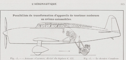

From l'Aeronautique 1934,
here is unknwon project to Caudron,it was C.432 with strange modification.
Interesting. The aircraft is said to be called the "Aviocar", a roadable derivative of the C.432. I can see no other piece of information here on that particular project.
From what I gather here, the image and text suggest that the Aviocar could make good use of a Tampier engine used for taxiing that could be easily folded out from the fuselage, but there is no indication that this was actually planned in the Aviocar.
This project appears in an article by René Tampier, starting in this page:
http://gallica.bnf.fr/ark:/12148/bpt6k6555455p/f38.image
In this article, Tampier showed possible applications of his ideas to various existing aircraft: Caudron C.430 (misnamed C.432), Cierva C.30, Nieuport NiD.941.
It seems clear to me that these projects were not endorsed by the constructors themselves. Maybe they were approached by Tampier, but even this is unsure.

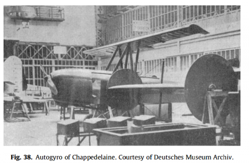

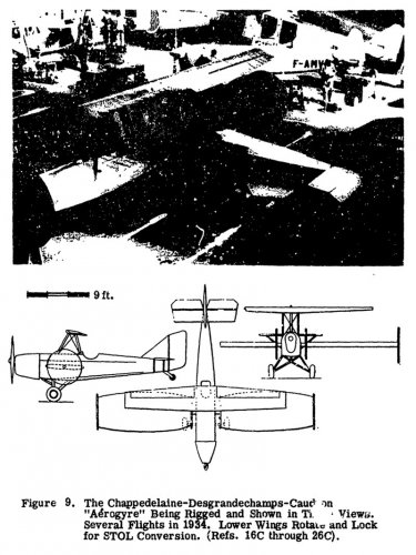

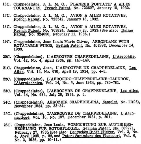

New to me, the Chappedelaine-Desgrandschamps-Caudron Aérogyre of 1934. I haven't found this Chappedelaine project via the search engine.
USAAVLABS Technical Report 69-13
Review and Preliminary Evaluation of Lifting Horizontal-Axis Rotating-Wing Aeronautical Systems (HARWAS)
richard said:
More here
Thanks richard! I'm attaching the two pages of the article in question:

the Chappedelaine Aerogyre.
http://www.homepages.ed.ac.uk/shs/Climatechange/Flettner%20ship/Seifert%20Flettner%20apps.pdf

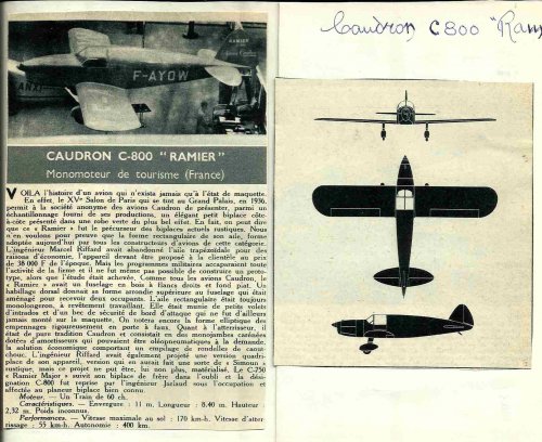

the Caudron C.750 was a four seat project version of C.800 Ramier tourist aircraft,powered
by one 140 hp Renault 4 Pei engine.
the C.820 was a single seat high performance glider project developed from C.800.
