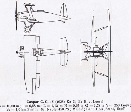

CC 15 was single engined recce seaplane Project,powered by one Napier engine.

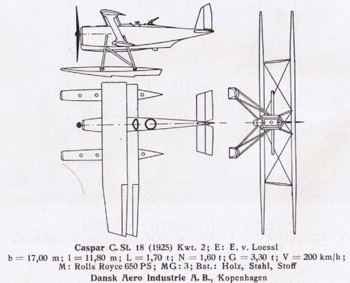

CST 18 was two seat sesquiplane recce seaplane Project,with float and powered by one
Rolls-Royce Condor engine.

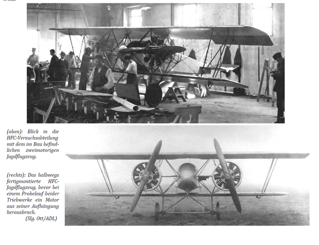

  • Experimental twin engined fighter (2 x Oberursel), built in 1917/18. During a ground test one of the engines broke loose and killed a technician. The development was stopped.

    CST 18: 1924 project of a biplane fighter floatplane with Rooles Royce Condor or Hispano Suiza, 300 hp. Not built.

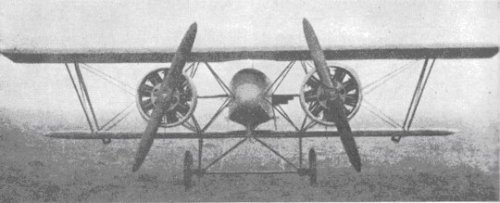

and here is early aircraft under Hansa company.
Tuizentfloot said:
It is the experimental twin engined fighter of 1917/18
Yes my dear Tuizentfloot,
and never put on production line.

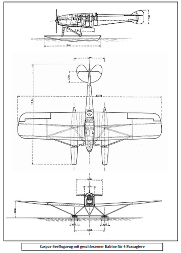

Amazing find my dear Richard,

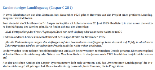

and here is with some Info about C.28,but what was in this drawing No.1 ?.

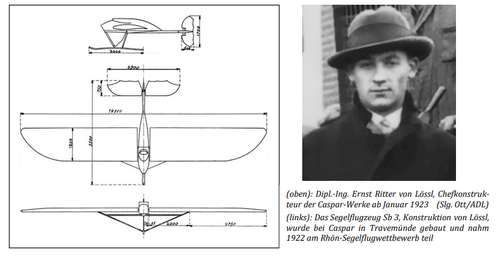

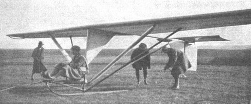

Many thanks my dear Richard,
and Sb 3 was related to him,he was the building,as the article,right ?.
and SB.3 was related to him,he was the building,as the article,right ?.
Sb 3 not SB.3 - the latter was a contemporaneous Akaflieg Braunschweig designation.

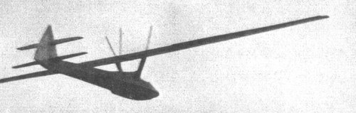

Dipl.-Ing. Ernst Ritter von Lössl - also seen written as von Loeßl or Lößl - became Chefkonstruk-teur of Caspar-Werke in 1923, having come from the Technischen Universität München.
The 'Sb' series designations began when von Lössl was at TH München. That series was:
- 1921 Sb 1 Münchener-Eindecker constructed by B.A.Cl.München
-- Sb 1: A high-winged framework training glider, span 11.00 m
- 1922 Sb 2 same layout as Sb 1, Sb 2 airframe constructed by FVA*
-- * FVA = Flugwissenschaftliche Vereinigung Aachen (Aviation Science Ass'n Aachen)
- 1922 Sb 3 (shown in your 3-view) built by Caspar-Werke at Travemünde
-- Took part in the 1922 Rhön glider competition in 1922
The B.A.Cl.München mentioned in connection with the Sb 1 was the contemporary abbreviation for the Bayerischer Aeroclub, München (later referred to as the 'Germanized' Fliegerklub München). It is possible that the 'b' in Sb series designations was for B.A.Cl.München (or just 'Bayerischer') while the 'S' was for Segelflugzeug.
