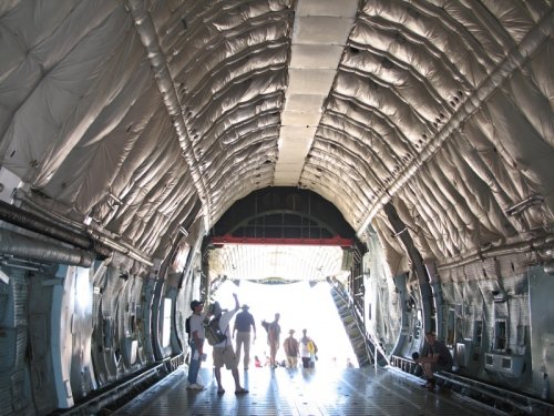

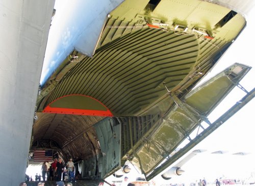

Somewhat surprisingly, the C-5Cs have shown up at airshows; this example being 68-0213 seen at MCAS Miramar in 2009.
Discussion with a crew member indicated that the C-5C's were pretty much without a mission with the upcoming retirement of the Shuttle. Indeed, this example was available for airshow duty because the C-5A/B was heavily tasked. At the time, the C-5Cs were being used as trainers and "bounce" birds.
Nonetheless it was related that the C-5Cs would be inducted into the AMP and RERP programs. (Note that this info is a little dated and is based on what the crewman chose to tell me.)
Attached is an image of the aft cargo area; note the bi-fold cargo doors, highly modified upper deck (torque box) and absent upper cargo deck (area where the beige insulation is present).
