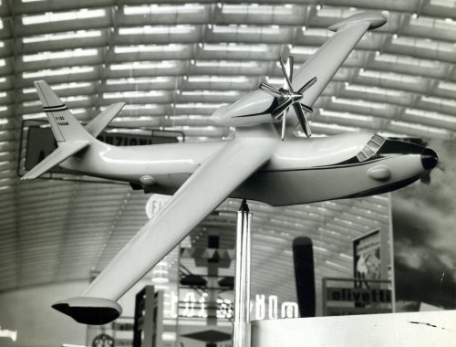

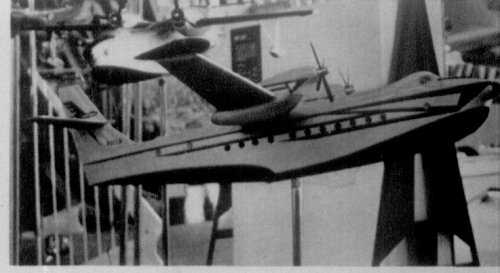

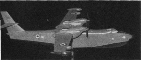

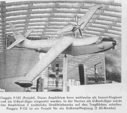

Found this photo of a model of the Piaggio P.155 ASW amphibious aircraft
in FLIEGER 1955. I think, it was one of the 25 contenders to the NATO ASW
aircraft, which eventually saw the Breguet Atlantic as the winner.

My dear Jemiba,

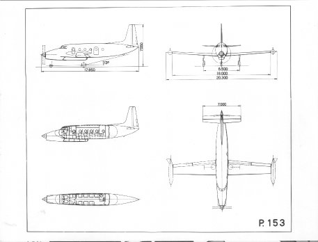

Good found,but can you translate anther info. about Piaggio
P.153 project,please.
"can you translate anther info. about Piaggio "
Of course:
"The Piaggio P-153 is a project for a ground attack a/c (with two AS-Mamba engines)"

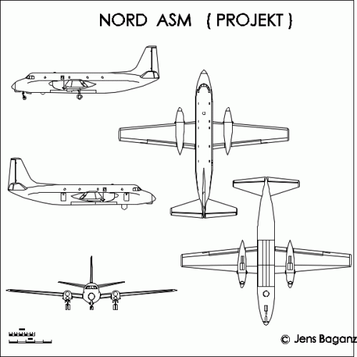

AFAIK, the Nord contender, mentioned by Cuny only as ASM, was
a Breguet Atlantic lookalike. The Noratlas derivatives were just
intended as ASW trainers and were already outdated at the time
of this program.

special question for the italian-fan Skybolt! Do you have more informations about the Piaggio P.153?

My dear Jemiba,
I forgot to ask you what was Nord design (N.?)?.
Anther version of Piaggio P.155,with two engines.

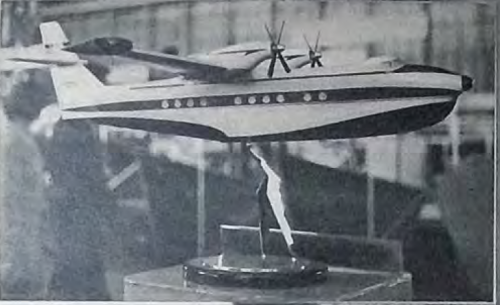

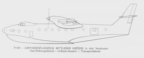

From an Piaggio advertisement in Intervia 1958, a profile
of the P.155 :

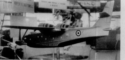

"Hi Everyone.

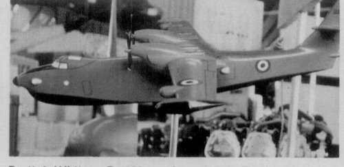

Found the attached photo at the Heathrow Air Fair last Sunday. It shows a model of the Piaggio P.155 flying boat project on display at an industry show somewhere. My knowledge of Italian flying boats is zero, so I wondered if anyone had any information please. I don't even know if this design was ever built or flown because I cannot find any references to it anywhere. I am assuming 1950s but the photo has no information on the back.
Thanks to all of you for your support again this year. Very Best Wishes for Christmas and the New Year.
Tony Buttler"
Looks like Tony forgot to search Secret Projects forum ;D ;D ;D
http://books.google.com/books?q=piaggio+p.155&btnG=Search+Books
Heaps of references from periodicals of the time. Seems that Piaggio approached Saunders-Roe to test P.155 in their tanks.

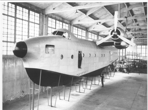

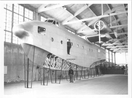

In fact, there were some different iteration of the Piaggio P.155 project, answering different requirements. The basic project was inspired by last Martin seaplanes and differed mainly for the power plant. There was a twin radial version offered to Aeronautica Militare as a replacement for Piaggio P.136 and CRDA Cant.Z.506S for sea Search And Rescue rôle; this version was built in wooden mock-up form. One of the turboprop configurations was a contestant in the Atlantic program and If I remember right, there was also a version for amphibious special missions.
About the P.153 (project only) I was able to find only a three-view drawing with two sections. The aircraft appear to be be a modern single-turboprop executive (perhaps with an Armstrong-Siddeley Double Mamba), similar to the today Pilatis PC-XII.
Nico

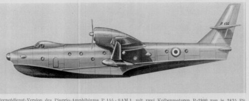

From InterAvia, July 1957 the Piaggio P.155 SAM-1 SAR variant, ASW variant AS with PTL-engines
and the P.155X for 20 to 30 passengers and PTL engines, too. The side view of the P.155 SAM.1
comes from InterAvia, May 1957

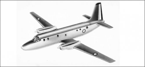

Hi All!
Great Britains Atlantics contenders:
Bristol 206
Fairey
Avro 745
the Avro-745 from Avro Heritage site,by the way it was refused by NATO
because it is too big in its size.

I found another picture, slightly different, of the wooden mock-up of the piston-engined Piaggio P.155
Nico

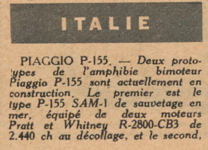

From aviation magazine 1957,
all Info about Piaggio P-155.

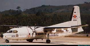

e fokker one is actually the fokker f.27-200MAR the maritime patrol version of the f.27 it was used by many airforces like thailand netherlands ect... 1651235663964.png
The F.27 was not mentioned in any NBMR.2 documents I've seen, otherwise I'd have mentioned it in Nimrod's Genesis. Fokker, however, was mentioned as they were building the Atlantic wing centre section.
