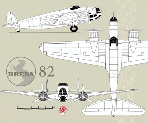

Who can help me with, at least, a three side view drawings of the Ba.82???????

There are photos of Breda 82 also in airwar.ru, but line-drawing nothing ! ::)

Yes Airman I found already these and other pictures, thanks for the information
juanT thanks for this drawing this is a nice start, thanks

unfortunately I dont have information about the breda in Argentina and with regard to BA-82 for several years I too am looking for a 3-view about this aircraft, and for last i found other pic

I am very pleased with this picture, Thanks!!!!!!
If you have information/material concerning other Breda aeroplanes/projects and the CAB SV4 and 5 (biplanes build by Breda) and you will help me, please let me know what you have??
