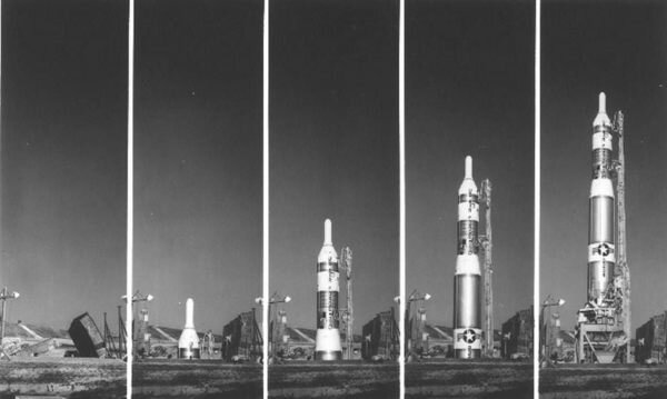

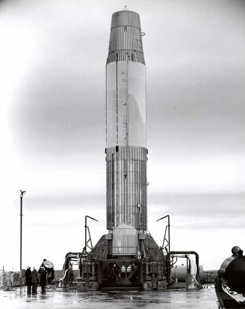

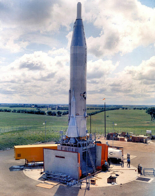

I once thought LOX ICBMs couldn't be housed in silos because boiloff and took forever to launch. Well seems Atlas-F and Titan 1 did it nonetheless, although their silos were enormous and not very practical. And McNamara screwed them by 1966.
Yes and no;- the cryo oxygen wasn’t stored in the missile, it was stored in a stainless steel dewer next to the silo. The boil off was reliquified and squirted back into the dewer. Upon the launch command, they pumped the liquid oxygen into the missile while raising the missile out of the silo on a massive elevator. This took about 20mins and was frought with danger. In just five years, no fewer than seven missile and silos were destroyed in launch preparation exercise.
Here’s a great real time audio recording of one of these incidents;-
http://www.atlasmissilesilo.com/Accidents_577thSMS_Site6.htm
With a Titan 1 accident they just got the fully fuelled missile out of the silo when the elevator latch failed. The fragile thin walled missile descended rapidly back into the silo followed by a massive conflagration.
McNamara killed the concept because it was just a matter of time before something really nasty happened.
Although not fully known at the time of Blue Streak cancellation these were a good reason for not proceeding with it.
"while raising the missile out of the silo on a massive elevator."
Ah, no. That was an early version of the launcher. By 1960 it was 'fire in the hole'.
No - Alert Cryo Oxygen Atlas F and Titan 1, the mainstay of the US force up until 1965 could not be fired from within the silo. The operational silo’s were never exhaust ported as per those of the Titan 2. Early Atlas were stored horizontally without LO2 and it was pumped in after raising to vertical.

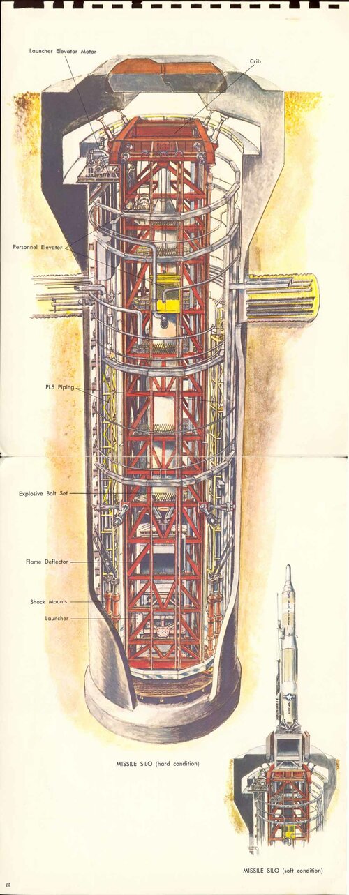

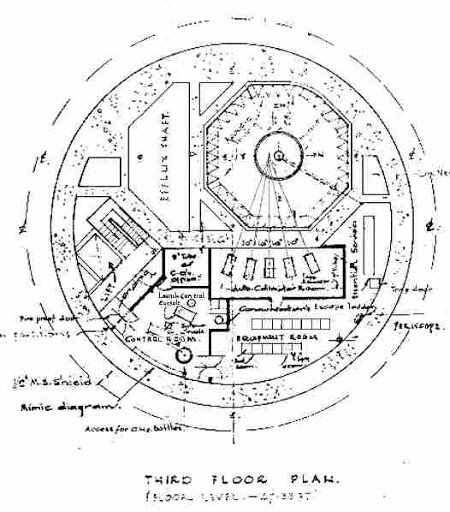

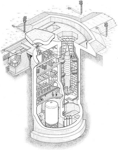

The audio recording attached to post 13 has them loading prior to lifting. I understand load during lifting was possible on the Titan 1.
The one off Titan1 test was fired from a prototype Titan 2 silo with a “W” exhaust port.
Blue Streak K11 silo had “U” exhaust port and was designed to be fired from within the silo. The cryogenic oxygen was stored in an underground Dewer next to the missile. Hence it had to be pumped into the missile prior to launch, a process which may exceed the available warning time. Hence the system had to survive the first strike or was itself, primarily a first strike system.
What would be the point of a W exhaust rather than a U?
U vs W, I honestly don’t know why you would choose one or the other.
