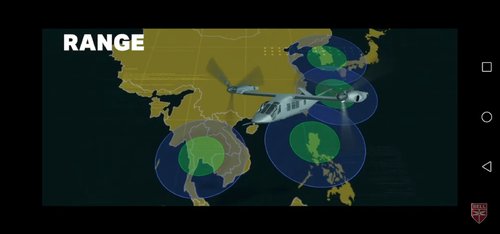

I wonder, how does the V-280 Valor compare with the MV-22 Osprey in terms of overall cargo carrying capability and range?
Cordy
ACCESS: Confidential
Nov 5, 2019
94
64
Powerplant, Bell reached agreement with RR for them to supply the propulsion system for the V-280 in July, so how accurate is the rest of the specs quoted by Janes?
yasotay
Oct 19, 2006
2,537
801
Thanks for the great chart! Interesting what a couple of decades of experience does for a technology. That said, one must recall that V-280 is a tech demonstrator, nor does it have all of the gear necessary to transform into a smaller deck space, talk to all of the units, and protect itself. So Janes is comparing a combat aircraft to a technology demonstrator. As @Cordy just pointed out Bell has agreement with RR for engines for their FLRAA offering. Likely a derivative of the AE1107 core. So the numbers will of course be different.
AeroFranz
May 4, 2008
2,311
226
@yasotay beat me to it - The cruise speed comparison may not be an apples to apples comparison. The V-22 figure looks representative of an operational aircraft. The V-280 doesn't have all the 'warts' that are needed to turn it into a military machine (EO/IR turret, RWR, DIRCM, all the comms antennas, chaff/flare dispensers, etc.). It's still probably faster -it doesn't have the draggy cargo ramp, for one. But conversely, that ramp is handy for loading stuff...
