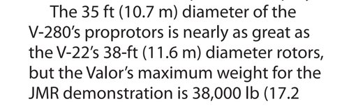

Are you sure about that? As far as I know the V-280's rotors are 35 ft each and the UH-60's rotor is 53 ft.

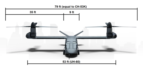

Ceck your mathThe overall width must be at least 79 ft, to prevent those 35 ft rotors from slicing the fuselage.
Not going to argue since it might actally be wider. However since its length is something like 50.5 feet, it can turn sideways and be shorter than the width of an H60. Also, since it is a dual rotor like a Chinook, it is less effected by wind direction. So it can land sideways into the LZ. As stated elsewhere if this is an overriding issue, then the US Army should never have bought the H60 because it cannot land int the same restricted places as the H1 it replaced. However since this is a concern for less than 1% of the missions executed by Army utility rotorcraft, I don't think this will be a significant decision point.You are correct on the diameters, however that V-280 rotor diameters are at the end of a 20 foot-ish wing. In fairness to you I could be incorrect with my actual numbers as I don't recall where I got them at the moment.The rotors (turning) are four feet wider than H-60.
@ Sundog - I think the author has been made aware of his utter lack of brilliance.
I've made an illustration to clarify my point. Please note that a width of 79ft is the minimum, without any clearance of the rotors to the fuselage.

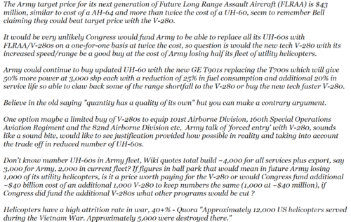

I am old enough to remember these arguments when UH-60 and AH-64 were the "new" phenomenally expensive high tech rotorcraft replacing reliable, dependable, less expensive UH-1 and AH-1. No, we did not replace them 1 for 1 then either. The Army had something like 5000 UH-1 on hand at the end of the Vietnam conflict. We traded them for ~2300 UH-60. There was then a wailing and gnashing of teeth at the horrible detriment to the Army of this outlandish decision.
