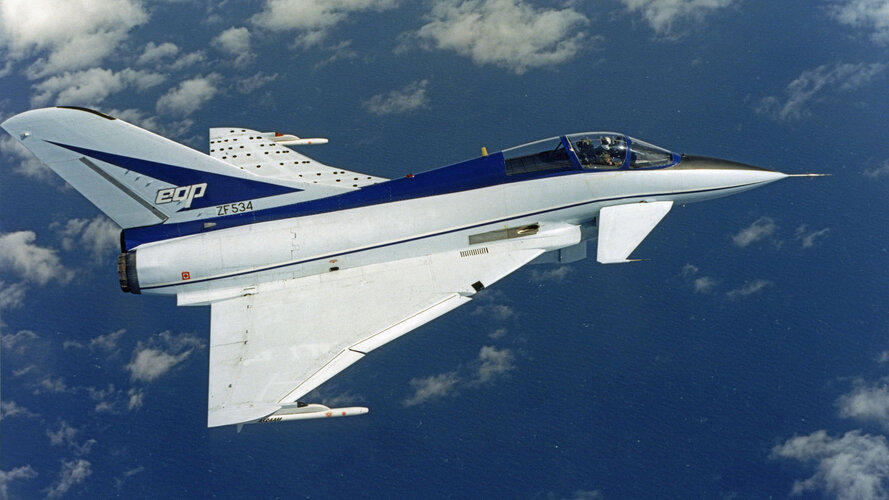

EAP wing manufacturing technology; leaflet by BAe. (Source : Rochester Avionics Archives. There's even a thread about them https://www.secretprojects.co.uk/threads/rochester-avionic-archives.29176/)
EAP wing, according to the leaflet, was the first co-bonded structure of its scale for aerospace purposes up to that point. It was a departure from MD/BAe Harrier GR Mk.5 which featured a composite main wing manufactured with secondary bonding technique, connecting the wing-boxes to a single-piece main wing skin.

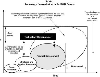

FROM DEMONSTRATOR TO EUROFIGHTER
It is estimated that the £190 million investment in the Experimental Aircraft Programme Technology Demonstrator saved the Industry and Government £850 million in development costs for the resulting Eurofighter and shortened the development time by one year. Similarly, the XG40 Demonstrator for Eurofighter's EJ200 engine cost £135 million but saved £650 million from the development programme. Demonstrators may sometimes appear expensive, but are in fact a fraction of the total development cost—typically less than 10 per cent.
