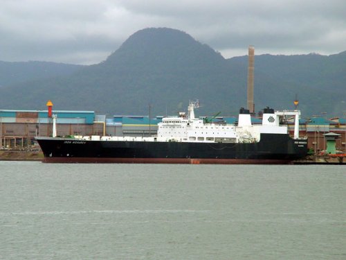

The MVs Iron Duke and Iron Monarch were RO-RO vessels used by BHP to carry steel products. The proposal was for the RAN's nascent training and helicopter support ship (THSS) requirement to replace HMA Ships Jervis Bay and Tobruk. The RAN wanted a new build, milspec LPD type for the THSS and when they put it to Government in a cabinet submission in the early 1990s ended out with two ex-USN LSTs (later HMA Ships Kanimbla and Manoora). With the same level of modification as went into Kanimbla and Manoora (eg hospital, accommodations) the Iron Duke and Iron Monarch would have been much better ships without the corrosion problems of the ex LSTs.
What was the level of compartmentalisation of the two BHP ships?
There were more than likely valid reasons such as the fear of using commercial hulls for what were essentially warships. It may have been a case of penny-wise, pound foolish. Despite alll the bad press that MANOORA and KANIMBLA have received, they were constructed as warship hulls and had superior damage control facilities to a commercial hull.
The fate of Atlantic Conveyor would certainly have me very concerned about using a Ro-Ro type ship in a true warship role. The lack of transverse subdivision allowed fire and smoke to spread rapidly throughout the ship, and lack of longitudinal bulkheads would make flooding almost impossible to control.
Well where do I start... As an LST HMA Ships Kanimbla and Manoora are basically of the same internal design as any commercial RO-RO. The tank deck is not subdivided with water tight compartments. Nor are LSTs designed to survive considerable damage. Further the loss of Atlantic Conveyor was not simply a result of it being a commercial ship. The very naval standards HMS Sheffield was also lost after being hit by an Exocet missile. A big bang, lots of fires and the heavy seas of the South Atlantic are pretty terminal for any type of ship.
Both Iron Duke and Iron Monarch severed for some time as commercial ships, I think Iron Monarch may still be in service. They did suffer early hull stress which lead to a reduction of their top speed. Probably a strong reason why they were rejected by the RAN.
