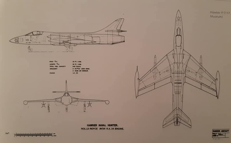

Looking at the company GA. drawing it seems the P.1117 'Naval Hunter' was proposed with a non folding wing

FWIW it looks too good to be true to me. Maybe it's too heavy. Maybe it's take off and landing speeds are too high. Maybe its range is too short and/or the armament is too small. Worst of all maybe the wing can't be folded at the wing root, which voids everything that I've written, because the small folded wingspan is what makes it so attractive.
I've discovered why it's too good to be true. It's been staring me in the face. And I didn't notice it until earlier today.
  • It's the undercarriage.
  • The wheel track of a Sea Hawk is 8ft 6in.
  • The wheel track of a Hunter is 14ft 9in.
Either the Sea Hunter has to be redesigned with a new undercarriage with a narrower track or where the wings fold will have to be outboard of the main wheels. The latter is the most plausible, which wrecks my argument for the Sea Hunter, because it increases the folded wingspan considerably.
The most obvious position seems to be between the ailerons and the flaps, which, according to my measurements of the line drawings, increases the folded wingspan from 11ft 10in to 18ft 8in. That means it can only be stored two-abreast in the 52ft wide hangar of a Colossus/Majestic class ship. Although that's about narrow enough for it to be stored in the 62ft wide hangars of a Centaur class ship.
The next best position seems to be immediately outboard of the landing gear. My calculations from the line drawings are that the folded wingspan at that position would be 15ft 8in. That would allow Sea Hunters to be stored three-abreast in a Colossus or Majestic class ship with 5ft to spare. However, 4 x 15ft 8in = 62ft 8in which is too wide for four abreast in a Centaur's hangar. The problem with the wings folding here is that the flaps will have to be redesigned and split into two.
Maybe this is why the navalised Hunter didn't have folding wings. However, the initial batch of Type 548 Sea Swifts didn't have folding wings either. Therefore, maybe the P.1117 was intended for fixed-wing jet familiarisation trials too and was Hawker's submission to Specification N.105.
Bugger. Kills that idea.

Fighter design is hard, naval fighter design is even harder.
I'm more nonplussed by that statement than I am by your reply to Message 285. It's the mother of no-brainers.
The point is, that I should have noticed the metal legs protruding from the bottom of the wings to the round rubber things that touched the ground, when I measured the line drawings of the Hunter. That would have saved myself a lot of time and everyone else (particularly you and @Scott Kenny) some aggravation.
A wide track undercarriage and low centre of gravity is great for stability during carrier landings, but it does impact wing fold and therefore hangar footprint.
The Sea Hawk was a naval fighter and the Hunter was a land fighter. Yet, the naval fighter's undercarriage track was narrower than the land fighter's. That is 8ft 6in v 14ft 9in. FWIW, the Sea Hawk also had wingspan that was 5ft 4in greater than the Hunter, that is, 39ft 0in v 33ft 8in.
