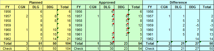

72 cruisers and DLs, plus 72 destroyers?, plus the 12 Carriers would leave you short by quite a bit. Perhaps they are counting the 60 Picket ships?SHIPS WITH AIR DEFENSE MISSILES...................................200-Plus
That seems off. I count 410 surface combatants.SHIPS WITH ANTI-SUBMARINE MISSILES...........................450-Plus

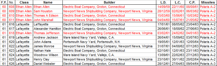

I've given this some thought in the past. Looking at US intermediate-range missile actual and proposed bases could be instructive: Thor was actually deployed in the UK, with bases in Alaska, Okinawa and Spain considered. Jupiter was actually deployed in Italy and Turkey, with France considered. There's some similarity there with Polaris bases. I think the key question is - would the fifth squadron be in the Atlantic or in the Pacific?I know about Submarine Squadron 17 at Bremerton, Washington, but that doesn't count as it wasn't formed until January 1981 and as far as I know was for the Ohio class. That is, unless, that's where the fifth Polaris submarine squadron was to have been based.
It doesn't look like THOMAS JEFFERSON was particularly late. 612-615 were THRESHER class fast attack submarines, and LAFAYETTE was laid down only two weeks before THOMAS JEFFERSON. It's not entirely unusual when doing incremental improvmeents to a design like this for the first of a new batch to be ordered from a trusted lead yard (Electric Boat) to work out the kinks whilst the last of the old batch are being built at a second yard.6 Lafayette class (SSBN 612-617) were built between the fourth Ethan Allen (SSBN 611 John Marshall) and the fifth and final boat of the class (SSBN 618 Thomas Jefferson). Does anyone know why she wasn't built as a Lafayette?
Firstly, I saw that I'd screwed up over 612-615 after uploading Post 45. However, I didn't correct it because it didn't alter my argument.It doesn't look like THOMAS JEFFERSON was particularly late. 612-615 were THRESHER class fast attack submarines, and LAFAYETTE was laid down only two weeks before THOMAS JEFFERSON. It's not entirely unusual when doing incremental improvements to a design like this for the first of a new batch to be ordered from a trusted lead yard (Electric Boat) to work out the kinks whilst the last of the old batch are being built at a second yard.6 Lafayette class (SSBN 612-617) were built between the fourth Ethan Allen (SSBN 611 John Marshall) and the fifth and final boat of the class (SSBN 618 Thomas Jefferson). Does anyone know why she wasn't built as a Lafayette?
One option is to build 46, and decomission GEORGE WASHINGTON early. It was a bit of an odd boat compared to the rest of the class.That's a pity because if the 4 Boats planned for FY65 had been built it would have been possible to organise the 45 Boats into one squadron of 9 Boats armed with Polaris A-3 missiles and four squadrons of 9 boats armed with Poseidon C-4 missiles.
Which makes a possible case for Italy to get a deal on the base - perhaps Alfa would still be dead given US pressures to avoid proliferation (i.e. non-US missile tech rivals) but perhaps a couple of Italian Polaris subs too?Alternatively, a forward base might be prefered, in which case I'd be looking at Italy - La Maddelena seems like an obvious candidate. Turkey is almost certainly too close to the USSR for comfort.
Noted, but I think finding a way to make Thomas Jefferson a Lafayette instead of an Ethan Allen is the more elegant solution. Perhaps it could be made hybrid ship, i.e. an Ethan Allen class with Lafayette missile tubes.One option is to build 46, and decommission GEORGE WASHINGTON early. It was a bit of an odd boat compared to the rest of the class.That's a pity because if the 4 Boats planned for FY65 had been built it would have been possible to organise the 45 Boats into one squadron of 9 Boats armed with Polaris A-3 missiles and four squadrons of 9 boats armed with Poseidon C-4 missiles.

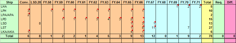

Playing around with some broadly-contemporary figures (which I think are from Friedman's US Amphibious Ships, but can't confirm just now), the 1958 paper seems to suggest 1.5 MAF lift. The requirement for one MAF would be:As far as I know the USN had a requirement for enough 20-knot amphibious shipping to lift two Marine Amphibious Forces? (one in the Atlantic and one in the Pacific) since the late 1940s.
However, there was only enough 20-knot ships to lift 1.15 MAFs in 1981. The "600-Ship Navy" included enough amphibious shipping to lift one MAF and one Marine Amphibious Brigade (the equivalent of one-and-a-third MAFs), but if I remember correctly not until 1992 or 1994 depending upon how much money was spent.
Do we also get the 30 Fast Deployment Logistics (FDL) ships? Late 1960s editions of Jane's say they were to work with 14 squadrons of C-141 Starlifters and 6 squadrons of C-5 Galaxies. The USAF already had the Starlifter squadrons, but only 4 of the 6 C-5A squadrons were formed because 81 were bought instead of the 115 that were required. Therefore, if we do get the 30 FDL ships do we also have another 34 Galaxies?
I've got my copy of Jane's 1968-69 out. The United States Navy section was compiled and edited by Norman Polmar and the Amphibious Warfare Ships sub-section begins with this paragraph.1 the Playing around with some broadly-contemporary figures (which I think are from Friedman's US Amphibious Ships, but can't confirm just now), the 1958 paper seems to suggest 1.5 MAF lift. The requirement for one MAF would be:
That actually tracks with the number of NEWPORT class tank landing ship ordered: 27 were planned, but only 20 were completed. Similarly, 15 amphibious transport docks and 13 dock landing ships were completed in the 1960s and early 1970s, all corresponding broadly to 20-knot shipping for a 1.5 MAF lift capability.

That's a total of 2 division/wing teams and I think the long-term goal was to have enough 20-knot amphibious lift capability all of that force instead of 75% of it.The US Navy seeks to provide 20-knot amphibious lift capability for 1.5 Marine Corps division/wing teams plus sufficient slower amphibious left for another half of a division/wing team. (A Marine Corps division/wing team numbers some 35,000 to 40,000 enlisted men.)

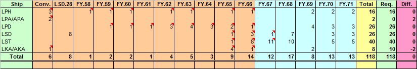

That's a total of 132 amphibious ships and 4 tankers. That's similar to the fleet for 1975 as projected in 1967 which included 137 amphibious ships. See Post 38.At this time the navy's force goal for FY 76 [01.7.75 to 30.06.76] was two 20-kt MEF-level forces:
McNamara supported both 20-kt capability and the ability to mount a full divisional attack. With limited rather than general war in view, 20 kts no longer seemed so important as protection against submarines. In a world full of crises, however, it offered valuable flexibility. a 20-kt force in the Eastern Pacific could deploy to many areas in the Atlantic about as quickly as a 13-kt force based in the Atlantic.
- 6 AGC,
- 16 LPH,
- 10 AKA,
- 26 LSD,
- 26 LPD,
- 40 LST, and
- 4 tankers,
- plus ancillary ships such as 6 APD and 2 APSS.
