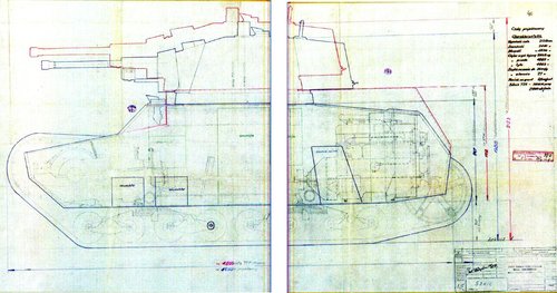

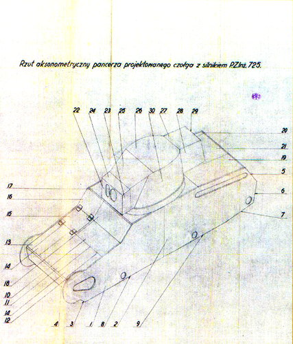

– the first, proposed by Armoured Weapons Technical Research Bureau (7TP reinforced): this modification provided newly developed Polish PzInż. 725 petrol engine (95 HP), which was smaller than the diesel one, and welded hull, of a lower profile, with a slanted front plate of the combat compartment. The brand new power plant was mounted on a right side of engine compartment (a drive shaft was also moved to right side, so it would be less an obstacle for the turret's crew). What is more, the cooling system had been significantly changed: its cooling grates were removed from an engine deck, and replaced with slots in sides. The motor's mass had an influence on reducing overall tank weight. All these qualities weighted in favour of PzInż. 725. On the other hand, the use of petrol increased the risk of fire, and tank would be ignited by direct hit. The armour, while maintaining the 7TP's weight and traction performance, was to be up to 30 mm in front and rear (vertical plates), 25 mm on a front slanted plate and the driver's hatch, and 20 mm on sides and turret. The driver was to be equipped with two G wz. 34 reversible periscopes.

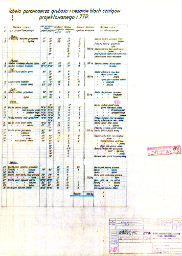

– the second, proposed by Studies Bureau of the State Engineering Works, worked by Edward Habich (7TP mod. 1939): in this variant, the PzInż. 155 engine was used. The tank hull shape was slightly different, in comparison with the 7TP; only armour thickness increased from 17 mm to 40 mm in hull front, from 17, 13 and 9 mm to 25, 20 and 13 mm respectively in sides, and from 15 to 20 mm in turret's sides and to 40 mm in turret's front. Weight also increased to 10 594 kg, so strengthened suspension (320 mm wider tracks, road wheels with replaceable rubber), and C7P tractor's transmission were proposed.
Both project were submitted for consideration in May 1939. Despite the fact that the State Engineering Works draw heavy criticism from Col. Patryk O'Brien de Lacy (the head of AWTRS), its solutions gained Armoured Weapons Command's approval. Two prototype light tanks named 7TP mod. 1939 were ordered. In July, these vehicles (with some different adjustments — the one had standard transmission, the other adopted from C7P tractor) were finally built and received by Military Technical Inspection. Since 28 July, in the Kampinos Forest, tanks had been investigated and subjected to comparative trials with the third vehicle (it was to be experimental 7TP with CT1D engine, or another prototype tank called PzInż. 725).
