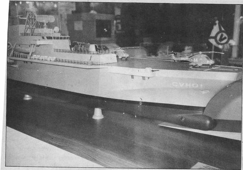

note that the news says 5000t, but the design was actually 7800t - the name was apparently "CVH01"

according to Thai magazine "Combat Zone", the specs are:
7800t
OTO-made 76mm/62 or FMC-made 127mm (Mk45?)
4x Breda 30mm twin gun
Sea Sparrow (seems to be Mk29 GMLS)
12x Harrier or Sea King
sensors system include WM-series radar (supposedly for 30mm guns) and (seems to be) SPS-49, plus bow sonar
main gun and Sparrow are controlled by what seems to be STIR 1.8
they also studied the possibility of adding ski-jump before the deal was scrapped
If I understand the drawing correctly the armaments are:
1x1 76mm or 127mm Gun as you specified,
2x2 30mm OTO-Breda Sea Cobra CIWS, or maybe the slightly older OTO-Breda Compact?
2x8 RIM-7 Sea Sparrow launchers
