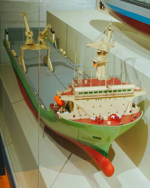

Bremer Vulkan designed two resupply vessels using SUNLOG: MPC 20 and MPC 320 (Multi Purpose Carrier). Both were based on a civilian ro-ro heavy lift ship built by Vulkan called the MV St Magnus. This ship was seen as somewhat "combat proven" because it had survived an accidental Exocet hit while in Iraq in 1985. Interestignly the same ship was later used by the US Military Sealift Command until 2011.

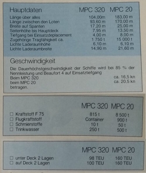

Table is translated so might contain some errors

Data | MPC 320 | MPC 20 |
Length overall | 104.00 m | 183.00 m |
Length between the perpendiculars | 93.60 m | 170.00 m |
Width on frames | 17.20 m | 25.00 m |
Side height to main deck | 7.95 m | 13.50 m |
Depth in operational displacement | 4.00 m | 8.00m |
Load capacity approx | 1 750 t | 15 000 t |
Clear loading space height | 6.10 m | 6.10 m |
Clear loading space width | 14.80 m | 21.60 m |
Cruising speed (85% power & 4 Bft) | 16.5 kn | 20.5 kn |
Fuel F 75 | 815 t | 8 500 t |
Aviation fuel | Container (?) | 900 t |
Lubricants | 10 t | 50 t |
Drinking water | 250 t | 500 t |
Containers below deck (2 layers) | 98 TEU | 160 TEU |
Containers on deck (2 layers) | 100 TEU | 160 TEU |
