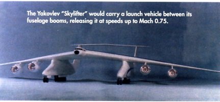

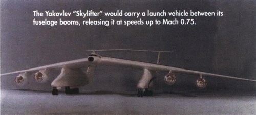

AW&ST June 12,2000 Pg 50. "Tu-160 launch program revamped to cut costs" by William B. Scott.
It is a huge double-fuselage aircraft that could launch either expendable rockets or a RLV. Projected to carry a 900,000-1 million-lb payload and launch it from altitudes up to 29,000 fet and speeds of Mach 0.65-0.75. It could also carry containerized cargo, a firefighting pod, emergency power module, or a mobile hospital/command post for disaster relief. In order to minimize costs, the outer wing sections are from an An-124 and its forward fuselage section from a Yak-40. Landing gear is derived from An-225. Cargo carriying area is 7 m high and 24 m wide
