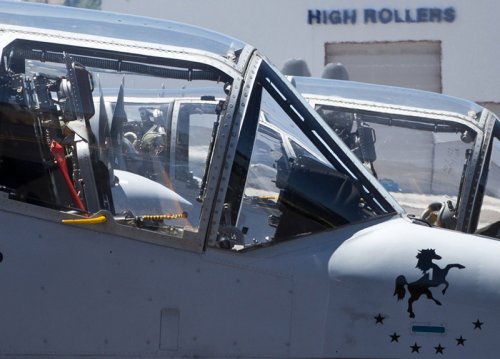

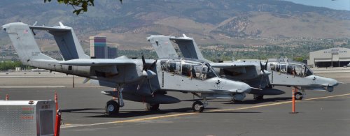

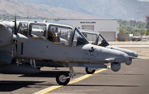

Combat Dragon II Demonstrates OV-10G+ Bronco Capabilities
Written by: Robert F. Dorr on June 13, 2013
In recent months, the U.S. special operations community has been quietly evaluating two North American OV-10G+ Bronco light combat aircraft at Naval Air Station Fallon, Nev., and at Nellis Air Force Base, Nev.
The Combat Dragon II program, a Limited Objective Experiment (LOE), is aimed at demonstrating that a small, turboprop-powered warplane can be effective in “high end/special aviation” missions of the kind encountered in Afghanistan.
The experiment seeks similar information as Imminent Fury, which used a leased A-29B Super Tucano.
Congress tried to kill Combat Dragon II 18 months ago. Today, CENTCOM’s Science and Technology Division is running the LOE in cooperation with SOCOM.

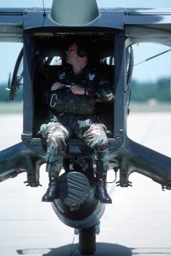

Another reason why I like the OV-10 platform is the flexability that having a large cargo bay can give you.
Besides cargo, extraction, paradrop, etc, you can use it to deploy PGMs that normally are not used from aircraft. Tests have already been done in dropping PGM Mortars. The benefit of these is more bang for the lb. With a rocket munition, 1/2 to 3/4 of the weight is propellant where all the weight is warhead with a mortar.
The cargo space in the OV-10 is incredibly small. It's not like there would be a loadmaster sitting back there chucking rounds out the rear door. When parachutists were carried, they sat on the floor one behind the other, with the first man out literally dangling his feet out the rear hatch. The tailcone was removed for this operation -- I don't think it could be opened in flight.

There is room for 5 guys in the back of the Bronco.
My point wit the space is that it adds flexibility for future capability.
On the mortar front, it would not be a person chucking them out but some sort of pallatized solution that should handle storage, programming and dropping of the mortars.
Sure, you could put five guys in there, if they were skinny (more usual load was four). But it's crazy tight.
