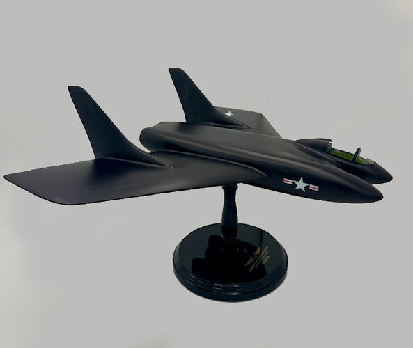

As promised, albeit late, for your enjoyment find a large scale Tandem fuselage Vought V-366H that we made for Al Casby. Wait till you see the next series that is under construction..... !

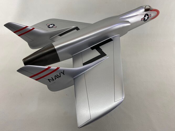

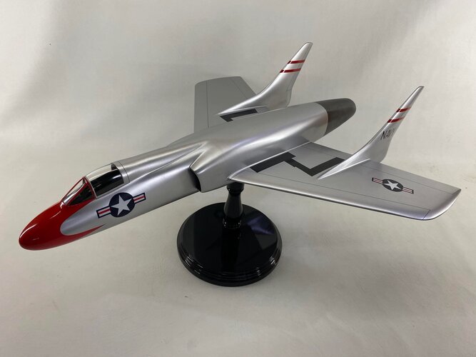

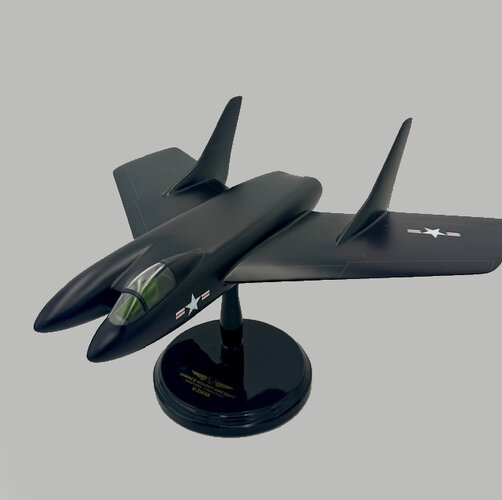

For the New Year let me present the latest of my MILITARY creations to grace both my and Al Casby's collections. If Al's name sounds familiar, Al is a great guy that actually has a REAL Cutlass that he is in the process of restoring to fly, and he collects everything Cutlass.
This is a first of 8 models we did that are rendered in 1:24 scale.
Each has a tremendous amount of attention to detail in order to represent an accurate representation of what-if the Vought Factory had actually produced these models back in the 50's.
Using extensive data taken from the actual Vought produced models Al has in his personal collection, I do think we succeeded quite well.
Up first is my one of my favs, the V-372 design proposal. Magnificent if I say so myself...... Enjoy!

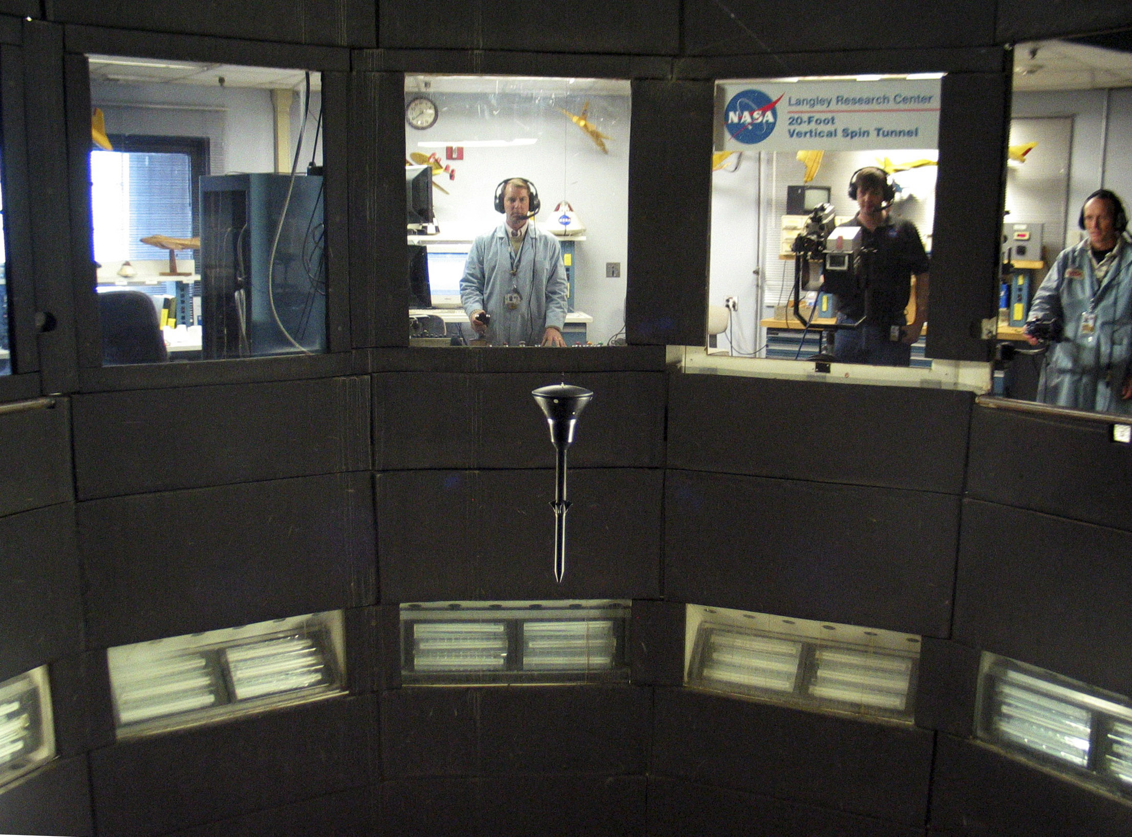

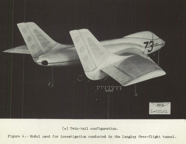

Possibly an early test model evaluation...compares twin tail to single tail.

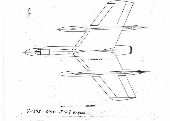

All, here is a drawing of a supersonic V-373 that Al Casby and I have that goes no further than what you see here. Bill S and Tony B are as perplexed as we are, and Bill has been looking for information for a few decades, so what the heck.......I will put it out to our collective intelligence service.... anyone out here have any more information?????
We would like to do a 3D render of this design, and although we can speculate some of the design elements, it would sure be nice if we had some additional details and hopefully even a 3 view to do our model from. Vought V-373 2.jpg
Used for spin testing in the vertical spin tunnel at NACA Langley.
