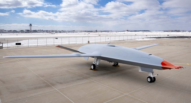

TomcatViP
Hellcat
Feb 12, 2017
2,603
1,127
The X-47 IMOHO was less ready to fight at sea. Bring back performances (carrier recovery) would have been more tricky thanks to the lack of verticals.
Also the MQ-25 is a far less multi-mission platform, eating less budget and maintenance hours for the carrier force on overall.
I think the USN made an outstanding choice going nimbler on the mission set. Ppl on another thread are discussing F-111 and that should be read in context here.
Then, with all that Fuel, a full composite airframe, large span and available power, I have no doubt that the MQ could become something more spicy via Pods or conformal packs.
