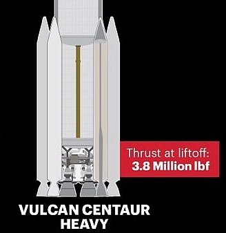

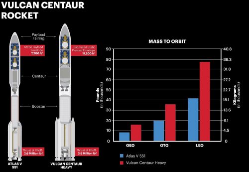

Cutaway layouts of Vulcan from Tory Bruno twitter (CEO of ULA). Vulcan is supposed to have a detachable engine pod holding both the engines and most of the main booster avionics. Plus the inflatable decelerator and the parachutes.
You can see features like the single bulkhead between the oxidizer/propellant tanks but it isn’t obvious where excess room has been reserved for the recovery hardware for the engine pod. You would also need extra plumbing for the quick disconnects from the tanks. I would think ULA wouldn’t want to spend extra money to do 2 separate designs using a conventional/nonrecoverable configuration for initial launches. Unless they weren't really serious.

fredymac said:
two highly divergent designs in something as fundamental as the interface to the main engines (and the load bearing/transfer structure) can’t be trivial.
They aren't divergent much less highly.
When you mount the engines in a separate pod they become like a lower stage and will probably interface in a similar way with load bearing structures on both sides of the divide. Looking at pod mounted jet engines on an airliner you also see an intermediate load transfer structure. Just as a casual observer there are a lot of details that come mind. Much more so than say strapping three Falcon 9's together. At a minimum, the mechanical arrangement is more complex and I don't see how that doesn't impact load transfer. Of course, if ULA just released some high level drawings that would settle the matter.

The ULA business structure may be a serious flaw. For ULA to finance and develop new hardware requires investments from Lockheed and Boeing. Both of them have principal market priorities elsewhere (defense, commercial airlines). ULA is a marriage of convenience in a market segment neither has been willing to back with significant IR&D. A totally conventional (throw away) Vulcan may be in development but there doesn't seem to be any real enthusiasm behind it. Now that Spacex has developed beyond the point where its viability is in doubt, the "hedge" value of ULA as a low tech standby has ended and it seems to be coasting until corporate momentum runs out. This is my cynical take but its backed by 40 years of observation.
DrRansom said:
1 - does the Falcon heavy have the same payload capacity as the proposed Vulcan rocket? If the Vulcan can get a niche at the high-mass range, above a Falcon 9 blk 5 and below a theoretical BFR then there may be a market.
If BFR actually pans out as SpaceX envisions it to, there is no room in the market below it at all. Well, if you need to launch a single cubesat or a beach ball, Electron or something disposable and 3d-printed might be competitive, but all practical satellites, even when launched alone, will be cheapest to launch on a BFR. The reason for this is that BFR will have enough delta-v to deliver the satellite directly to it's final orbit, including the circularization burn of a geostationary satellite, and then recover both stages, to be used again in a day. With enough re-use, the cost of a single launch will fall below the cost of light launchers, because SpaceX won't even have to rebuild their upper stages.
If you had told me the current BFR plans 5 years ago, I'd have laughed in your face. Right now, I don't know...
sferrin said:
Falcon Heavy is about double Vulcan.
The current practical weight of a satellite that FH can lift is below what a Vulcan can lift, because the current payload attach fitting limits payloads to 10,886kg. This could probably change should a customer pay enough for it, but there is not exactly a huge market in super-heavy satellites, so the cost might be enough to make a Vulcan launch competitive.
The added power of FH is more realistically used to send 10-ton NASA payloads further than it is to send 60-ton payloads to LEO. Also, reusable block 5 FH to geo is probably cheaper and gives you a better transfer orbit than block 5 F9 disposable.
Point is the capability is there if somebody wants to take advantage of it.

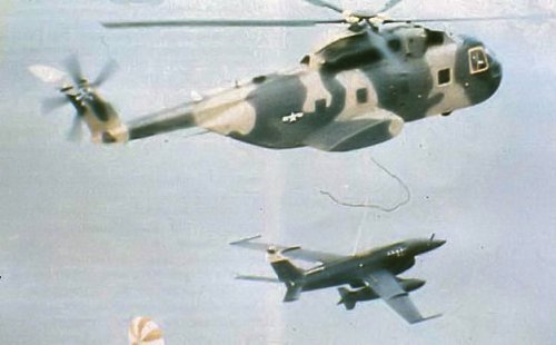

As for a Helo recovery limiting the mass that can be recovered, I thought that as well. But then I thought most midair parachute grabs that have been done in the past have used aircraft, so a C130 or C17 or C5 or even a big Ant would enable quite a heavy mass to be recovered at a reasonable distance. But I wonder what the FAA safety/cert case for this looks like.
I also think recovery of parachute with a Helo will not be easy. The risk is that the rotor down draft will collapse the canopy, even a ram air type, just as contact is being made;- just ask anyone who’s flown a parapente in moderatel turbulence.....they fold, twist up into a knot and drop like a stone..... then you cut away to deploy the reserve. I know this has been demonstrated with little canopies and a small Helo’s for the Genesis mission (the attempted real recovery failed) so I’m not claiming it’s impossible. I might have expected to have seen a practice work up under way.
It has been done thousands of times with drone recovery.
