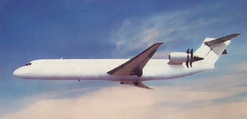

"P-9"- McDD candidate for the LRAACA competition in the 1980s/90s based on a UHB powered version of the MD-87 I think. I haven't found any pics of it, but from what I recall of AWST issues from that time, it had a lower lobe weapons bay, lengthened nose for the search radar, and a MAD boom projecting aft from the horizontal tailplane/fin junction.

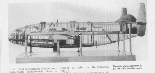

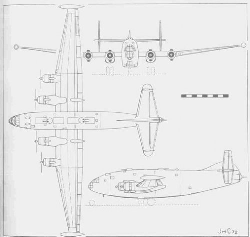

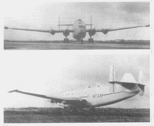

A lttle bit older than the previous : The Breguet Br.764, an ASW version of the Br.761/
763 series :
Don't get fooled by the first picture, it wasn't more than a flying mock-up, based on
the standard Br.761.
(All pictures from :Jean Cuny "Les Avions De Combat Francais 1944 - 60")

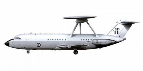

Heres a couple of good ones from Stephen Skinners book "BAC One -Eleven, The Whole Story"
The first is a 1-11 400 for the Japanese self defense force, with a new wing, extra wing mounted Adour engines, enlarged nose radar, towed mad bird and weapons bay.
The second is a 1970 proposal for an AEW version for the RAF...

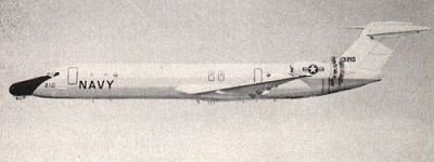

Found this on the McDonnell Douglas entry for the US Navy's LRAACA competition:
P-9D LRAACA Proposal. In one of the most hotly contested military aircraft programs in recent times, McDonnell Douglas proposed a GE36 propfan-powered variant of either the MD-87 or the planned MD-91 for the US Navy’s Long Range Air ASW Capable Aircraft (LRAACA) requirement. Approximately 120 aircraft would be needed as replacements for current Lockheed P-3Cs. Lockheed proposed a turboprop-powered P-3 variant, while Boeing proposed a version of its 757. The Navy selected Lockheed’s improved P-3, powered by General Electric GE38 advanced turboprop engines. This project was canceled by the Navy in December 1989.

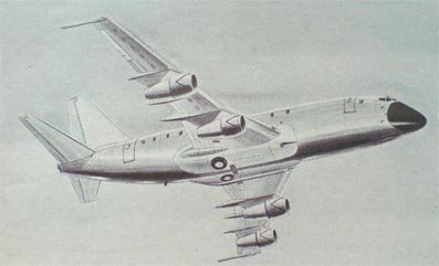

The there was the late 1960s? early 1970s? Boeing proposal for Japan that was based on the 737, with four TF34s and a lowered nose, as I recall...

Anyone got any other pics of the "P-9" McDD entry? I seem to recall that there was one design iteration that had a lower lobe weapons bay under the forward fuselage just ahead of the wing but it didn't go the full length of the forward fuselage. I also recall a MAD boom that extended from the junction of the vertical fin and tailplane and possibly some sort of HF antenna jutting foward?
Here it goes, the P-9D beast from March, 7 1988 Aviation Week. Oh these damn dusty old magazines.
This is unbuilt ASW version of unbuilt airliner (MD-91). Funny.
Please find attached a "Flight" drawing of the Boeing 737-ASW as proposed for Japan's P-XL requirement. Source for this is Flight International, 21st Feb 1974. I can supply the article if anyone wants it.

Another picture of the Boeing 737PXL proposal
(from Aviation Week 1974_6-12)

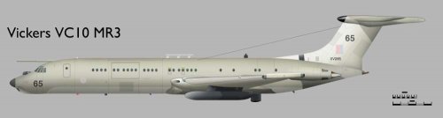

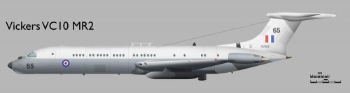

IIRC there BAC proposed versions of the VC10 and Vanguard for what eventually became the Nimrod. The VC 10 would have had a glass nose and weapons paniers under the wings...
If anyone has info on either of these projects id be very grateful..!
Zeb
[Resized pic to be smaller: Overscan]
Reminds me very much of the new P-X! ;)

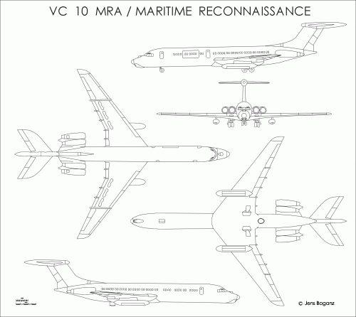

"BAC proposed versions of the VC10 "
Sorry, still nothing for the Vanguard ...
< Sorry for the 737PXL pic, clicked accidentally the
wrong, not resized file ... :-[ >
A reason i've read for rejecting a VC10 varient was it was too big - couldn't they fuselage have been shortened?
If a VC10 varient is chosen them what effect does that have on the attempted AEW program - can an aft scanner be safetly fitted to a tail mounted engine design and if not and a mast mounted system is tried, will the computer system be better able to cope with this rather than trying to coordinate two seperate scanners?
Oh that is fantastic.. just what I needed...! Im assuming that the MAD equipment is housed in the elongated tail bullett...?
As for an Aew version... I wonder how similar to the AEW 1-11 i posted earlier in the thread it would be...?

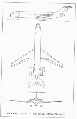

Doing a little more reading I think there was a 1-11/VC10 crossbread proposed... 1-11 fuselage, VC10 wings and 4 engines... anybody have any data on that...?

Sounds like the VC-11 - its in 'Stuck on the Drawing Board' but I'm away form my books at the moment.
From R.Payne "Stuck on the drawing board" :
[I've resized the image to conform to the 600 pixels rule. "Stuck on the Drawing Board" is easily available and we should encourage purchase of this book - Overscan]
