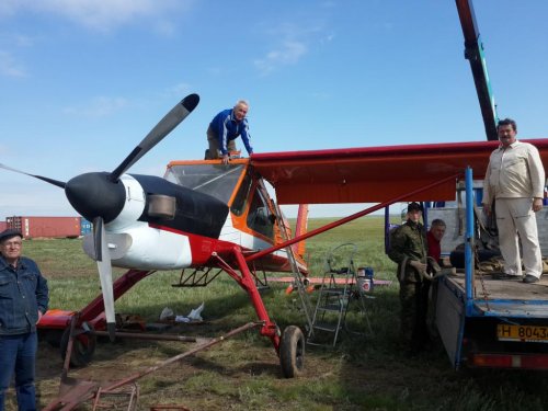

Has anyone mentioned the Russian-built Technavia SM-92?
It's airframe looks like a Brossard with a swept rudder stolen from a Turbo-Beaver. Finist competes directly with Beavers and Brossards and Porters.
Like the Sukhoi 26 conversion - that started this thread - the Finist started with a Vedeneyev radial engine but eventually acquired a Walter 601 turboprop.
Several Finists have worked as jump-planes on Europe. Most recently, a Turbo Finist crashed in Italy after its engine failed. Fortunately, good piloting skills and good seat belts limited injuries.

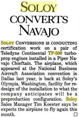

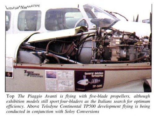

Digging for more details, but Soloy flew a Navajo Chieftain in 1989 or earlier re-engined with a pair of the obscure Teledyne-Continental TP-500E turboprops of 510 shp each.
All I've found so far is the TCDS for the engine, FAA reference E6SO.
Update: and a nacelle photo from Flight in November 1988. Seems to have been displayed at the NBAA convention that year.
Update 2: Flying Magazine, June 1989

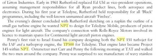

The TP-500 engine was a licensed development based on an original design by UK company Noel Penny Turbines ( see third attachment, extract from book The Nearly Engine ). Flicking through Jane's of the 1980s reveals that the engine was "first flown in a Cheyenne II on 29 September 1982" and Flight notes that it languished for another six years before certification due to market conditions. Also some references that Air Mod was planning a conversion of the Baron with a pair of TP-500s but the engine appears to have sunk into oblivion by the 1990s, possibly due to the collapse of the Penny company in the late 1980s.
Update 3: The airframe involved was PA-31-350 c/n 31-7852108 which at the time was N83CF. Subsequently de-converted back to piston-power and continues to fly in 2015 as N369KJ. Doesn't look like Soloy made it as far as an STC for the conversion.

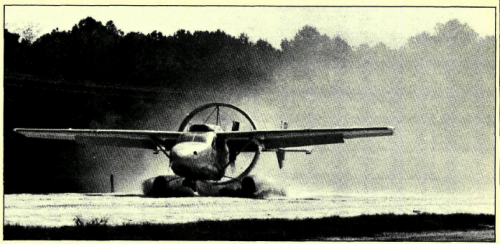

O-2T Sandcrab:
Source
Is this connected to the 'Mississippi Marvel' program at all... ? ::)
cheers,
Robin.

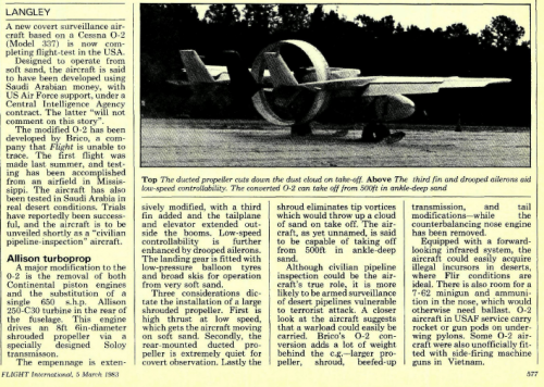

That TP O-2, especially the one in the painting, is very cool looking. As for the duct, it just looks like more weight and drag than it's worth. Of course, maybe being quiet was more important than performance for the Sandcrab?
The following attachments are taken from 'Flight, March 5th, 1983'
With regard to the Mississippi Marvel, I believe a modified version was built to compete for the same requirement.
Colin

The article about the Cessna O-2ST "Sandcrab" seems to indicate funding by Saudi Arabia.
Another source online claims the type was developed for Iran...
Who's right? Who's wrong?

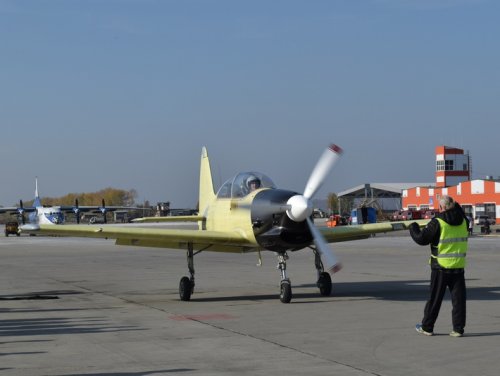

Maiden flight !
Isn't the Yak-152 powered by an aero-diesel engine rather than a turboprop?
It's also a new design.
Correct:
http://eng.irkut.com/products/74/
http://www.ainonline.com/aviation-news/defense/2016-06-22/new-yak-152-trainer-will-come-alternate-powerplants

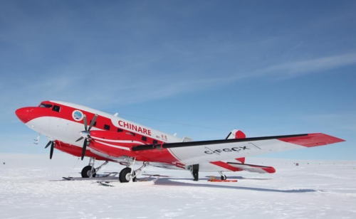

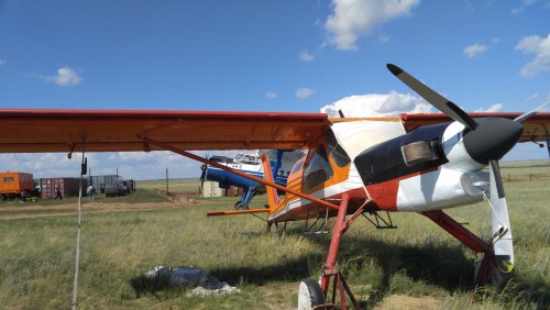

In the Chinese press recently (http://www.chinadaily.com.cn/china/2017-01/09/content_27898575.htm) was the Xueying 601 Snow Eagle, which, according to the registration, is a Basler BT-67 turbo conversion of a Douglas DC-3.

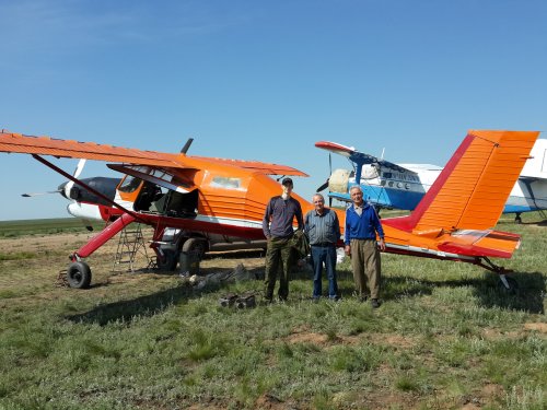

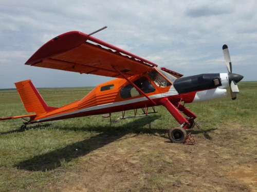

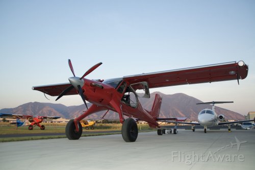

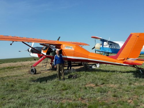

@Apophenia, cannot find this conversion in the lists - maybe a new entrant: PZL-104 with Walter M601 turboprop, now located in Kazakhstan. See http://www.airplanemart.com/aircraft-for-sale/Single-Engine-TurboProp/1986-PZL-104-Turbine-conv/13074/.

TsrJoe said:
Scottish Aviation turbo Pioneer
Thank you! Very interesting.
IMHO, this couldn't be threated as "turbo conversion", however.
It's not just a change of pistons fro turboprops, but entire wing, empennage, undercarriage.
Degree of similarity with Twin Pioneer is the same, as between Basler BT-67 and C-47 :cool:
