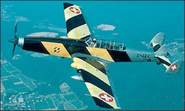

Around 1992 a Bücker Bü 133 Jungmeister was fitted with an Allison turboprop engine.
If somebody is interested, I would dive into my FLUG REVUE piles to find pictures and detailed information.

Re: the 250-powered Bü 133. I'd love to see an image! Ditto for that turboprop Stearman.

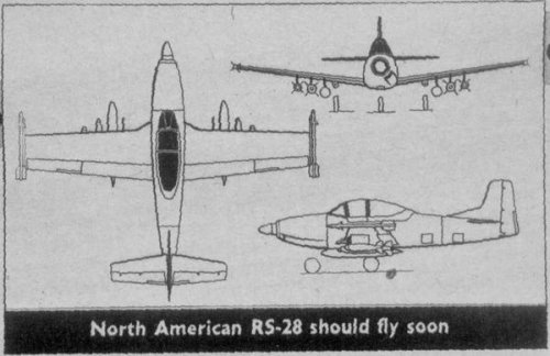

Ray had already shown this type, just found a 3-view in RAF Flying Review
January 1963 of the North American RS-28 (or YAT-28) :
Nice one Jens.
Interesting that both the NA-284/RS-28/YAT-28E and the AIDC T-CH-1 Chung Hsing both used Lycoming turboprops -- YT-55L and T53-L-701 respectively. Obviously, the 2445 shp RS-28 would have been much more potent.
Does anyone know if the T-CH-1 a conversion or new-build?
Here is the ‘beast’ – air-to-air picture is from FLUG REVUE 1/1992, turboprop Bücker on the ground was published in No. 4/1992 of the same magazine. Sam Burgess from New Braunfels/Texas was the man behind the machine. The idea was born, when he saw Doug Champlin’s Great Lakes X2T-1T (http://www.airbum.com/pireps/PirepGreatLksTrbn.html) in the beginning of the 1980’s. First flight was on 8th August 1989. For a while the turbo-prop Bücker was the world record holder in its class (http://records.fai.org/general_aviation/history.asp?id1=18&id2=39&id3=3) .

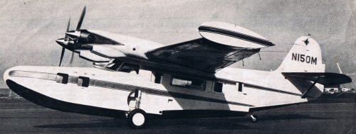

-Mc Kinnon Turbo Goose from "Aviation Magazine" 1967 (N150M)

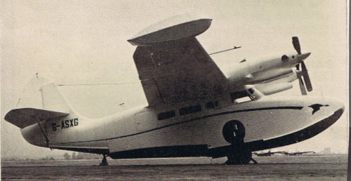

-Marshall Goose from "Flying Review" 1970 (G-ASXG)

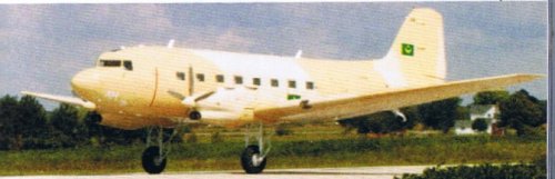

-Basler Aviation BT-67 from the excellent "Flugzeuge der Welt 2007"

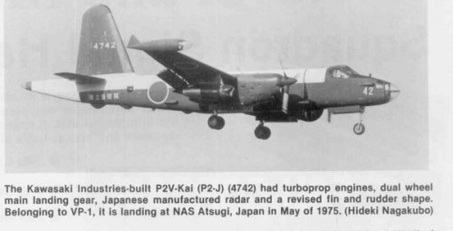

The Kawasaki built P2V-Kai, the japanese version of the Lockheed Neptune.
(from Squadron Signal N° 68)
Okay, thanks Jens.

Back again to the Turbo-Canso: a Consolidated PBY-5A "Canso" has been converted to turboprops by a company named Trans-Caribbean at the Bahamas.
SOURCE: Jane's 1970-1971
PS: Trans-Caribbean company wasn't mentioned in Bill Gunston's "Aircraft Manufacturers" book ...
