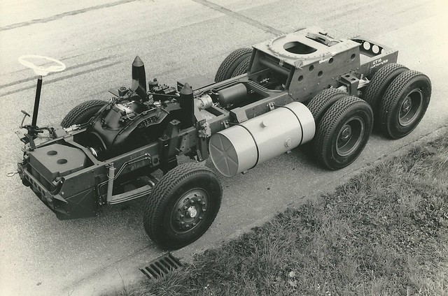

In 1972, 3-6 lorries with the 28/350/R turbine (a development of the 2s/350, it seems, with 350-400 shp) were built and used by several companies:
A 1968 prototype of this series survives today:
Gas turbine installation:

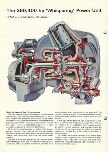

Attached a page from the brochure with a cutaway of the engine.
