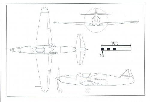

As to the XP-57 definitive information is also lacking and the 3-views are very suspect, especially as every one out there is either a direct copy or a redraw of Lloyd S. Jones drawing from his U.S. Fighters which was first published in 1975. Who knows what his source was, the drawing also has the problem that it only shows four exhaust stacks on the sideview of the port side, the plan view drawing is in his typical style with the top and bottom both shown in the view this also shows four exhausts, the front view indicates stacks on both sides which has led folks to redraw the Jones drawing into what you see in the drawing that started this topic. The plan view in the Norton drawing shows four exhausts each side in a typical V-8 engine setup, yet his text claims a V-12. The L-510 is an inline 8 cylinder engine made up of two 4 cylinder engines mounted inline, which means that it's going to have all of the exhaust stacks on one side of the fuselage and the induction system on the other.

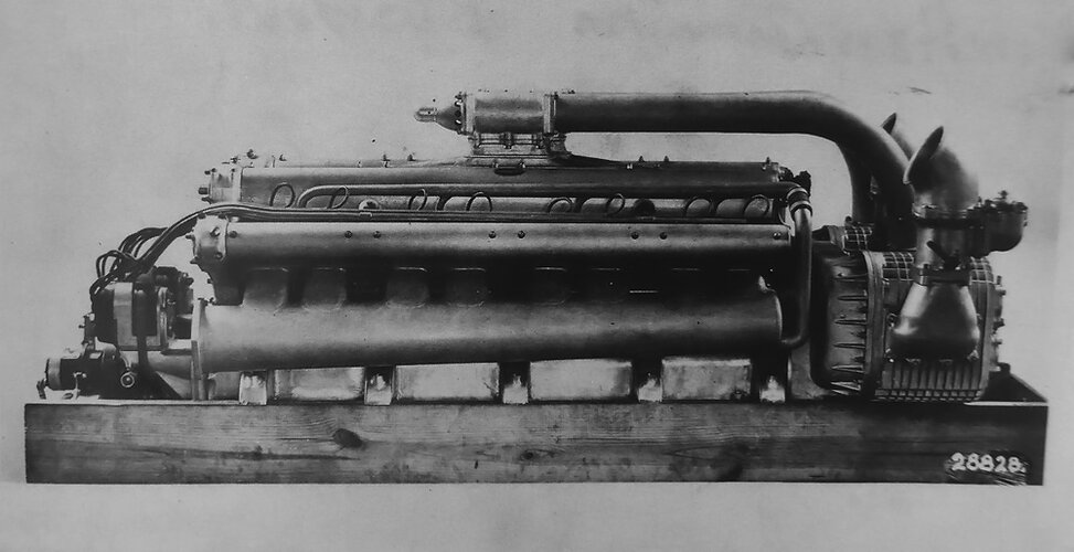

I think it would depend on how the two engines were combined. If the two four-cylinder units were mounted nose-to-nose on a common gearbox, there might conceivably be four exhaust stacks on each side.

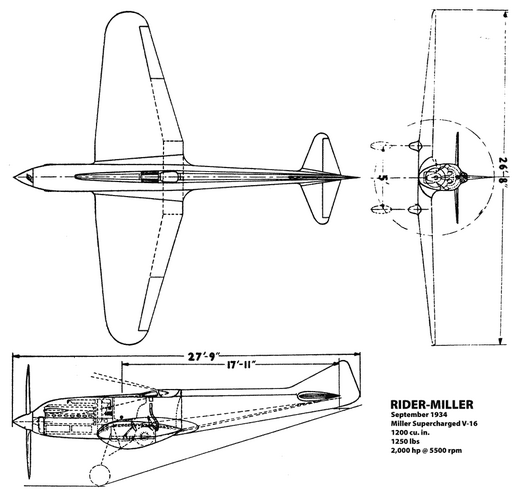

were recycled by Tucker. Harry's horsepower numbers were rather optimistic, to say the least. MILLER_IV-1200_01.png

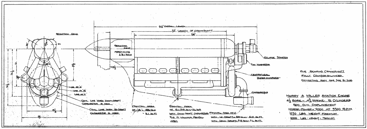

Inverted V-16, 1200 cu.in, 2,000hp.

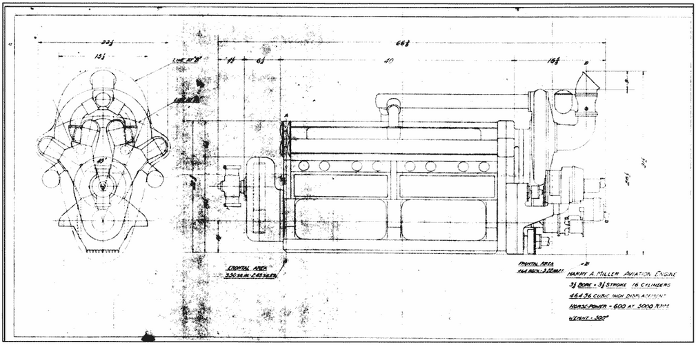

V-16, 464.5 cu.in., 600 hp.
V-16 for Keith Rider.
Yep, I've played with various layouts including that one, but according to Mark Dees the crankshafts of the two
engines were connected together. The biggest problem the opposite handed notion is that the rear engine will
have its intake downstream of the exhaust of the other engine. That would make cooling the compressed
fuel and air mix more complicated.

According to the author, no original drawing of the Tucker fighter was found.

were recycled by Tucker. Harry's horsepower numbers were rather optimistic, to say the least.View attachment 707320
2,000 horsepower from only 1,200 cubic inches sounds optimistic. You might be able to supercharge a race engine to that level for a few minutes, but I doubt if the engine would last very long.
Secondly, that 3-view drawing is obviously for a specialized race plane. 1930s race planes were notoriously difficult to control at slow air speeds with their small control surfaces and poor visibility from the cockpit.
That's screamingly optimistic for engines then. Most aircraft engines were still working towards one hp per cubic inch, even the mighty Merlin was 1500hp out of 1650cubic inches.
2,000 horsepower from only 1,200 cubic inches sounds optimistic. You might be able to supercharge a race engine to that level for a few minut s, but I doubt if the engine would last very long.
Yes, I know thus why I stated it was for Keith Rider.

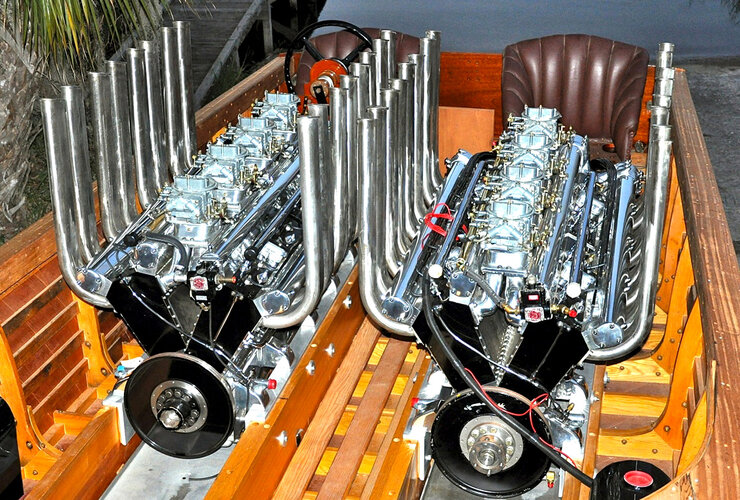

Very optimistic numbers apparently based on the idea that as they achieved up to 250hp, at 8,000rpm, with the supercharged 91 cu.in. Miller 91 I-8 engine and that the two supercharged 1,113 cu.in. V-16s that Miller and Leo Goosen designed for Gar Wood in 1931 achieved 1,325hp at 4,000rpm and 1,800 at 6,000rpm. But, in the case of the Wood engines this was with massive Schweizer-Cummins Roots-type superchargers and the engines were never fully reliable. The engines were sold on by Wood and operated in naturally aspirated form, making 930hp at 4,500 rpm. Both engines survived and have been restored and installed in the restored Gar Wood Miss America VIII. The angle between the cylinder banks is 54º. BTW design of the engine started at the end of May - early June 1931 and the first engine run was on 25 August 1931.
In some ways the numbers for the 464.5 cu.in. and 1,200 cu.in. V-16s are conservative.
As run by Wood.
Naturally aspirated as installed in the restored Miss America VIII.
Might be achievable if they spun that fast, I was not expecting 4500+rpm out of a large displacement aircraft engine and then reduced to ~2000rpm at the prop.

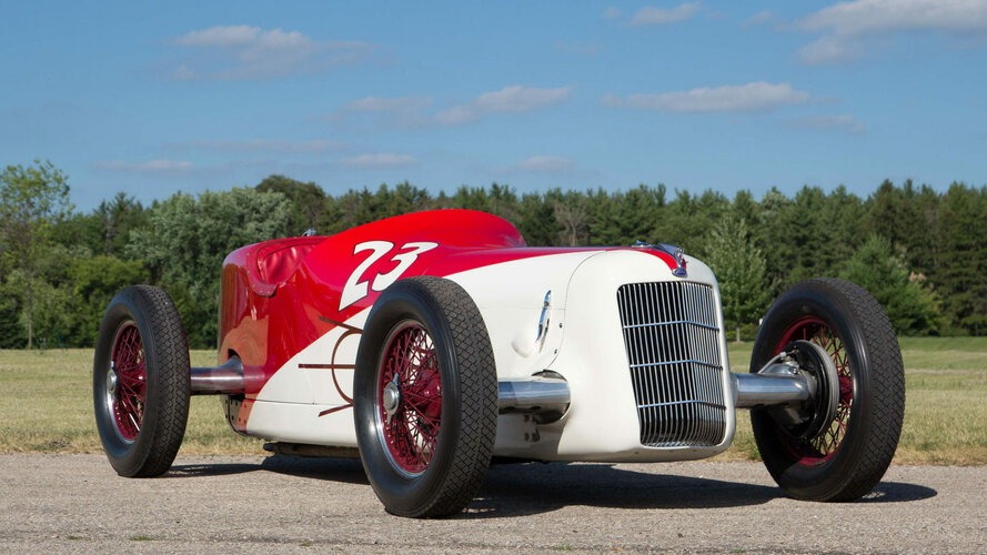

He was involved in the Miller-Ford Indy cars, he convinced Edsel Ford to fund them, and promised in early
1935 that ten cars would be ready for the Indy 500 on 31 May 1935. This was a front-wheel drive design
powered by the Ford flathead V-8. Due to typical Tucker overpromising and dithering they weren't actually
able to get started until March of 1935. Needless to say they didn't have the time to do proper testing and
it was found that the steering boxes were mounted too close to the exhaust manifold causing them to overheat
and fail. Tucker's name was mud with Henry Ford but Ford never held the failure of the program against
Harry. The cars were beautiful and very advanced on several levels.
Tucker's promotional BS for his car puffed up his connections to Miller's pre-war race cars, going from the
fact of his involvement with the Ford project to the stretch that he was involved with all of Harry's successful
engines of the '20s and '30s which had won 12 out of 16 Indy 500s between 1922 and 1938. This was BS.
1935 Miller-Ford.
The drive ratio of the 7" centrifugal supercharger of the Miller 91 was 5.35:1, 42,800rpm at 8,000rpm, so yeah he liked things to be spinning fast.
