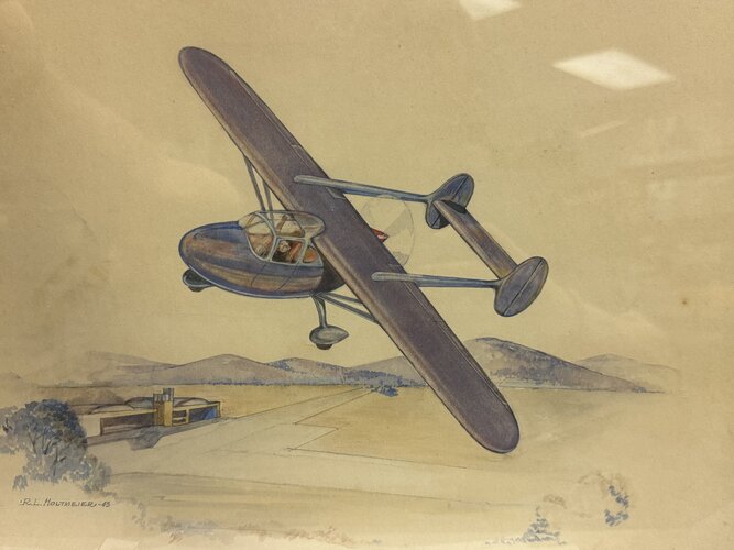

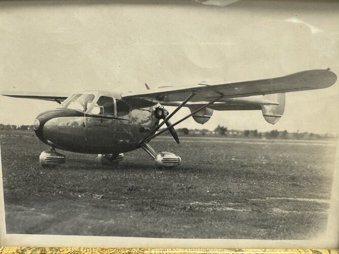

the American Company Trella,designed and built several aircraft.from T-10,T-17 up to T-21,
and from T-100 up to T-107,I ask about two designed,the T-105 which developed from T-104
but never finished,and the T-107,which reach only to a mock-up stage and modified from
T-106 twin boom pusher high wing aircraft,if someone has a drawings or pictures to them?,
thanks in advanced.

My dear Jemiba,
I asked about the two unbuilt projects,that's all.

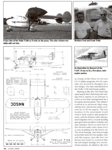

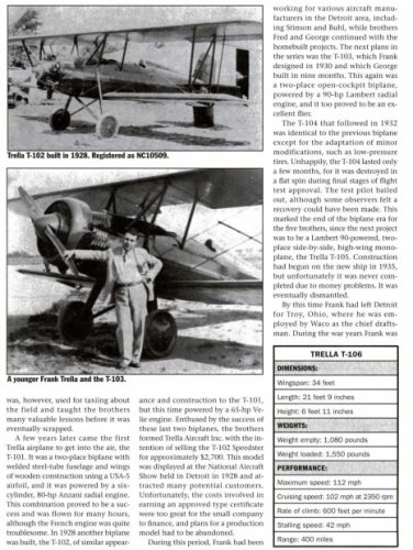

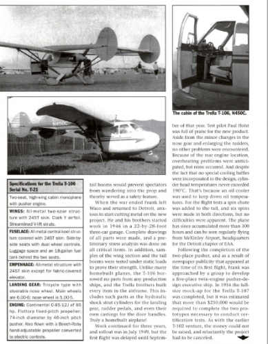

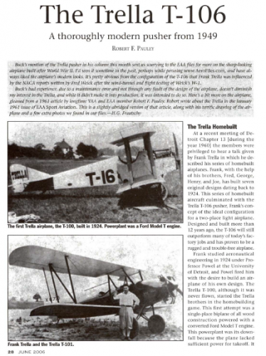

here is a story about Trella aircraft;
http://members.eaavintage.org/wp-content/uploads/2013/02/VA-Vol-34-No-6-June-2006.pdf

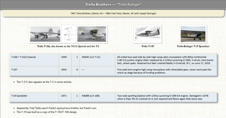

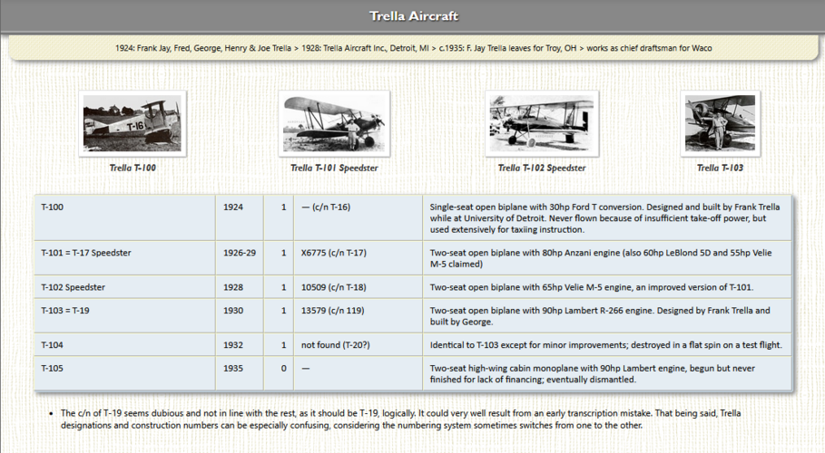

Trella designations are confusing, because at times the individual aircraft are refered to by their designation (T-100, etc.) and at other times by their construction number (T-16, etc.)
If both systems are coherent, the Models went from T-100 to T-107 and the c/ns from T-16 to T-21: Seven models designed, only five aircraft built... Yet I have counted six airplanes completed, and conflicting info. I've tried to make sense of all the info I had at my disposal (including the Vintage Airplane article) for the Trella page of my upcoming website, but quite frankly, it's still pretty confusing! I've removed my previous list to update it with the latest info. Here's a recap of what we have so far:
  • T-100 was c/n T-16. It says so clearly on the side of the fuselage. It was was built in 1924, taxied but never flown because of underpowered 30hp converted Ford T engine.
  • T-101 Speedster was c/n T-17 [X6775]. It was a two-seat biplane of 1926 with an 80hp Anzani engine. T-17 has also been quoted with 60hp LeBlond 5D and 55hp Velie M-5 engines, though the latter is likely a confusion with T-102 below.
  • T-102 Speedster was c/n T-18 [NC10509]. It was a 1928 improved version of T-101 of with a 65hp Velie engine.
  • T-103 had an unidentified c/n. It was a two-seat open biplane with 90hp Lambert engine. If the T-103 was "an excellent flier", how come it doesn't show up on registers?
  • T-104 had an unidentified c/n. It was identical to T-103 except for minor improvements but was destroyed in a crash while on a test flight. Perhaps it was simply the T-103 modified?
  • T-105 was probably c/n T-20. It was a two-seat high-wing cabin monoplane with a 90hp Lambert engine; it was begun, never finished and eventually dismantled.
  • T-106 was c/n T-21 [N450C] was an all-metal two-seat high-wing cabin monoplane with 85hp Continental C-85-12J pusher engine. It has also been refered to as the T-21C Special in some sources.
  • T-107 was only a project, a five-seat retractable gear twin-engine derivative of T-106, only built in mock-up form for lack of funding.

STOP PRESS! Just happened on a description of the Trella T-19 (from Jane's 1972-73), which confirms some theories and invalidates others.
TRELLA T-19
Mr Fred Trella of Warren, Michigan, has designed a two-seat sporting biplane designated T-19, which he has built in partnership with Mr Joseph Bolinger. Construction began in May 1966 and occupied five years, at a cost of $4,000. First flight was made in July 1971, and it is anticipated that plans of the T-19 will be made available to amateur constructors. Earlier, Mr Trella designed and built a two-seat cabin monoplane designated T-106.
Type: Two-seat home-built sporting biplane.
Wings: Braced single-bay biplane, with Vee-type interplane struts each side.
Centre-section of upper wing supported by inverted Vee-strut forward and single strut aft on each side of cabane.
Streamline-section landing and flying wires.
Conventional two-spar structures with solid wood spars, wood truss ribs and fabric covering.
Plain ailerons of wooden construction with fabric covering on both wings.
Cut-out in trailing-edge of upper wing. No flaps. No trim tabs.
Fuselage: Welded steel-tube structure, with fabric covering.
Tail Unit: Wire-braced welded steel-tube structure, with fabric covering.
Landing gear: Non-retractable tailwheel type. Main wheels carried on tripod struts, with internal shock absorption in main legs.
Power Plant: One 125 hp Lycoming O-290-G4 four-cylinder horizontally-opposed air-cooled engine, driving a two-blade fixed-pitch propeller with spinner.
Accomodation: Two seats in tandem in open cockpits.
Dimensions, external:
- Wing span, upper ................... 27 ft 6 in (8.38 m)
- Wing chord, both constant ..... 4 ft 0 in (1.22 m)
- Length overall ......................... 20 ft 0 in (6.10 m)
- Height overall .......................... 8 ft 0 in (2.44 m)
Weights and Loading:
- Weight empty .......................... 1,096 lb (497 kg)
- Max T-O weight ........................ 1,607 lb (729 kg)
- Max power loading .................. 12-8 lb/hp (5-8 kg/bp)
Performance (at max T-O weight):
- Max level speed ........................ 87 knots (100 mph; 161 km/h)
- Cruising speed ............................ 82.5 knots (95 mph; 153 km/h)
- Landing speed ............................ 35 knots (40 mph; 64 km/h)
- T-O run ........................................ 300 ft (91 m)
- Landing run ................................ 500 ft (152 m)
- Endurance .................................. 3 hours
What this teaches us is that the T-19 of 1971 was from FRED Trella, one of the brothers of Frank, who did all the early designs.
The partnership was with a Mr. JOSEPH BOLINGER (one "L", so the spelling was correct after all), so no connection with Lynn L. Bollinger here.
We learn also that this was indeed a newly-built aircraft, coming after the unbuilt T-107 in the sequence of designs. Its c/n 108 is therefore logical, somehow.
I'll venture that the designation T-19 was chosen because the aircraft must have been a near duplicate of the original c/n T-19, which I'm now positive WAS the Model T-103, since the latter was described in the article as having a Lambert engine!

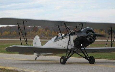

Hello Gentlemen :)
Very nice and entertaining info on the Trella designs. Was ready to give some additional info on the T-19, but
Skyblazer was first ! Fred Trella and Joseph Bolingers were indeed the builders.
What I can add is that the engine almost certainly was the Lycoming. If you "blow up" attached photo there are no real signs of a radial engine. And the T-19 was indeed damaged in a 1978 incident, but she was rebuilt and remained active for many more years. N3089 was being offered for sale in 2011 (barnstormers.com?). First flight was in July 1971 and from my notes it seems that the T-19 was at least based on/derived from a 1932 design of father Frank Trella.
walter said:
Hello Gentlemen :)
Very nice and entertaining info on the Trella designs. Was ready to give some additional info on the T-19, but Skyblazer was first !
Ah, but you provided a photo of it, which more than makes up for it! I'd been desperately trying to locate one unsuccessfully! Thanks a lot for this.
Further research tonight showed me that indeed [N3089] took another airworthiness test in 1978 and was active until 2008.
My hunch that it was directly inspired by the original T-103 seems correct, though the latter was built in 1930.
However, as I said before, the T-104 of 1932 may very well have been the same aircraft modified...

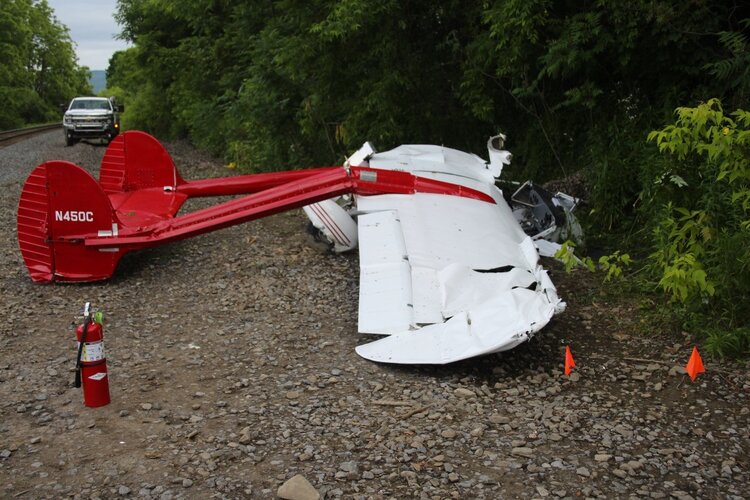

May I add that the sole T-21/T-21C as it was referred to in one of the earlier posts, was destroyed in an accident, following a five year restoration in 2019, resulting in the death of the pilot. Here is the sad remains, pic courtesy of the NTSB. For more details see https://aviation-safety.net/wikibase/226284
