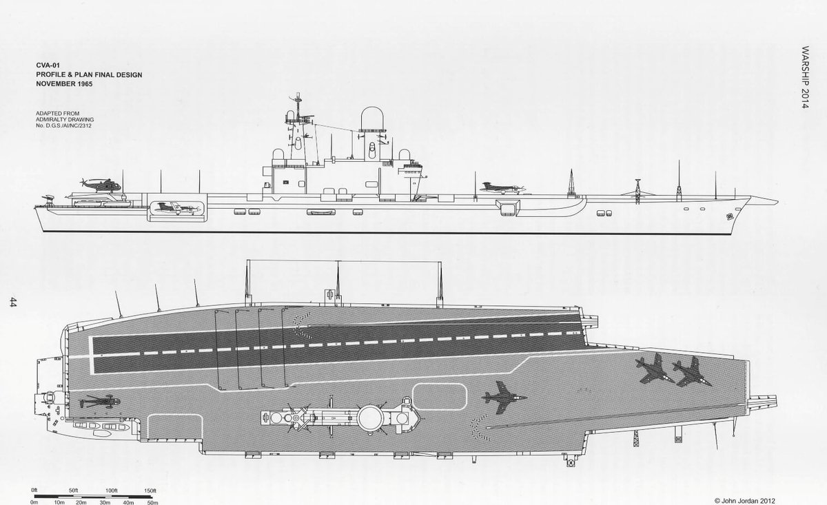

If CV force retained on CVA-01 and CVA-02, perhaps with a planned CVA-03....
What RAF assets were tasked with say Kola Peninsula, Murmansk et al?
What RAF assets were tasked with Coastal Command?
What was the GIUK Gap assets ?
Do you need RAF to perform these tasks or was the FAA doing them before CV force scrapped?
Another thought. Strike North lives with USN getting real support from CVA-01 and RN.
Lofoten Bastion might be more cramped but more potent a threat.
This sucks Soviet resources to deal with that threat away from elsewhere.
AEW.....this becomes Nimrod and Argus I think it was called?
Imagine all that money sunk into the UK system that never made it beyond development, put into CVA-01 aircraft.......
