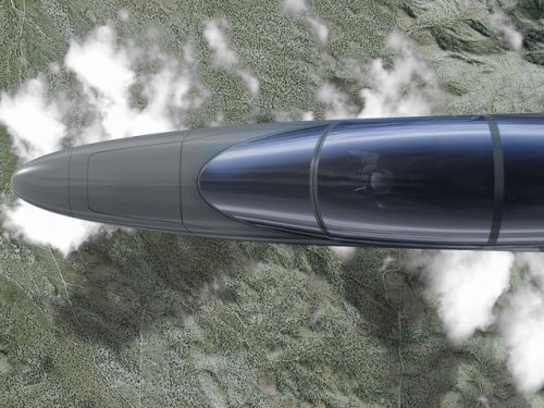

Boeing/SAAB T-X
Holy crap, they're building the same airplane. One just has a slightly different radome radius than the other. Hey Boeing SAAB and NG, thanks for revealing the designs would have a nose and a two place tandem cockpit, we would have never guessed that! ::)
Triton said:
Hey Boeing-Saab and Northrop Grumman! You're such a tease! ;)
A T-X strip tease war? See who reveals a little more first? ;)

The Northrop Grumman entry reminds me a lot of the Cessna 526 CitationJet for JPATS.
I know T-X is not foremost a marketing exercise, but if they're running the cloak and dagger routine but have an aircraft which doesn't match the hype at first look, they're just setting up a whole bunch of "meh" reactions from the defense press. I don't mean to single out NG, the Boeing-SAAB team seems to be running a similar play.

I think that's the point I was trying to make, and poorly. The "big reveal" is sorta pointless when you're talking T-X, barring a truly out-there design, yet B-S and NG are both playing games with teaser images and "no pictures allowed" press events. Seems like a waste, especially when they finally pull back the cover and the reaction is "....and?"
