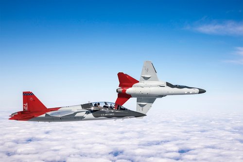

George Allegrezza said:
Reuters is reporting a Boeing win.
It's official now.
https://mobile.twitter.com/BoeingDefense/status/1045405825907527680
“Thank you, @USAirForce. We’re honored and excited to deliver #NewBoeingTX for future generations of pilots, trainers and maintainers!”
@BoeingDefense CEO Leanne Caret (link: http://Boeing.com/T-X) Boeing.com/T-X

I'm not really surprised. Boeing is going hard on low cost in all of these recent wins. Their TX is very minimalist compared to the high-spec T-50, so it should be very cheap compared to the Lockheed option. (The Leonardo T-100 was never serious once Raytheon dropped out.)
