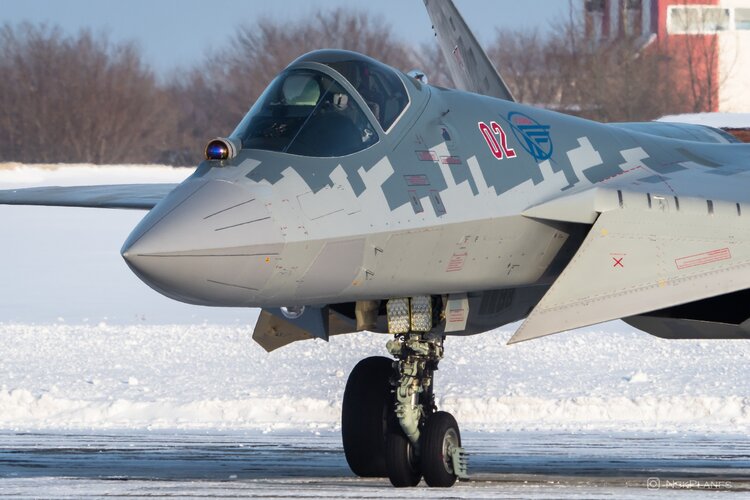

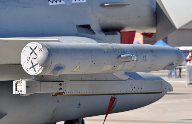

Front IRST unit of Su-57, 101KS-V most likely not dual band because windows transparent to LWIR are usually germanium which is a dark color and opaque in visible spectrum, or for dual-band MWIR/LWIR, zinc selenide which is yellow color also mostly opaque in visible spectrum. While the 101KS-V bulb is clear and transparent in visible spectrum which probably means MWIR only system.
The L-band IFF antennas aren't unique to Su-57, similar to Band 2 arrays on other fighters.
Hi ! 101KS-V bulb/dome is not so clear like old OLS-27 or newer OLS-30/35 'cause it has that 'yellowish/golden cover' .Now the question is ,is it only the RAM for reducing frontal RCS or maybe the material used for transparency of the MWIR/LWIR band.
Many sources mention that 101KS-V (OLS-50M) is based on so called QWIP technology and that it uses LWIR (8-12μm) band of the IR radiation.Maybe,maybe.... but here is some interesting comment about that topic from David Trapp on Quora :
Has long wave long range IRST defeated stealth?
Photos of the 101KS-V :

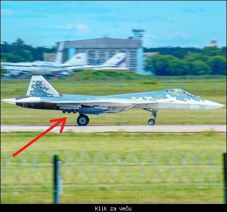

''It carries like three luneburg lenses…''
Take a look on the Luneberg lenses under the Su-57's wing...

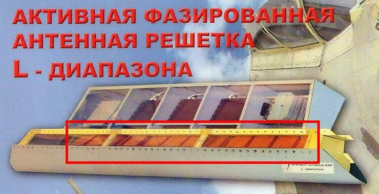

Now some pics and details .It is interesting to note that first public showing of the L-band antenna for the Su-57 was on MAKS2007. Red lines show us those very big/heavy TRM's

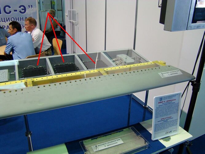

As mentioned before, linear 2D L-band PESA/AESA radar has two rows of radiating elements.
Radiating elements ....Three TRMs has its own radiating block with 4 pcs for every working channel.

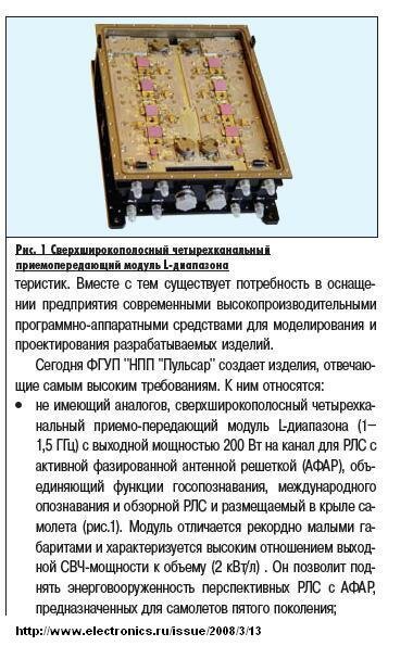

Now some details of those TRM's. It is interesting that average and max output pulse power of the each channel was increased over time.Some citations:
Data before 2010:
''Сегодня ФГУП "НПП "Пульсар" создает изделия, отвечающие самым высоким требованиям. К ним относятся:
• не имеющий аналогов, сверхширокополосный четырехканальный приемо-передающий модуль L-диапазона (1–1,5 ГГц) с выходной мощностью 200 Вт на канал для РЛС с активной фазированной антенной решеткой (АФАР), объединяющий функции госопознавания, международного опознавания и обзорной РЛС и размещаемый в крыле са-
молета (рис.1). Модуль отличается рекордно малыми габаритами и характеризуется высоким отношением выходной СВЧ-мощности к объему (2 кВт/л) . Он позволит поднять энерговооруженность перспективных РЛС с АФАР, предназначенных для самолетов пятого поколения;''

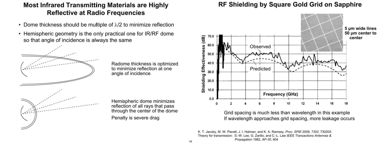

It isn't RAM, it is the micro mesh to prevent radiowave from entering the IRST. Kinda similar to the EOTS

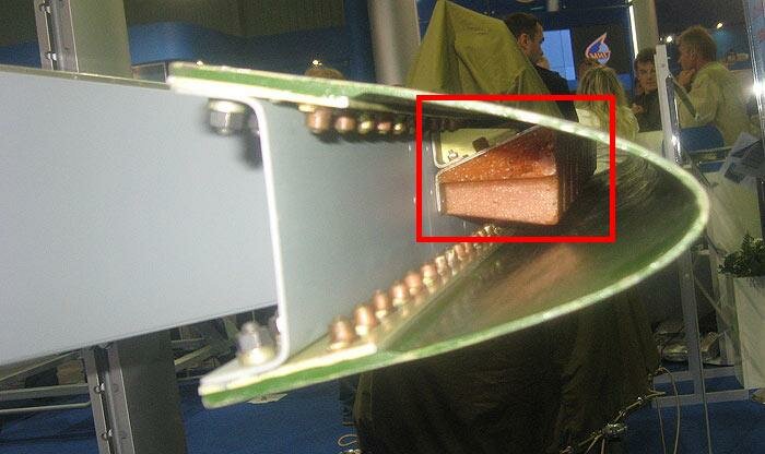

Each L-band AESA has two rows of radiating elements ( waveguides). One upper is used when LEVCON's and wingslats are in down position and lower one can be used when LEVCON's and wingslats are in neutral position. L-band AESA can be used for the search of airspace as wrote especially for long range detection of any stealth aircraft and it is the real so called ''gamechanger''.
L-band wavelength is like 30 cm, element spacing of PESA and AESA are generally half wavelength apart, for the Levcon and wing slat to have 2 row of L band element for beam steering, it need to be like 15 cm thick. I find that hard to believe.

So ,it is micro mesh to prevent radio(radar)wave from entering the IRST . Hm, it is some kind of Radar Apsorbent Material then?
No, not the same thing. Radar Absorbing Material mean the material can reduce the strength of the radio wave by ABSORBING it. The micro mesh here does not absorb radar wave, it only prevent radar wave from entering the sensor. It has the same purpose as the golden tin on F-22 or F-16 canopy. Yes it can reduce RCS by not allowing the radar wave from entering the cockpit, but it not the same as RAM.

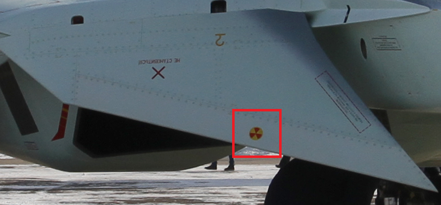

Radiation hazard sign are put on any put on any powerful transmitter, but such transmitter are not necessary be radar
For example:

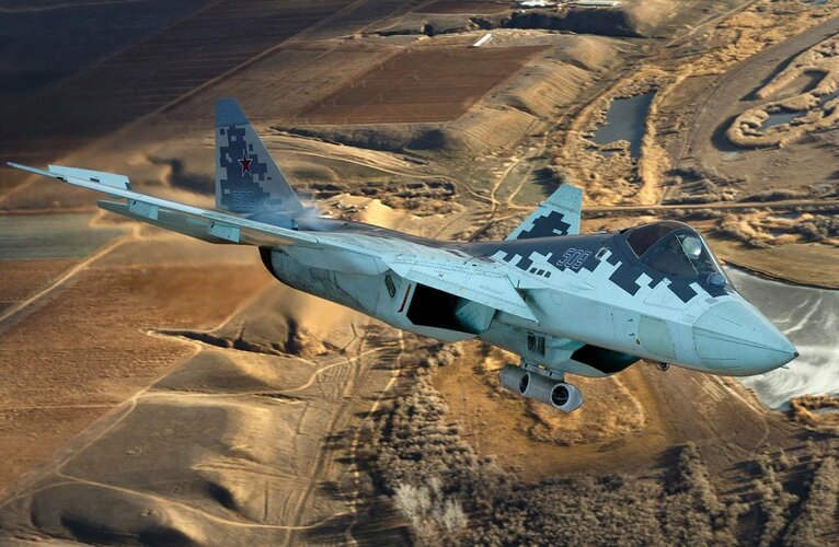

Yeah, after looking more into it the IRST bulb is definitely not the best for a stealth aircraft, and in fact now I think the figures Jack came to in his quora answer would be more likely with the bulb not being present (among the other things you mentioned). I wonder how the Su-57M could improve upon this if it can. I think the new flat nozzles that have been tested recently could be a huge help.
It's especially odd when you consider that The Soviet Union fielded this irst on The MiG-23 -
Overall, I really don't think that the issue is technological as opposed to having the wrong requirements for The Su-57 that ultimately compromise its rcs as is the case with the two weapons bays, with the result being a lack of S-Ducts & too much weight on the airframe, after which they increased the overall structural strength & opted for "partial S-Ducts" with a radar blocker, that, sure, is better than nothing, but is still not quite on par with the intake arrangement from an rcs perspective on almost all of the other stealth planes, so the bottom line is that you wind up with a missile truck that deprives you of achieving the optimal rcs. I mean, you don't have to be a genius to figure out that carrying more missiles than your opponent doesn't mean much when they can detect you at greater range than you can locate their fighters. This isn't even an East vs. West thing, either, btw - it's just common sense, especially when you factor in that Russia only ordered 76 Su-57s, so if you don't have the numbers against an alliance with a thousand F-35s, etc., I would think that it would be obviously incumbent upon your design team(s) to produce an aircraft with the best possible rcs, otherwise what are we doing, here?

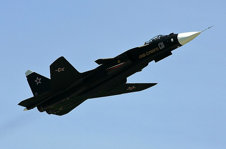

*By the way, why didn't they take this from this Su-47?
The Su-47 wasn't even a proper stealth plane, yet it had the flat underbelly. I wonder why Sukhoi didn't keep that.
I always thought that The Su-47 was so cool, much in the same manner as The YF-23 was radically different to what eventually became The F-22, & unlike The Su-57, The Berkut also had proper S-Ducts but only one weapons bay. I could also see them modifying the design to change the shape of the intakes & add levcons later down the road, but ultimately, one of the primary reasons that it was never adopted was due to the problems with forward-swept wings limiting the maximum speed to Mach 1.6, which, ironically enough, is currently the same limit as The F-35, albeit for reasons related to RAM, iirc.
Never forget, however, that The Su-47 first flew at a time when Russia was still in the abject misery of The 1990s, so the money simply wasn't there, even if it could have been built in numbers, so in the end, the platform wound up being a kind of flying laboratory for various technologies that were later incorporated into The Su-57, so it wasn't a total loss. I can't do anything about the irst bulb, though, lol, smh.

You mean these cameras?
Cameras ??? Three ball-like cameras one to the each other, hm. I first saw those 'balls' in one reportage from Russia 1HD TV on May 2018 several days before Victory Parade. Famous reporter Nayla Asker-Zade interviewed Sukhoi test pilot Taras Artsebarsky. I have some sequences from that video but video itself, I could not find.

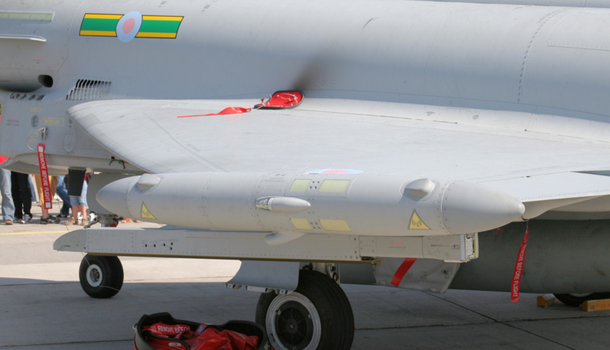

Btw cameras that were used for monitoring AAM/ASM test launches in 929 GLITs -Akhtubinsk test range are packed in one container.There is three cameras for monitoring test launches from fuselage weapon bays and under fuselage weapon bays,also for monitoring test launches of AAM/ASM launched from underwing pylons.There is rear looking camera for monitoring test launch of AAM that can engage air targets in the rear hemisphere of the Su-57.
Where do you get that number from though? and even 1/2 of 24 is still 12 cm, which is very thick
For example:
OK, then we can call it 'RPM' ( radar preventing material ), not RAM ,tnx.
About the wavelength , If I remember well ,value was from one interview with gen.dir. of NIIP named after V.V. Tikhomirov Jury Beliy in ''Национальная оборона'' or National Defence.I will try to find it.
About those 'Radiation hazard' signs. Yes, I know that we can see them even on the jamm stations. Modified jam-station L265M10-01M on Su-35S got that signs e.x. For me it is interesting that serial/operational Su-57's haven't that signs on L-band antennas.

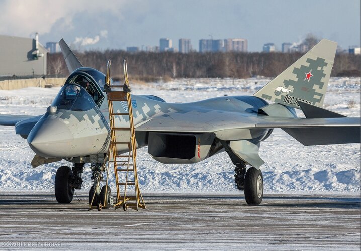

If we talk about only interrogator-IFF L-band antennas ,the main question is ,why they use four antennas for that.We can clearly see difference between interrogator-IFF L-band antenna of Su-35S and those L band PESA/AESA of Su-57.
Or you can just call it metal layer/ metal mesh since it is literally just a thin layer metal
Well, maybe so that you can jam and perform IFF fucntion at once?. Or maybe simply so that you can cover both side since Su-57 wing has very big swept angle and ESA aren’t exactly known for high boresight capability
They are both electronic scanned array
This is the simplest way ( copy/paste) to present this some kind of 'Technical Doc.' about the Project 'Scale'. As mentioned before ,this presentation is about decimetric L-band PESA/AESA N036L radars. I've lost my complete tranls of this doc. ,sorry....
I don’t quite understand. What is the name of that document? Is it the flight manual of Su-57?. Where do you got it from?
