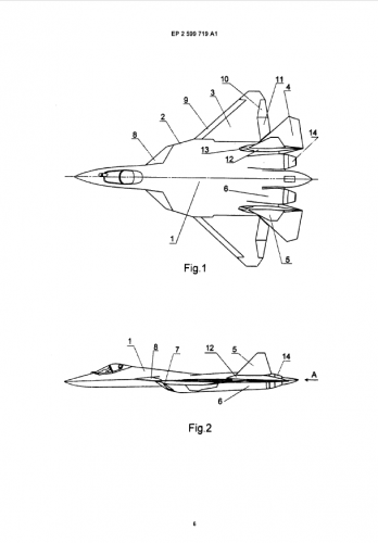

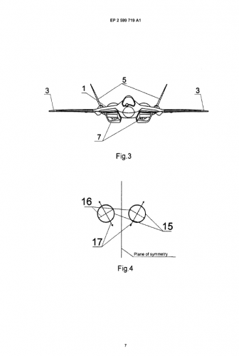

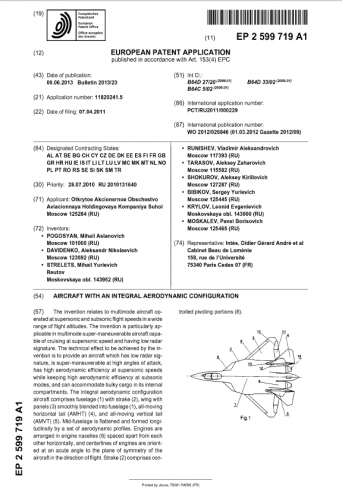

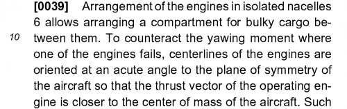

I might be naive in asking this, but why are there so many square/rectangular panels (i.e. edges facing the front), especially on the top side? Isn't that detrimental for stealth? When you look at the F-35, F-22, and B-2, there are very few (if any) panels with edges facing the front. Maybe this is just a stopgap for pre-production airframes?
Also, what's the reason for the engines to be towed in? Safety in case of one engine out?
They're most likely towed in to minimize drag during supercruise. At supersonic speeds, the flow tends to be conical off of the nose, so having the nacelles angled aligns them with the airflow at it's main design point within the flight envelope. I don't think they would angle them for engine out since they have 3D TV to adjust the thrust vector of the operating engine for such situations.
That's exactly the reason given in patent application (that makes one wonder why people lazy to read things), but as Sundog says, it has multiple pros.

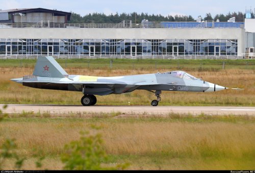

T-50-2 is back, interesting enough without stinger mod and LEVCONs seem to be static.
She got excessive infusion of adamantium...and underside now looks like another Tron hero.
