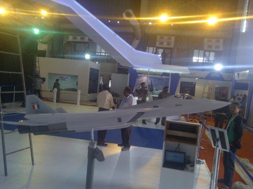

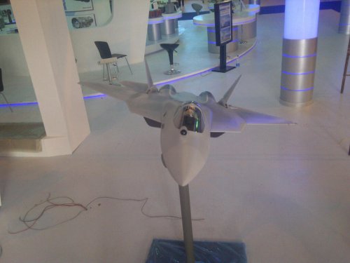

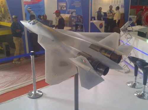

PMI ( ex-FGFA) model from Aero India, courtesy Shiv Aroor @Livefist:

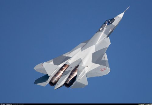

I just wonder if there is any particular reason to cut off the bar with photographers name and id of the picture?
Wil, spotters who post at RussianPlanes, have a sport interest, too, as number of page hits counts among community.
You making this contest less 'fair play' while reposting them here in fulll size.
I'm not talking of removing (c) tab at the moment.

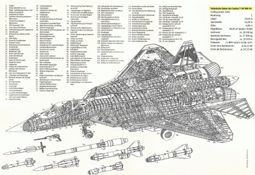

...from FliegerRevue...
As interesting as they are those drawings always crack me up. It's not as though the manufacturer sends a copy of the engineering blueprints to the publisher.
In fact, some are extremely accurate. Some of the artists have been able to wander around the production line viewing the assembly of the planes and have been supplied with relevant technical drawings. In other cases, the drawings were necessarily speculative (e.g. Soviet aircraft during the Cold War).

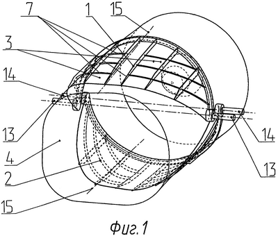

http://www.findpatent.ru/patent/227/2271964.html
The invention relates to aircraft equipment. The device consists of two sections in the form of a skeleton with a grid, steered in the air intake ducts. In the extended position is a gap between the sections, and the projection on the plane perpendicular to the air intake ducts, there is overlap the edges of the front section. The first one is connected to the second section of the kinematic coupling, transmission shaft rotation, the first section of which is fixed and which is connected to a power drive shafts, which established the second section. Each section consists of at least two parts and has at least one fold axis about which part of the section can be folded. At the installation sites covering the air intake shaft has a panel. Said invention is to increase the reliability of the protective device and improving maintainability. Description: 6 f-ly, 4 ill. The invention relates to aircraft equipment, in particular for structures air intakes (LA) equipped with protection device power plant against foreign objects.
The need to install a safety device called the possibility of contact with air path powerplant foreign objects from the airfield pavement or small birds on takeoff, landing and taxiing of aircraft. Getting used to eliminate various designs with grids.
Grid of the type described in U.S. Patent number number 2931460, 3871844, 4833879 permanently fixed in the inlet power plant. Such designs are the main modes of flight delayed submission to engines required air flow.
Known construction of protective devices intakes of power plants, in which the grid attached to several segments of the circle (see U.S. patent number 2,695,074 number, 2623610, 2618358, 2704136, 2747685, 2709499, 2704136, 2835342, 2812036). Segments like petals and released or moved between the retracted position actuators. In the extended position the segments fit together and block the flow of air in the retracted position adjacent to the skin channel inlet. Because the design of these contain a large number of segments, the following problems occur:
- During installation, adjustment of the segments as in the issued and in the retracted position,
- For each segment to be transferred from the control of the actuator, thus increasing the number of parts, complicated construction, reduced reliability and increased weight.
Closest to the proposed solution is a retractable safety device for gas turbine engine air intake as described in U.S. patent number 2,944,631. It can be used as a circular air intake and other forms, such as elliptical or rectangular. Protective device consists of two sections, each of which is set to rotate relative to an axis across the channel inlet, so that in the extended position sections cover the entire channel, the front edge of the sections are closed to each other, the other edge of the sections merge with the walls of the channel inlet. Sections have a framework that supports a grid designed to trap dirt and foreign objects. In the retracted position, the sections are located outside the Flow-through, allowing air to pass freely in the power plant, so the shape of the sections corresponds to the shape of the channel walls intake so that they form parts of the channel wall.
Axis on which sections are set, can be parallel or even match. In a preferred (according to the authors of U.S. Patent number 2,944,631) variant section mounted on a common axis, located in the center of the channel across it, and the front edge of the sections meet in a plane containing said axis. In this section are connected kinematically by rocker mechanism and turn actuator (hydraulic cylinder) attached to the edge of one of the sections.
The design of such a safety device has the following drawbacks:
- Difficult adjustment for the front edges of the closure of sections in the extended position and vpisyvaemosti them to bypass channel in the retracted position (no exact closing the front edges of the sections in this design may dirt into the engine, in the absence of the channel vpisyvaemosti may stall with protruding edges) ,
- For closing the front edges must be strictly symmetrical surface of the channel walls in the area of ​​protective device, ie cylindrical, conical, elliptical or rectangular,
- The axis of rotation of the sections must lie in the same plane (in particular, be parallel or match)
- Installation of both sections on a common axis of rotation complicates the construction site rotation sections
- The design does not allow to be removed for repair only one section without disturbing the installation of another,
- With a long, tapering to an input channel is difficult to remove a section through the inlet channel (need to remove the engine to dismantle sections of the channel),
- Rocker mechanism to synchronize the rotation of sections has great friction and rods connected to the frame sections that are experiencing from this additional burden.
The present invention is to increase the reliability of the protective device and improving maintainability of protective devices, in particular the elimination of problems associated with the need for closing the front edges of the sections and their removal from the channel.
The problem is solved by using a safety device air intakes containing two sections, each of which is a frame with a fixed grid and it is set in the channel inlet to rotate so that the extended position sections cover the air intake section of the channel, and in the retracted position, the image fragments of the channel wall inlet, characterized in, that the said sections are set so that in the extended position is a gap between the sections and thus projected on a plane perpendicular to the channel inlet in a protective device, there is overlap the edges of the front section.
Mentioned the possibility of turning the mentioned sections performed due to the fact that they were installed, each on its axis of rotation, and the mentioned gap and overlap formed by the selection of the relative position of these axes.
Mentioned the possibility of turning the mentioned sections is realized due to the fact that the first of these sections is controlled actuator and is connected to the second section of the kinematic coupling, the use of simultaneous move partitions from the retracted position to the down position and back.
Said control actuator first section is implemented so that the first section is mounted on shafts that rotate about the axis of rotation of the section, and that is connected to an actuator.
The second section is mounted on shafts that rotate about the axis of rotation of this section, referred to as the kinematic linkage is designed so that it transmits the rotation shaft, which is fixed on the first section, the shafts on which are mounted the second section.
Each section consists of at least two parts and has at least one folding axis about which parts of each section can be folded.
At the installation sites mentioned trees lining the channel inlet has panel Retractable when turning sections mentioned in the down position.
This solution enables:
- To avoid any need for precise clamping front edges of sections, so as preventing dirt and foreign objects in the proposed closure of sections formed by the fact that the leading edge of one section is shifted relative to the front edge of the other sections to form the overlap
- Shift of the same section from the edge of the other sections in the direction along the inlet channel to simplify control sections in the extended position, as does not require a precise fit the edges,
- Because edges do not merge, attenuated form requirements of sections and form the channel inlet: they may not have symmetry, providing exact closing edges, so the channel can be asymmetrical,
- By connecting the actuator to the shaft can pass the control effort on the turn of the sections by the shortest route and avoid strain sections, which occur when the actuator is connected to the edge of the section,
- Spacing of the axes of rotation of sections protective device can accommodate between kinematic constraints and reliability synchronization turning sections
- Due to the fact that the kinematic relationship transmits motion from shaft to shaft, to avoid deformation of the second section,
- Greatly facilitate operation (taking out sections), the cover due to the fact that each of the sections mounted on a single axis of rotation, and each has an axis of folding.
1 shows an air intake duct with the guard with a section in the retracted position in perspective.
Figure 2 shows a longitudinal section of the channel with the guard with the sections in the retracted position.
Figure 3 shows the channel inlet with a safety device with the sections in the extended position in perspective.
4 shows a longitudinal section of the channel with the guard with the sections in the extended position.
Protective device inlet LA contains two sections 1 and 2, each of which represents a 7 frame mounted thereon grid 3 and channel 4 is installed inside the air intake to pivot between a retracted position and released so that the extended position of section 1 and section 2 covers Channel 4 intake (see Figure 3, 4), and in the retracted - form a wall fragments inlet channel 4 (see Figure 2).
Sections 1 and 2 are set as follows (see Figure 4), which is in the extended position is a gap between the sections of A (A is a gap that the leading edge of one section 1 does not touch the front edge of the other two sections, and vice versa) and that the projection a plane perpendicular to the channel inlet in a protective device, there is overlap the edges of the front section B (the presence of overlap means that the projections on this plane sections overlap each other near the front edges - overlap). In the case shown in the figures, Section 1 is located above two sections and floors are made so that the front edge of the bottom section 6 2 offset from the front edge of the upper section 5 1 up.
Ability to rotate the sections 1 and 2 carried out by the fact that they are set on the axes of rotation 9 and 10, respectively. Each section mounted on the axis of rotation, ie, axis 9 and 10 are not the same, and in general may be placed randomly with respect to each other (the indirect channel inlet axis 9 and 10 may be even not parallel).
A gap and overlap B sections are formed by the selection of the location of the axes 9 and 10, so that is the location together with the form of the Section provides the required values ​​and the gap 7 and overlap B. Required size of the gap and overlap are determined experimentally. 4 shows the magnitude of the gap A is the distance between the front edges of the sections in a direction along the inlet channel, but as the overlap B - length of the segment on which the projections overlap of sections 1 and 2 in the plane perpendicular to the channel inlet.
One section, for example, the first section 1, is controlled by actuator 11 and is connected to the second section 2 of the kinematic coupling 12, the use of simultaneous move partitions from the retracted position to the down position and back.
Installation of sections 1 and 2 on the axes 9 and 10 is implemented in such a way that each side of section 1 is fixed at one of two coaxial shafts 13, which is the axis of rotation of the axis of rotation 9 section 1 and section 2 of each side - one of two coaxial shafts 14, which is the axis of rotation of the axis of rotation 10 of section 2. Shafts 13 and 14 do not cover the air inlet duct 4. Management section 1 is implemented so that the actuator 11 is connected to each of the shafts 13 and can rotate them. This avoids distortions. Kinematic relationship 12 installed on both sides of sections 1 and 2, and is designed so that it transmits the rotation shaft 13 to the shafts 14.
Each section 1 and 2 consists of at least two parts and has a folding axis 15 about which parts of each section can be folded to reduce its size. Folding can be done, for example, by shompolnogo connection axis 15.
At the installation sites of shafts 13 and 14, covering the channel 4 has movable panels 16 and 17, entered in the contours of the inlet channel at the retracted position of sections 1 and 2 and Retractable when turning sections 1 and 2 in the down position.
The gaps between the edges of sections 1 and 2 and a covering Channel 4 are so small that you can not foreign objects again in the channel 4. Space 18 above the upper section 1 communicates with the space 19 with the bottom section 2 through the side channels 20 in the air intake frame for collection of foreign objects in the waste bin, 21, who is under the bottom section 2. Location Collector 21 is selected under the lower section 2 so as to have got there things were not keen on the air flow in the power plant. In a waste bin, 21 hatch 22 to retrieve debris.
Protective device inlet works as follows.
At rest before starting the engine, sections 1 and 2 safety device rotated about axes 9 and 10, respectively, due to the fact that the power drive 11 rotates the shaft 13, which is fixed at one section and kinematic relationship 12 passes this rotation shaft 14, which is fixed Section 2. Section moved to the down position.
When turning the sections 1 and 2 press on movable panels 16 and 17 casing 4 and channel them into the wall utaplivajut channel 4.
In the extended position the cutting edge 6 of the second section two removed from a gap relative to the front edge of the first five sections 1 in the longitudinal direction (along the channel 4) and up to form the overlap in the vertical direction in the plane perpendicular to the air intake ducts in a protective device as described above and shown in the drawings.
After starting the engine, and the movement of aircraft on the runway of the flow of air to the power plant, is on channel 4 through the air intake grid 3 sections 1 and 2. Foreign objects in the power plant through a gap between sections 1 and 2 prevented by overlapping 8, because overlap with a gap formed perpendicular profiled air inlet channel 4 channel that can not move objects that are moving in a stream of air and they themselves can not abruptly change its direction. In this case, the heavier the foreign object, the less they are able to depart at the direction of air flow, thus less likely that they will pass through said shaped channel.
After takeoff, the aircraft sections 1 and 2 actuator 11 are transferred to the retracted position. The movement of the drive shafts 13 11 passed, and a kinematic linkage 12 - 14 shafts. Therefore, sections 1 and 2 rotate and fit the contours of the channel 4. Movable panels 16 and 17 casing channel 4 are once again flush with the skin of channel 4, closing the front edge of the 5 and 6, sections 1 and 2 in the field installation of shafts 13 and 14.
In Transition sections 1 and 2 in the retracted position foreign objects from airfield pavement and small birds, detainees braid 3 sections 1 and 2, enter the space between 18 and 19, sections 1 and 2 and the wall of the air intake frame. Foreign objects, arrested top section, after cleaning the side channels 20 fall into the waste container 21. Items detained lower section 2, in the process of cleaning get there immediately.

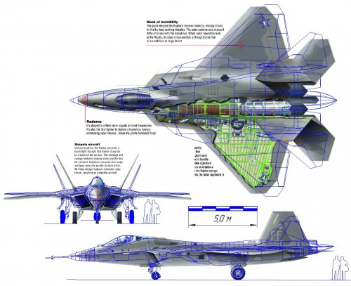

Good artist work, but w. many mistakes that could have been avoided using readily available open data and - that's not talking of weird missiles zoo.

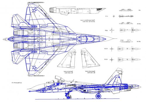

Have these been posted yet? Are they even from the PAK-FA? (lifted from another forum, mods please delete if not kosher)
Quite some time ago (12+ months ago) - IIRC, they were indeed images of a PAK FA simulated cockpit, given away by it's large HUD and MFD's. The Su-35BM(aka S) shares a similar cockpit design, but utilises a different HUD.
Don't know about this specific case but I have actually witnessed one published by Flight International in the late 80's. The guy who created it was at the manufacturer site for two weeks with access to all engineering drawings he wanted and the result was pretty decent in terms of accuracy.
The pictures are old, but they were uploaded recently. We might as well post the source, which is:
http://fotki.yandex.ru/users/korotchenko-rusarms/album/287888/?p=1
The pictures are from Sukhoi OKB, they have several T-50 stands there and T-50-0 is also located there.
photos were made during Putin's visit to Sukhoi on March 1, 2010

http://www.aviaport.ru/digest/2013/04/29/254263.html
this maybe? http://www.findpatent.ru/patent/239/2396366.html

Two size comparisons: Su-27/PAK FA and F-22/PAKFA
interesting... interesting...
(From Paralay)
Best wishes!
