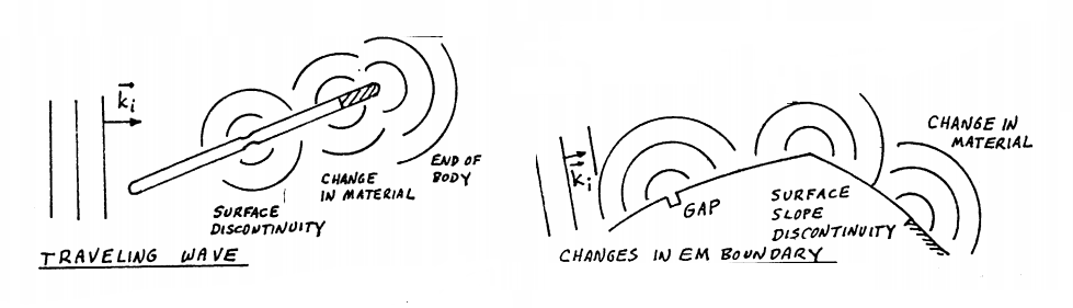

Yes, there are gaps and angles where the F-22 nozzles are not optimum. However, most are either covered by a flexible joint, and/or are coated. The flat sidewalls will reflect, but under most angles the signal will bounce into the AB cavity, which purposely design to swallow RF energy. The position you see the nozzle is the shutdown position, while at most thrust conditions the external flaps are in perfect alignment with the outer mold line. This isn’t true under Max AB or high vector conditions, but LO is probably not the main concerns in this part of a fight.
The flat nozzles and engines shown on the Su-57 have several apparent issues
1. The exposed nozzle sidewalls are not aligned with the vertical fins and airframe sidewalls.
2. The divergent flaps have two angles, neither of which appear to be surface aligned, creating a hexagonal reflecting opening.
3. The internal nozzle sidewalls have a vertically aligned corrugated feature, which would reflect RF energy. It is possible that a smooth liner is not installed on this nozzle in the photo, maybe they haven’t figured out how to cool it properly?
4. The view up back of the engine shows radial flame holders, but there does not appear to be any line of sight blockage for the components forward of the flame holder (spraybars, turbine blades, etc)
LO, especially at the aft end of an afterburning engine, is hard.

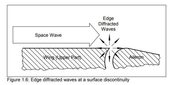

Again those gaps between the F-22 engines and fuselage give off additional RCS no matter how much you deny it. This has been covered to death. Any cavity or discontinuity will cause the RCS to increase. This information is publicly available and has been covered here and by many other publications.
And no just because those gaps have serrations does not mean it will magically cancel out the RCS. The RCS has to go somewhere….The reason why the F-117 doesn’t have as small RCS as an F-22 or B-2 or F-35 is because it used faceting exclusively, where the EM energy was redirected off many different parts of the aircraft. Where as modern stealth aircraft primarily have the EM energy travel along the contours of the aircraft and diffract off fewer areas.
So yes those F-22 gaps definitely…100% increase the RCS just like the SU-57 round engines definitely 100% increase RCS.

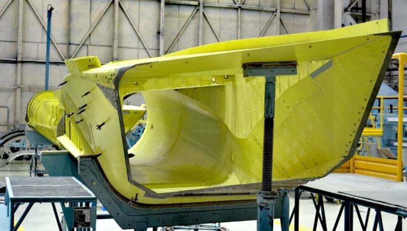

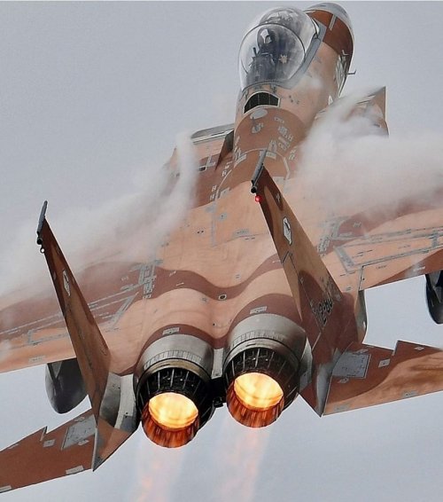

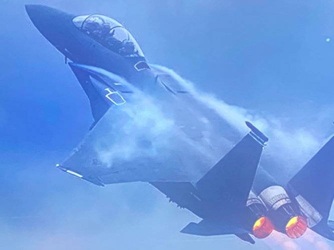

F-15 has upper surfaces of intake ducts that affect airflow around the aircraft and are similar to LEVCON
Yes but 'LEVCON' as Leading Edge... so that has nothing to do with the air intakes as part of the fuselage.Besides F-15, MiG-25 ,MiG-29M/M2 , MiG-29K/KUB and MiG-31 have also so called 'lip' as movable part of the air intakes on the bottom side. Btw ,MiG-29K/KUB have panels on the bottom side of the LERX as something similar to the LEVCON's.
My apologies, I accidentally deleted the previous post.
The F-15 has movable upper intake ducts that actively affect fuselage flow and in this they are a bit similar to LEVCON
The moving intakes are not like Levcons, they're simply there to adjust and optimize the inlet flow based on alpha. Levcons are just basically integrated canards. They have good control power, which is why so many Northrop designs from the late eighties and early nineties had them.
The F-15 intake ducts have multiple ramps and the one at the upper optimizes the flow over the fuselage, this allows the F-15 to have lower trim drag and achieve higher AoA ( because there is a delay in the flow over the fuselage.)
In fact, the F-15 ramps are used to change the aero trim of the aircraft, lifting the front of the aircraft to partially offset the nose down pitching moment that occurs when the wing center of lift moves aft supersonic, in addition to aligning with high AOA and moving the internal ramps for supersonic oblique shock positioning in the inlet.
The ramps in the ducts are usually locked and don't move. It keeps maintenance to a minimum.
Not if the F-15. All versions have fully functional ramps and hoods (upper section).
On the F-14, the variable inlet bleed doors were locked into a fixed position to reduce maintenance, while the internal shock ramps remained fully functional.
Yes, they reduce trim drag at supersonic speeds, plus they modify the airflow over the fuselage at subsonic speeds/higher AoA because they form a vortex. A small vortex but still important.

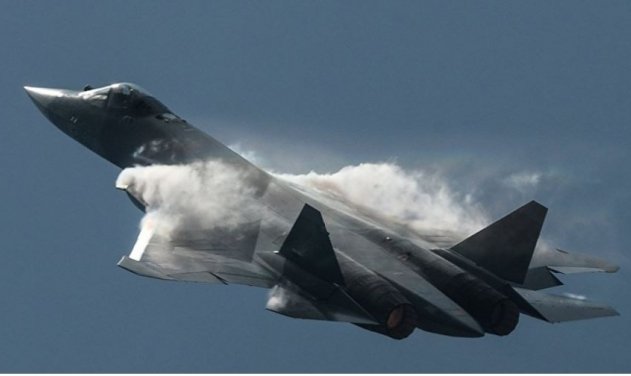

LEVCON's ,mini-LERX and wingslats with vortices. Interesting flaperons and ailerons deflections.
Back to analysis made several years ago ...
Very interesting detail,flaperons and ailerons of the left wing deflected upwards,those of the right wing was deflected downwards.
From 0:24 and 2:11 we can see both flaperons and both ailerons deflected upwards ( for breaking of course).
