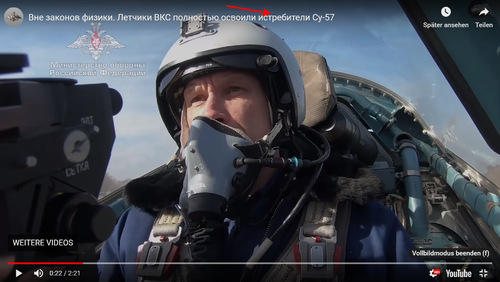

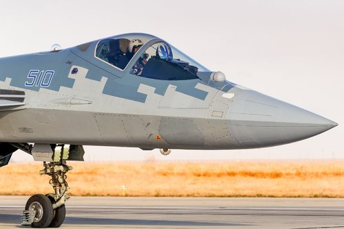

Does anyone know what these bubble looking things in the canopy glass could be? Appears around 1:03.
Doesn't look like moving bubbles to me, imho some sort of production fault. Probably not material. I thought it was bubbles in the canopy too cause they didnt move as one would expect with water, however, if one looks at the 22s shot or so of the same cockpit they cant be seen. So either the shots were taken at completely different times with different canopies (extremely unlikely) or they are just water indeed.
Here is another video:

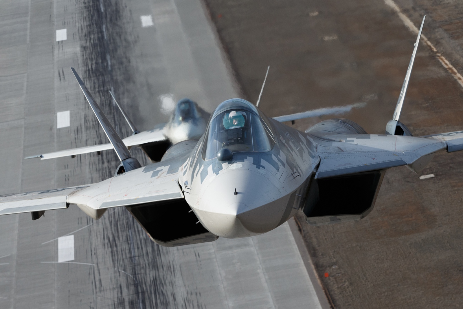

Same story there, no canopy bubbles seen. Also worth noting is that the dark grey camo T-50-8 has a different left intake under vertical stabs than the usual. I checked, and sure enough T-50S-1 had the same style intake.

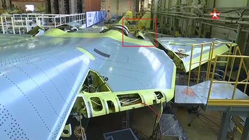

Assembly photos?
Nah, early assembly video from ~May (iirc). See attached pic.
Shitty quality of canopy was long rumored for early articles.
Looks like we have a proof. Interesting that editors missed this.
See my correction, the "bubbles" are only seen in one shot, all the other shots of same frame with same pilot doesnt show them.
Assembly photos?

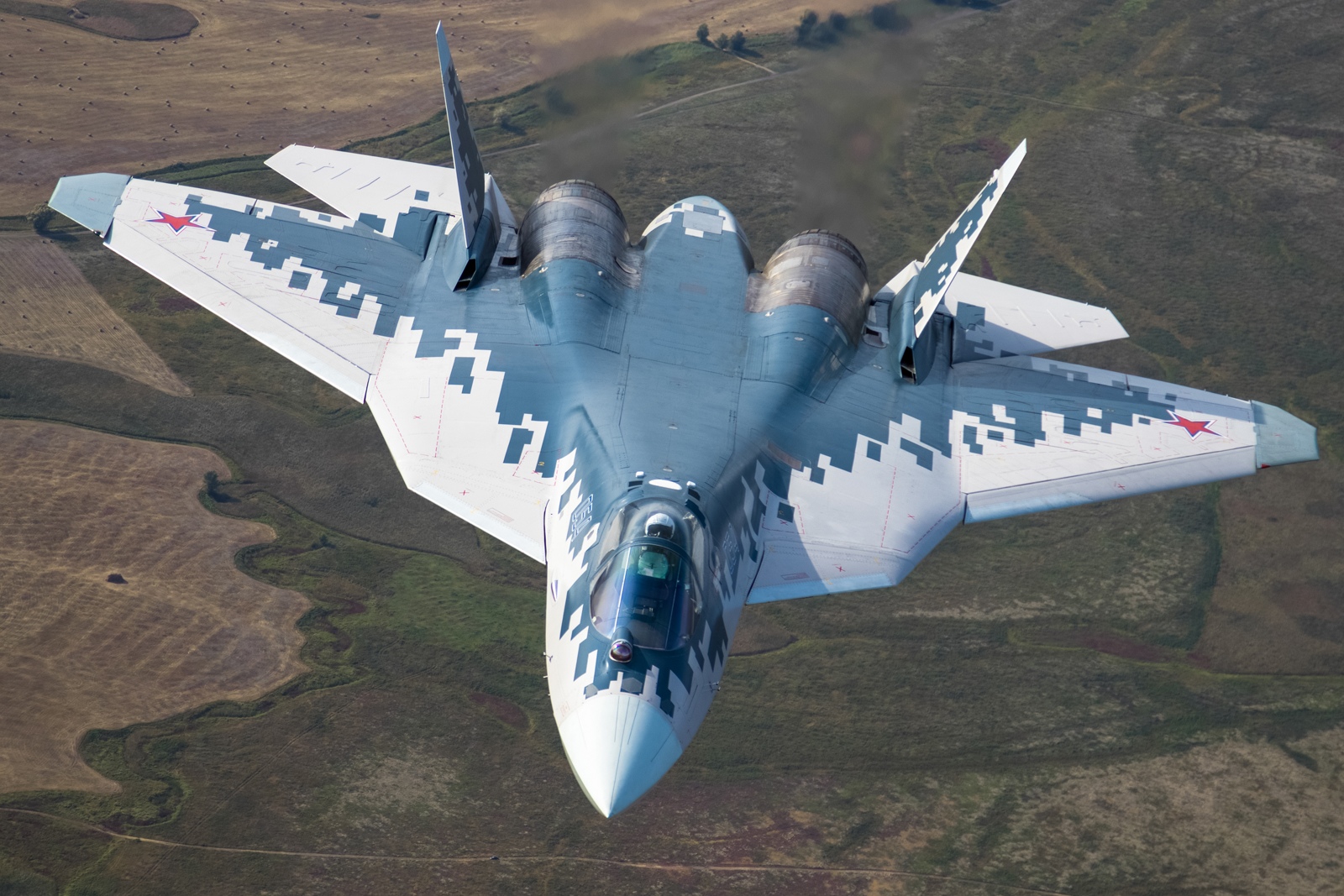

About the RAM treatment of Su-57:
Rivets surrounded by RAM (2nd stage prototype T-50-8):
Rivets with no RAM surrounding them (1st stage prototype):
Contrary to the rather popular misconception that no PAK FA frame so far has a RAM treatment, actually all the 2nd stage prototypes have it. But the RAM doesn't cover all the surface areas. The borders of the RAM coverage are pretty clear on this picture of the first flying 2nd stage proto:
The first serial frame appeared to follow the same pattern:
One would imagine that in the areas with RAM treatment, the rivet holes in the RAM coverage could cause some disturbances for the electromagnetic wave, but that is probably not relevant if we are not talking about RCS in the range of 0.0001. While clearly in different category stealth-wise compared to Super Hornet, Eurofighter and Rafale, some finer RCS reduction measures are lacking compared to F-22 or J-20.
I wonder what kind of a bottleneck the first stage engine presents for RCS. Obviously the conventional nozzle alone affects it negatively from non-frontal sectors, but if the radar blocker is not meant to work optimally alone, needing 5th gen inlet guide vanes for proper results then the aircraft is handicapped from frontal sector as well with the old engines. That could explain why complete RAM coverage isn't useful for the current version. Of course it is also totally plausible, that a 0.0001 level (with its own drawbacks like the weight increase from more RAM) wasn't seen as optimal for a fighter designed to perform its most crucial role (defensive counterair i.e. defense of own airspace) within the framework of very powerful friendly IADS.
One would not be surprised to see some fighter design philosophy differences between the DCA leaning Russians and OCA leaning Americans.

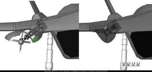

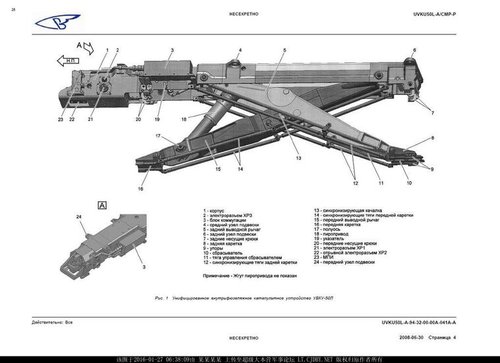

UVKU-50L is for the main bays, hence for different weapons. And as seen, it is not a rail system but an ejector, R-73 family uses rails. Secondly, the door doesnt open like that, as seen both from the video and the patent, it opens towards the intakes. I could have sworn i have seen datasheet for the sidebay rail, but i cant find it...
It's all, all wrong - starting from the main weapons bay shapes and finishing with wrong launcher for a wrong missile...
In that Chinese CG or in the link added?
The Chinese CG.
It seems the patent that clearly depict how the missile is released is completely ignored and people just make things up. I wonder if the patent is not clear enough on the mechanism.
For me tho it is very clear. Prob i should try animate one.
Please remind me flateric, is there a datasheet for the sidebay rails out there in the open ala UVKU-50L/UVKU-50U? Again, could have sworn seeing it...

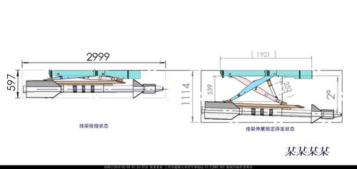

Well, dont beat me if my interpretation of the patent is still inaccurate. But here is the orientation of R-73 missile in Sidebay.
This is when the bay ois open and the missile is about to launch.
The launching position, so the launcher is lowered then the pylon part which handles the missile move bit forward to clear the seeker viewpoint.
From top side
Not depicted is of course the heat resistant plate which will resist and direct the initial blast from the launch.
Is this paint scheme supposed to be a camouflage and help avoid id? Really?
This is high resolution at close range in clear air in full daylight against a high contrast background. The opposite of all of these will apply in real combat situations. The idea is not to make the aircraft invisible, but to make it easy to misjudge its distance when making instant decisions.
