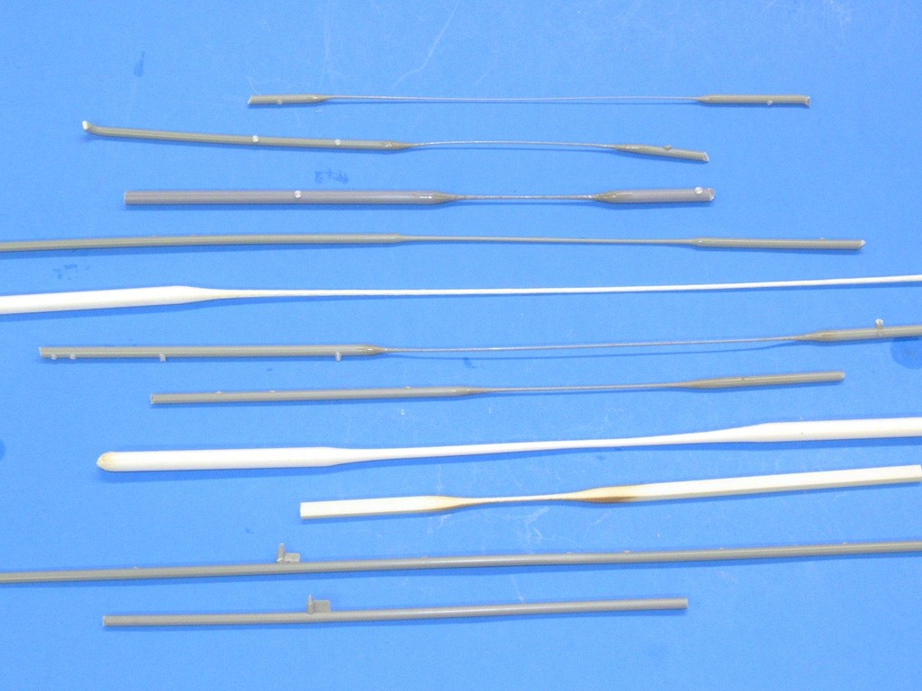

All of the gray pieces pictured are kit provided polystyrene runners. The white stuff is pre-formed shapes manufactured from ABS plastic. Note how I’ve been able to achieve varied cross section diameters and degree of tapper. An acquired skill, I can assure you.

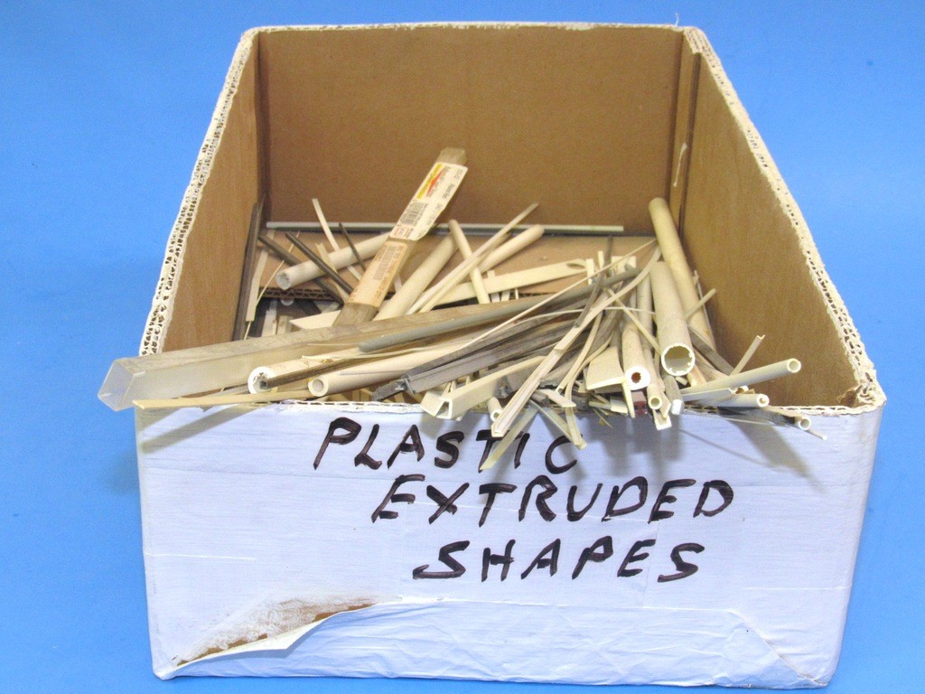

Over the decades I have gathered a considerable collection of thermoplastic extrusions, as this photo demonstrates.

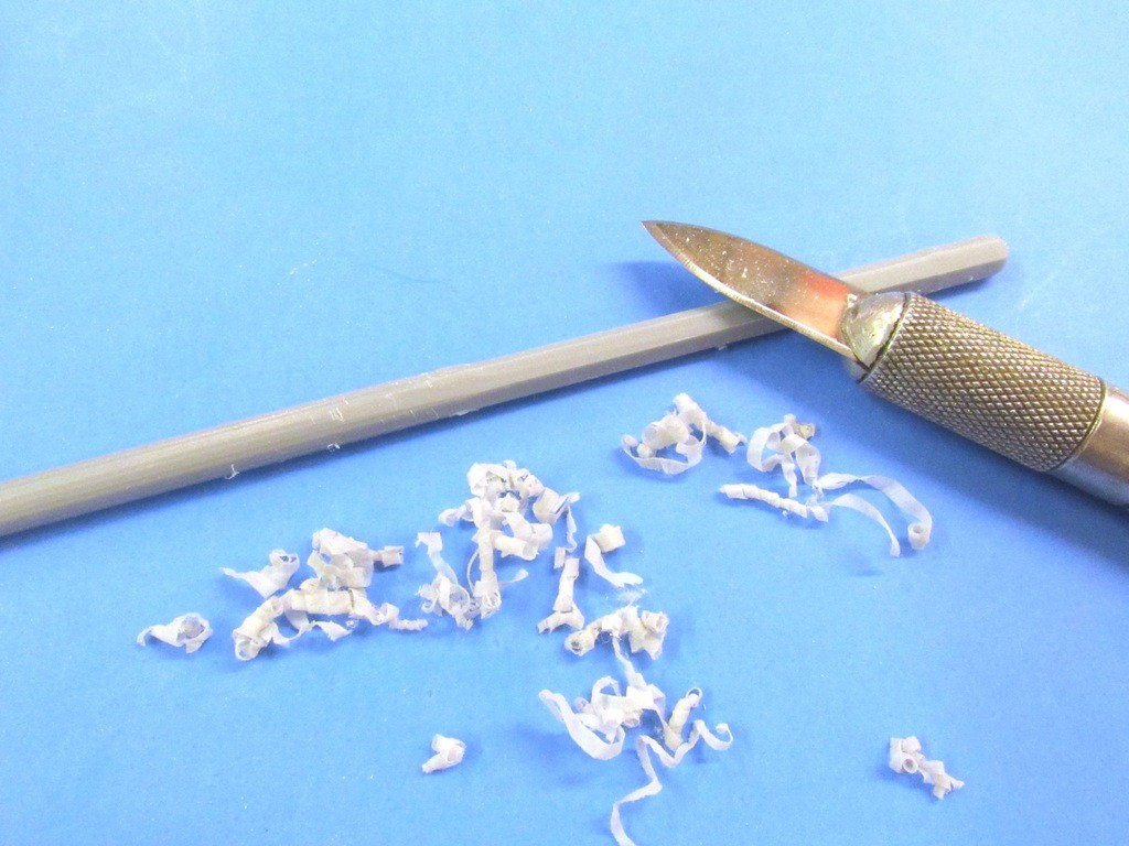

You don’t have to be a slave to the cross section of plastic you have on hand. You can pre-form the cross section – as I’m doing here on this length of runner – and then heat-stretch it to the desired diameter. In this case I require itsy-bitsy little hex section length, which will become bolt-heads. I start with a comfortably sized piece of runner, perform a little shaving action with the X-Acto blade on it, and I’m ready to heat the work and draw it to the required diameter. Nothing to it!

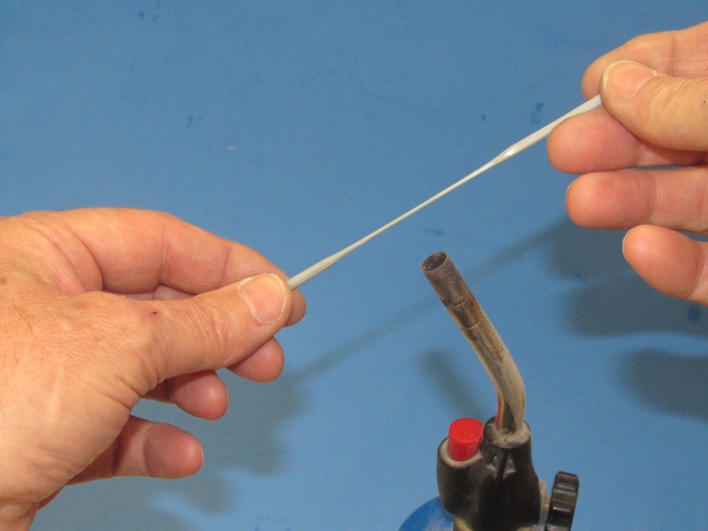

I prefer to employ a torch as a heat source. Some prefer the open flame of a candle. Whatever blows up your skirt. As long as the heat can be applied where you want it and you can control the heat rate by moving of the work in relation to the heat source.

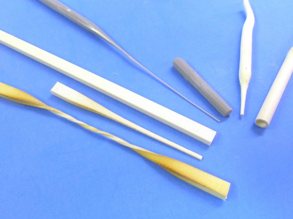

Putting a point on the fact that heat stretching a shape only reduces its diameter, not its shape, is this collection of various shapes (circular, square, tube, and hexagonal) – the original piece next to the stretched item drawn from it.
Sometimes I can’t help being a smart-ass about it: note the ‘twisted’ stretched rectangular sectioned piece of ABS – wrought-iron poker, anyone?
