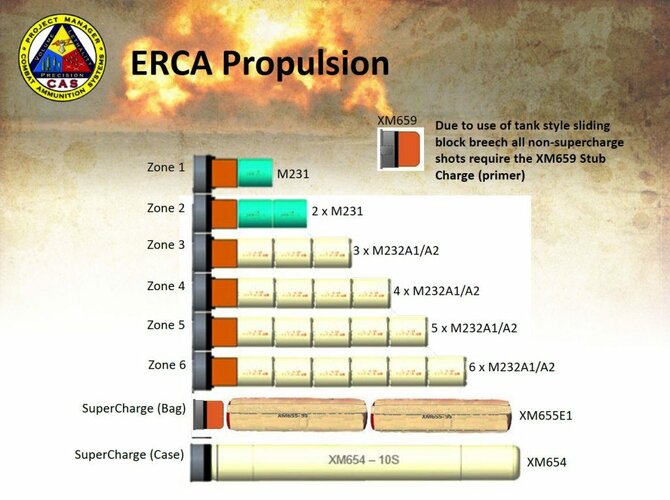

A naval gun could adopt the same charge being developed for the Army Multi-Domain Artillery Cannon, which will probably be rather similar to the one-piece cased supercharge developed for ERCA. That was too big to manhandle, but both MDAC and naval guns should eliminate that step in loading.

You can just put the MCAS powder in a brass case and call it a day.
Hell as is the Super charge is bout 10 pounds more then the old 6/47 used in ww2, with zone 6 charges being less at 30 pounds to the 6/47 33 pounds.

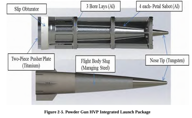

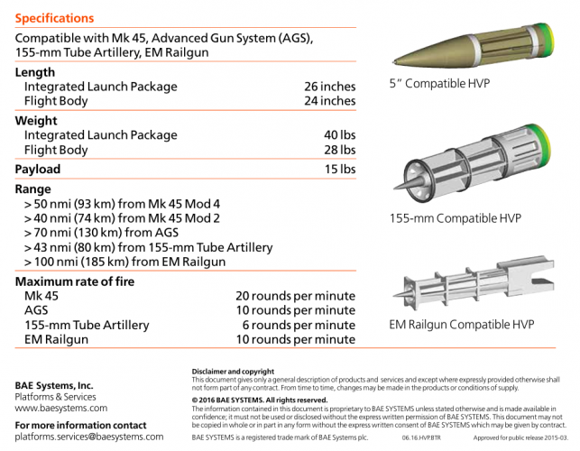

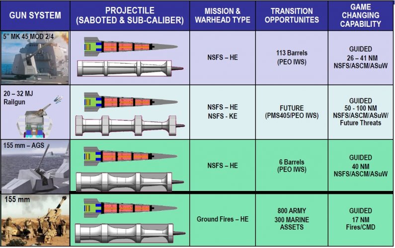

Trying to learn more about the Hyper Velocity Projectile. It seems that the HVP has guidance via fins, and 15 pounds of HE. Is this a hit-to-kill with a a lethality enhancer? In some graphics, the HVP is shown as having a tungsten tip, implying HTK at high velocities.

15lbs of boom is about on par for a 155mm HE shell, so that's not a lethality enhancer IMO.
