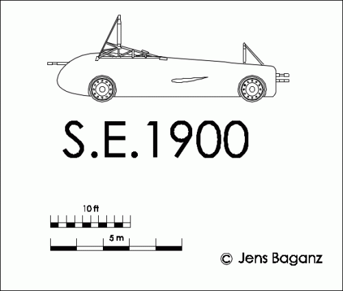

Very good clue Dan !
The SE 1900 was considered for launching several Leduc
designs. And aesthetically not unpleasant, I think ! ;)

Nice drawing,thank you my dears,I think it was an aircraft,sorry.

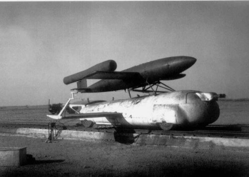

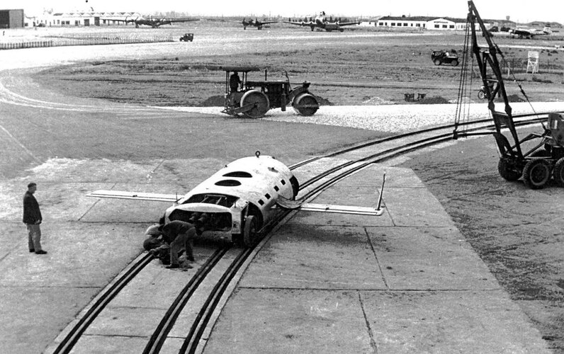

Two photos of the real things (from " Rene Leduc - Pionnier de la propulsion
à reaction" Lacroze/Ricco).
BTW, the SE 1900 was the version for conventional runways, so it didn't need
tracks.
pometablava said:
That car was used as a V-1 launcher?
Yes ;D
the S.E. 1910 made 330 km/h (205 mph) on Railtrack
note, the Wing is in reverse to push the car on the tracks!
but wat is those gun like nozel in front, retro rockets ?
It was a Fi-103/V-1 with a SNCASE built puls jet, according to the
caption in the Leduc book.
The "gun like nozzle" could just be a shock absorber, I think.
Splendid! So the thing has been preserved and is exhibited at Istres air force base (Marseilles area)? Cool!
Am I right, that this memorial was inaugurated by Colonel Leduc in 1997 ?
Anybody know, if he was a relative of René Leduc ?
There is no family relationship from the Colonel Marc Leduc and the ramjet designer René Leduc. Nevertheless, his granddaughter Aline Leduc participated to the ceremony.
I was personally involved too, as I was working at that time for the CEV, located on BA 125. This is not an original, but a reconstruction, built on the initiative of the Colonel Leduc. For the record, the body of the V1 is based on a former Mirage III external tank.
