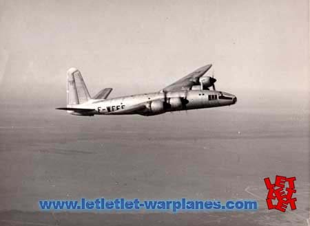

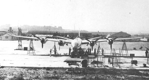

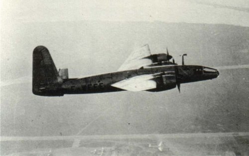

Trying to find any information about postwar SNCASE warplane projects here, i'm find out that there is no information about SE-1010, high altitude reconnaissanse plane.

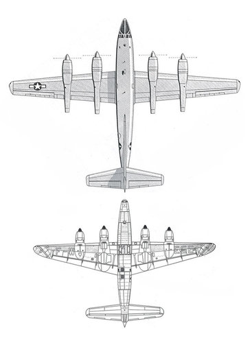

It looks very close to Republic XF-12 Rainbow.

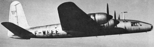

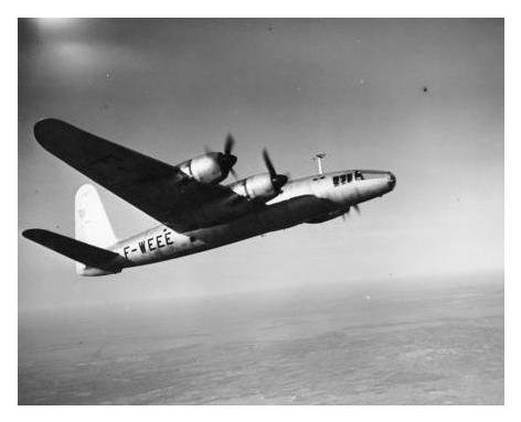

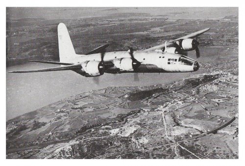

Here some information about SE-1010.
First flight was made by Jacques LECARME on November 24, 1948. SE-1010 was the four-engine monoplane, made for photographic reconnaissance, powered by 4 SNECMA 14R-28.
Empty weight - 15.0 tons
take-off weight - 24.0 tons
wingspan - 31.00 meters
length - 21.80m
max speed of 520 km/h
cruise speed 400 km/h
Plane was lost on October 1, 1949 due to flat spin. The crew of six (Test pilot Henry VANDERPOL, flight test engineer Pierre Bouillon, engineer Silvio Agliana, radio operator Marius RIVET, mechanics Valery Chasson and Fernand PILLET) was lost...

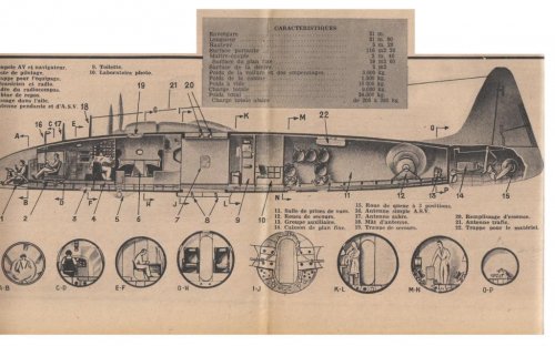

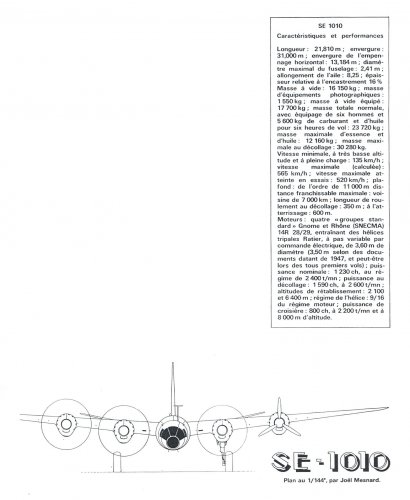

Justo Miranda
Dec 2, 2007
4,893
3,810
www.amazon.com

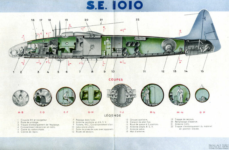

From
Le Fana de l'Aviation

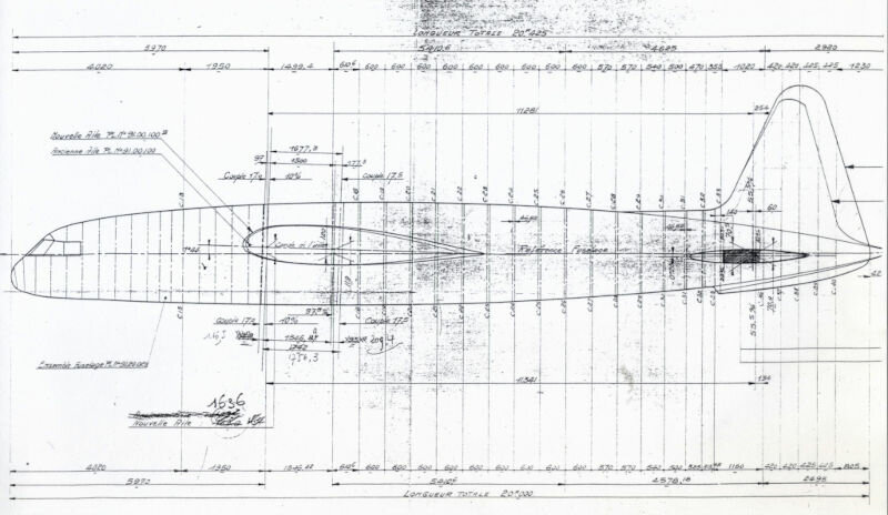

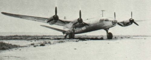

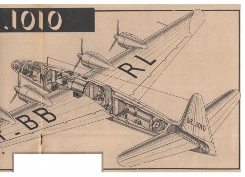

A personal favourite of mine; though hardly "Secret" and very definitely not a "Project". Here is some contemporary press including a piece in Les Ailes bemoaning the fact that they were not allowed to cover the first flight......
Terry (Caravellarella)
  • SNCASE SE-1010 F-WEEE - Les Ailes No. 1,189 - 13th November 1948 1.......jpg
  • SNCASE SE-1010 F-WEEE - Les Ailes No. 1,189 - 13th November 1948 2.......jpg

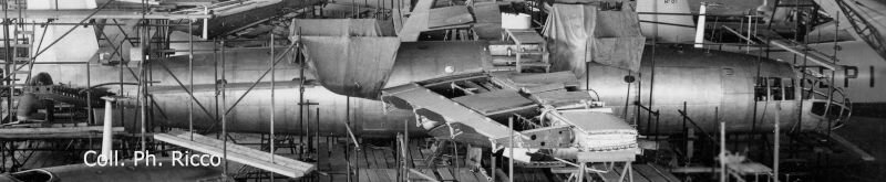

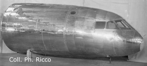

The thing to bear in mind about the SE-1010 is that design commenced in February 1945 (moderators, should this be in "Early Projects" instead?) as a pressurised, Transatlantic high-speed courier & postal aircraft; the SE-1001. The production SE-1011 would have differed considerably too......

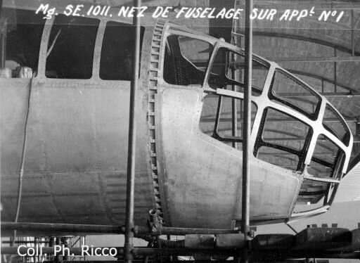

The production SE-1011 aircraft differed in these aspects......
1. Bristol Hercules engines.
2. A taller tail-fin.
3. Twin high-aspect ratio out-rigger tail-fins (this aircraft had a very short tail-moment which probaby led to the loss of the prototype).
4. Conventional ailerons.
5. Longer chord trailing-edge flaps.
6. A differently glazed nose with B-29 (or nazi german bomber) style multiple panels.
Construction of the 3 production SE-1011s was abandoned by the end of 1950. Other planned derivatives were......

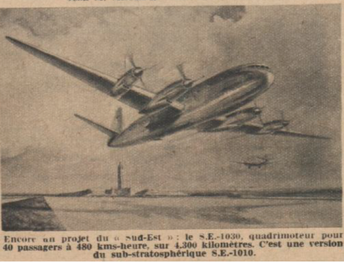

SE-1015 - Long-range 18 seater courier airliner with SNECMA 14R 28/29 engines and a perhaps slightly larger diameter fuselage.
SE-1020 - Maritime patrol aircraft with Jumo 213 engines and gun turrets.
SE-1030 & SE-1035 - High Speed Stratospheric airliners from 1947 with a more conventional larger diameter airliner fuselage design.
SE-1040 - Turboprop test-bed to evlaluate the Rolls-Royce Dart engine.

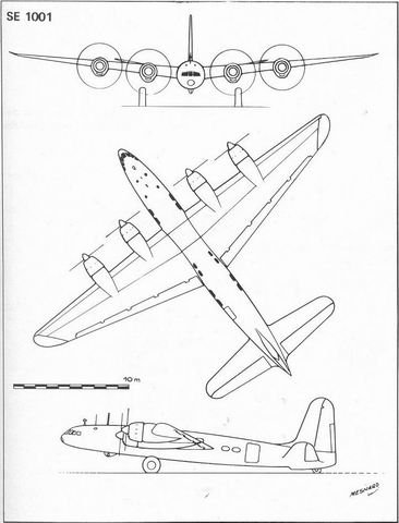

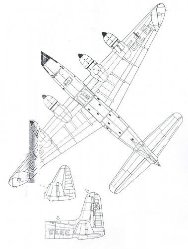

Very useful information! Is there any 3 view plan of SE-1011?
What was the real reason to construct SE-1011?
Seems to be to late for piston engine powered planes to be lucky.
Great rise of the jets was able to make any older design dead before born.
Jemiba
ACCESS: Above Top Secret
Mar 11, 2006
8,314
1,379

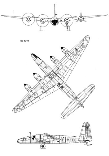

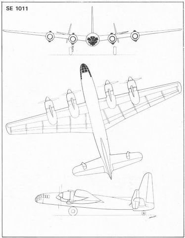

Two 3-views of the SE.1001 and the 1011 made by Joel Mesnard, I've got via the aeroforum:

Thanks Jemiba for the 2 three-view drawings from August 1987 issue of Fana de l'Aviation......

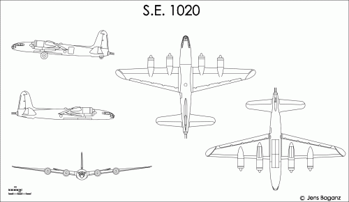

Well, I'm thankful for those designs, too ! ;)
Thank you, Terry, for giving the exact source, from the scans I've got, it wasn't
recognisable. Based on Cunys "Les Avions De Combat Francais" I've made a drawing
of the 1020, quite a long time ago, sorry for the quality.

Dear Terry (Caravellarella), is there anything you don't know about french aviation? ;)
Anyway, thank you all for good additions on the subject!
Dear Jemiba, your drawing is very nice ;)

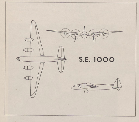

Hello, my dear fans of french secret projects!!
I am going to ask you one question about another SNCASE "secret" project. I don't want to start a new topic. Working with french sources, i am found some words about SNCASE SE-1000, the four-engined plane.
According to Flight, it was a project of mid-wing monoplane with wing span of 99 ft., powered with four Gnome-Rhones engines and with estimated sped of about 350 mph at 29,000 ft.
There were 4 versions of the aircraft:
1) high sped high altitude courier;
2) long range version for 4 passengers;
3) another version for 8 passengers;
4) yet another for 10 passengers for continental operations.
So my question is very simple ( ;)): does anybody have any 3-view drawing of it or, maybe, side view??
And some more information about it will be desirable.
Thanks a lot in advance!
Caravellarella
Nov 30, 2007
1,039
237
Dear Flying-Finn, the SE-1000 you mention is in fact the SE-1001 illustrated earlier in this correspondence......
flying-finn
ACCESS: Confidential
Mar 13, 2010
66
12
Dear Terry (Caravellarella), thank you for explanation!! All things seems to be more or less clear now ;)

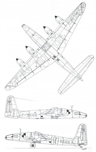

Let me ask you about your words "...I've seen of the SE-1010 under construction show the equally useless SE-200 flying boat in the background..." Is it real for all of us to see that beautiful photos?? I'll be very thankful to you for them!
May 26, 2006
28,125
5,638

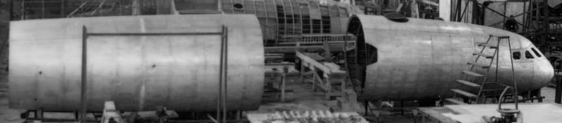

From Le Fana 213.

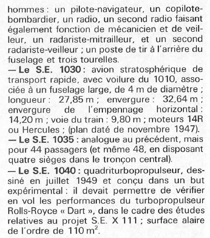

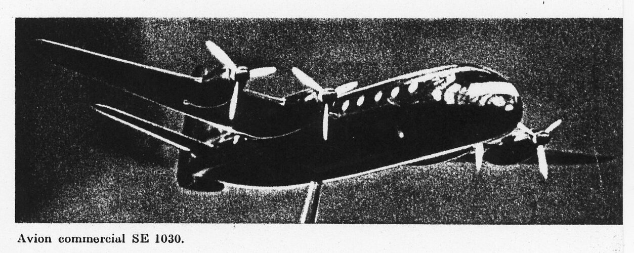

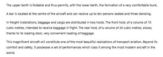

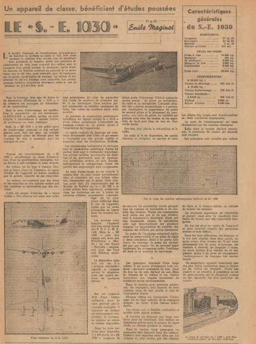

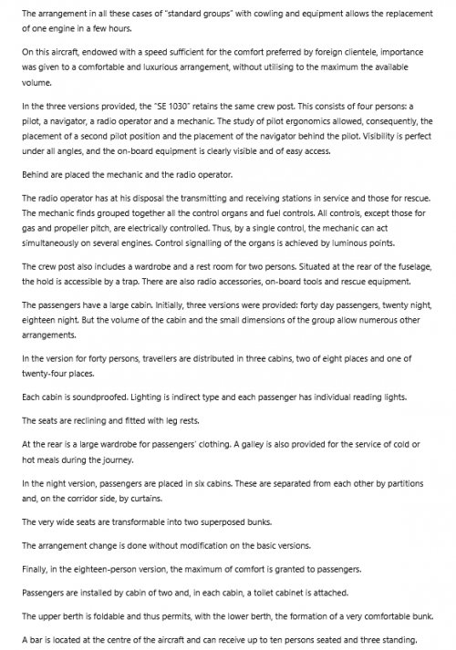

From Decollage 12/1946,
the SNCASE SE.1030 artist drawing.
